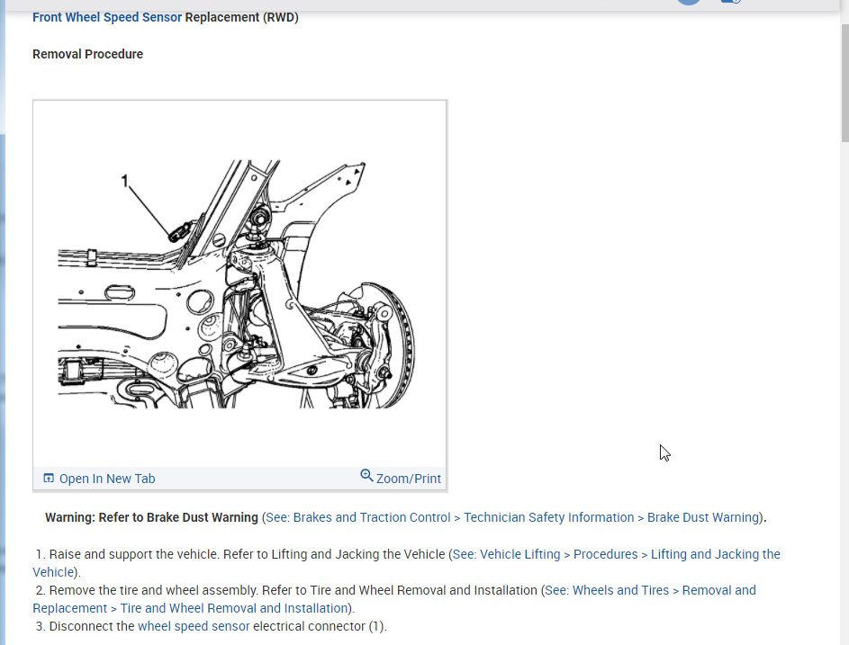

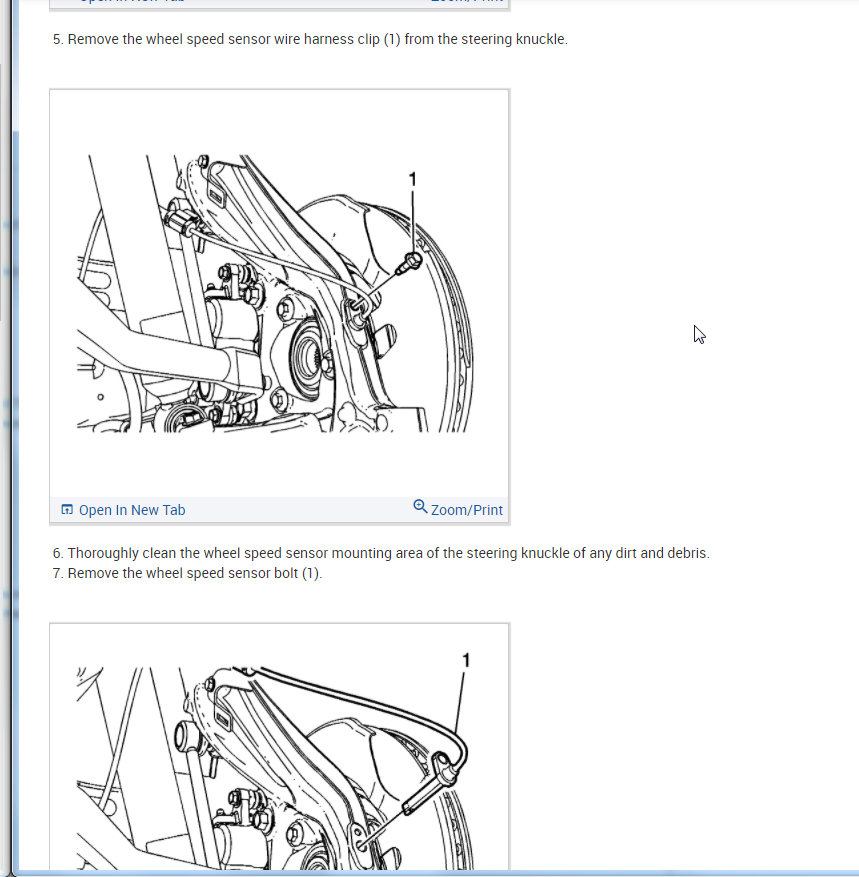

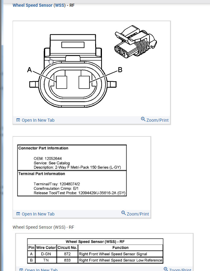

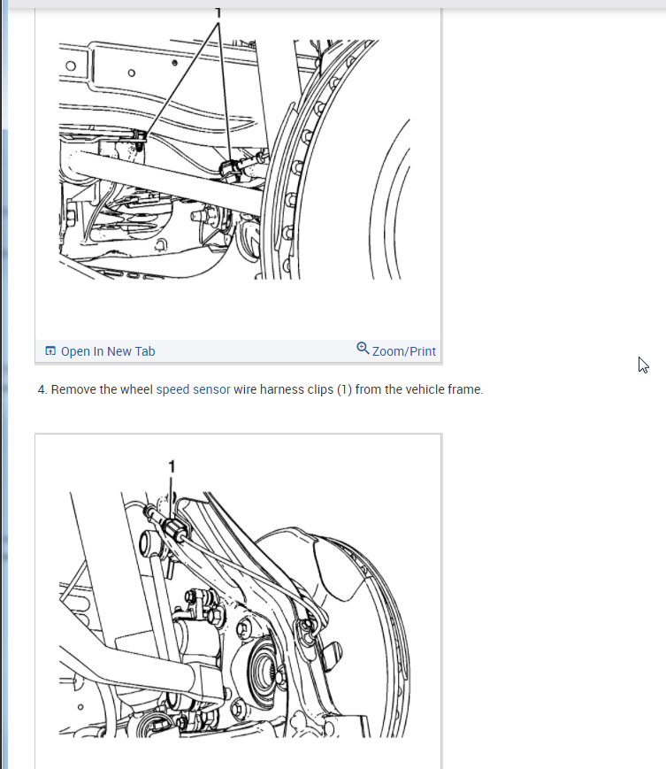

When I am going slow, or turning into a parking space. I put lightly on the brakes, I hear a little motor come on and the brake pedal pulsates and I have NO brakes. I have to slam it to keep from running into another car. Can you please tell me how to replace the right front wheel speed sensor?
May 18, 2009 at 10:29 AM
Here are some guides that will help with this:
https://www.2carpros.com/articles/abs-wheel-speed-sensor-test
https://www.2carpros.com/articles/how-to-replace-an-abs-wheel-speed-sensor

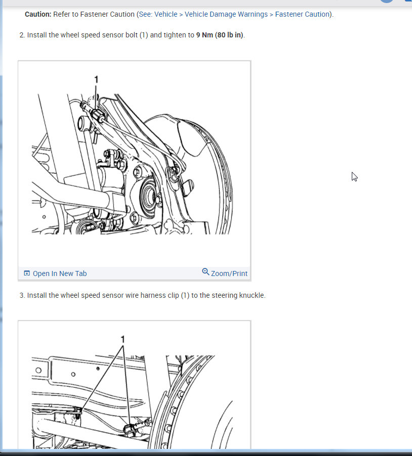

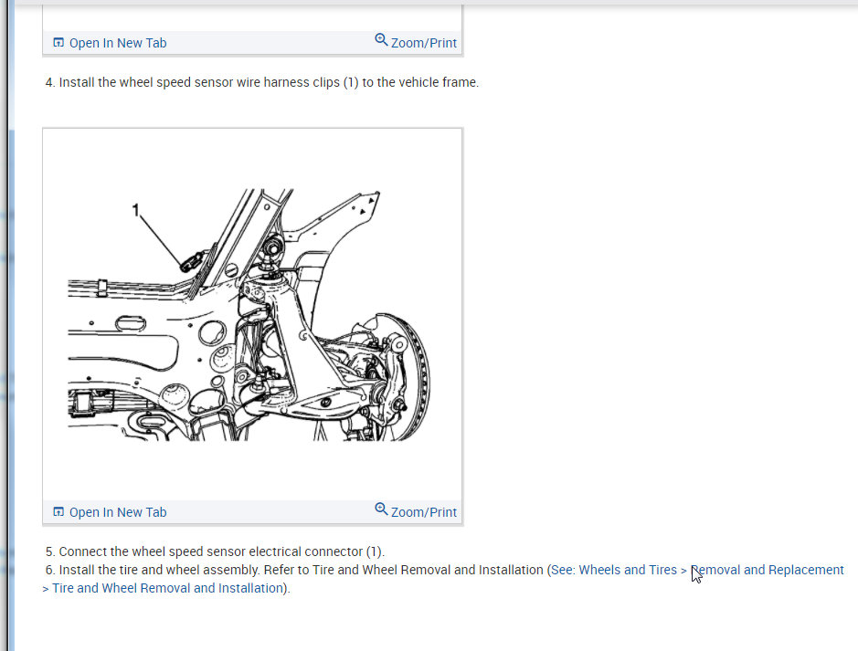

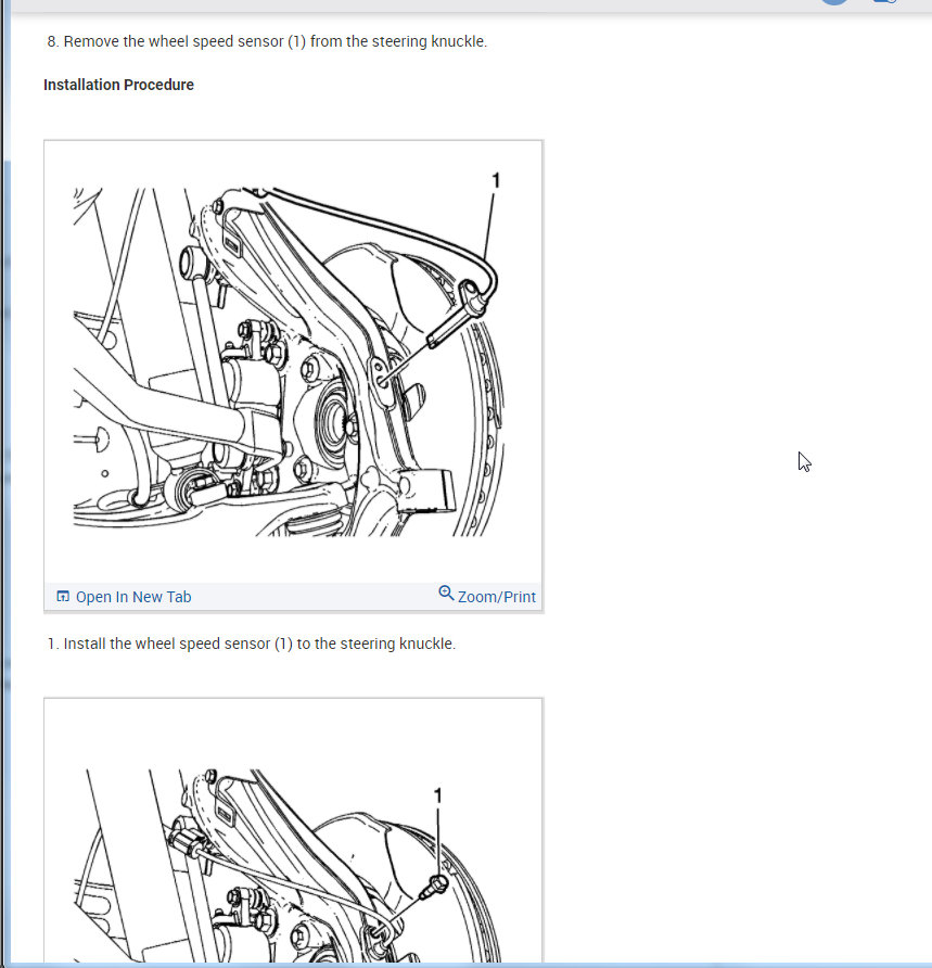

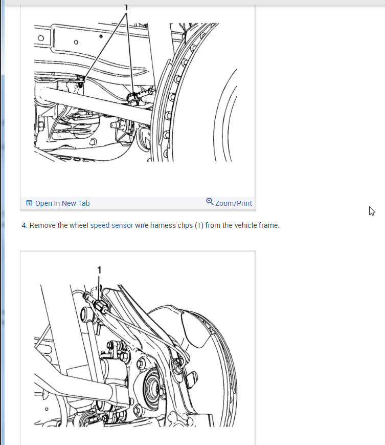

Plus here is the process from the manual on how to replace this sensor.
Please run through this material and let us know if you have other questions. Thanks
