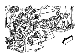

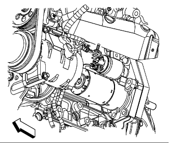

How do I replace the starter and where is it located also.
Thanks ;)
Aug 7, 2010 at 2:41 PM
  • 75,988 POSTS

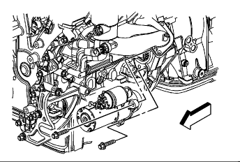

Hi hlevy912,Welcome to 2carpros You will need to jack the car up https://www.2carpros.com/articles/jack-up-and-lift-your-car-safely and disconnect the battery, here is a general guide that will show you how along with the manual diagrams (below). https://www.2carpros.com/articles/how-to-replace-a-starter-motor 2004 Cadillac CTS V6-3.6L VIN 7 STARTER MOTOR REPLACEMENT 1.Turn the ignition OFF. 2.Disconnect the battery negative cable.
https://images.2carpros.com/forum/automotive_pictures/12900_s1_7.gif

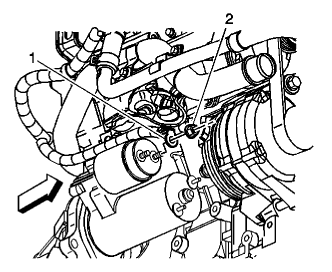

3.Remove the starter solenoid electrical connector from the starter.
https://images.2carpros.com/forum/automotive_pictures/12900_s2_6.gif

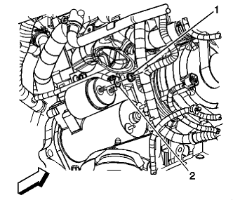

4.Remove the starter terminal nut (1) and the battery positive cable (2) from the starter.
https://images.2carpros.com/forum/automotive_pictures/12900_s3_3.gif
5.Remove the starter motor bolts. 6.Remove the starter motor. Please let us know if you need anything else to get the problem fixed.
