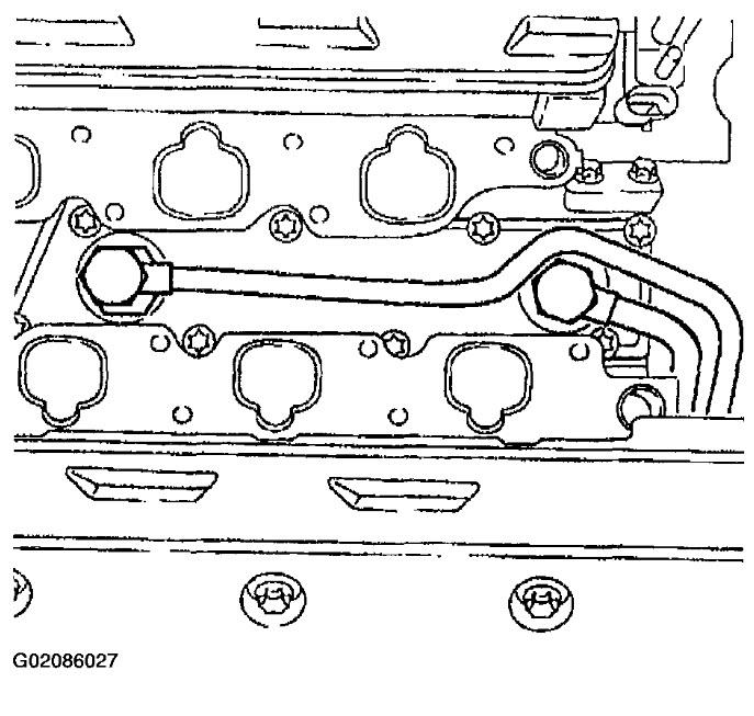

Found oil in coolant reservoir when I thought I had a coolant leak. Leak looks like it came out of overflow tube. No water on dip stick or oil cap. Car did not over heat. Engine sound fine. Oil cooler??? How do I replace???

Sounds like the oil cooler is leaking.It is a bit of an undertaking, the cooler is located under the intake manifold, between the cylinder heads.You have to remove the intake manifold to access it.I strongly suggest getting the updated GM kit that should include all parts necessary to change it, the GM is a bit pricey, but is stronger than original.I also suggest taking care of this ASAP, the oil wiull destroy every rubber coolant hose. Have the cooling system pressure flushed to get all of the oil out

I was just told by the dealer the 3.6L does not have an oil cooler. I have found a lot of problems with the 3.2L online in the location you described. What is your next best guess? Thanks

It's the oil cooler but in this year the oil cooler is located under the intake not in the radiator
