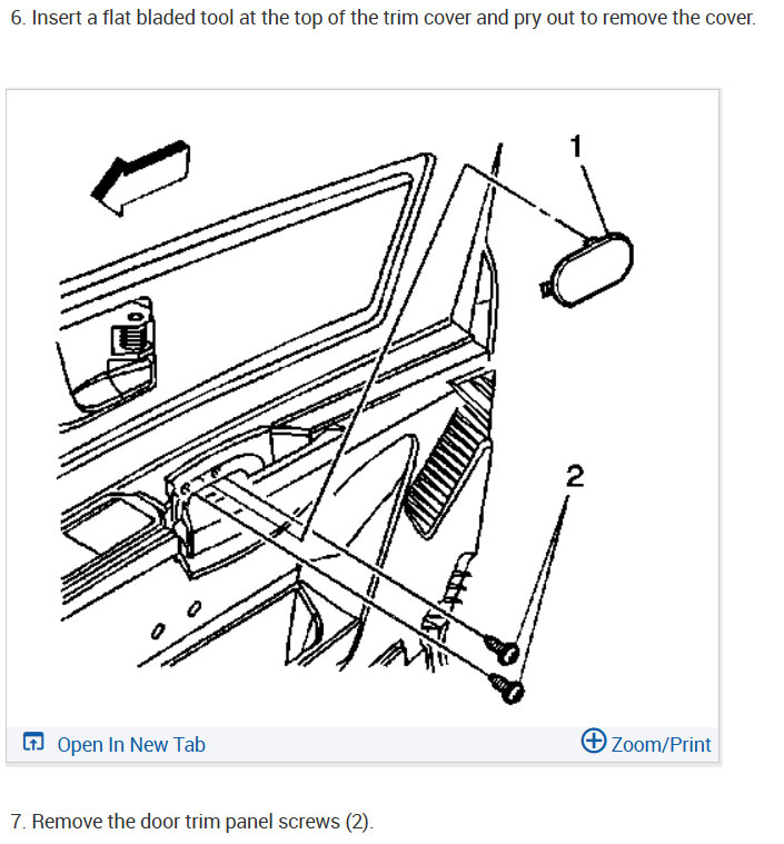

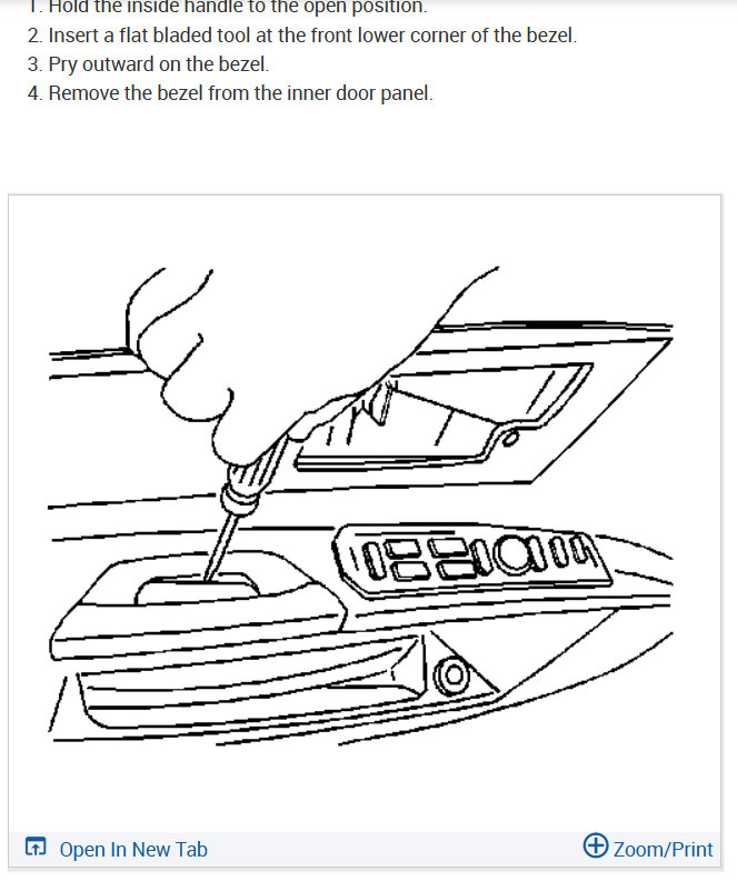

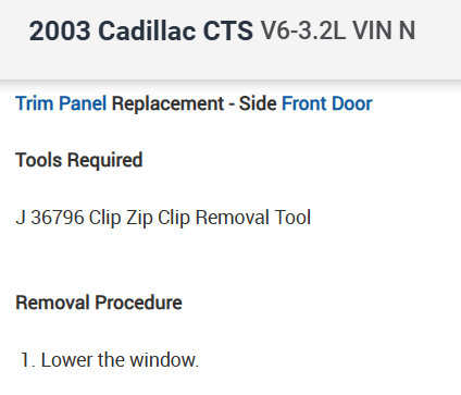

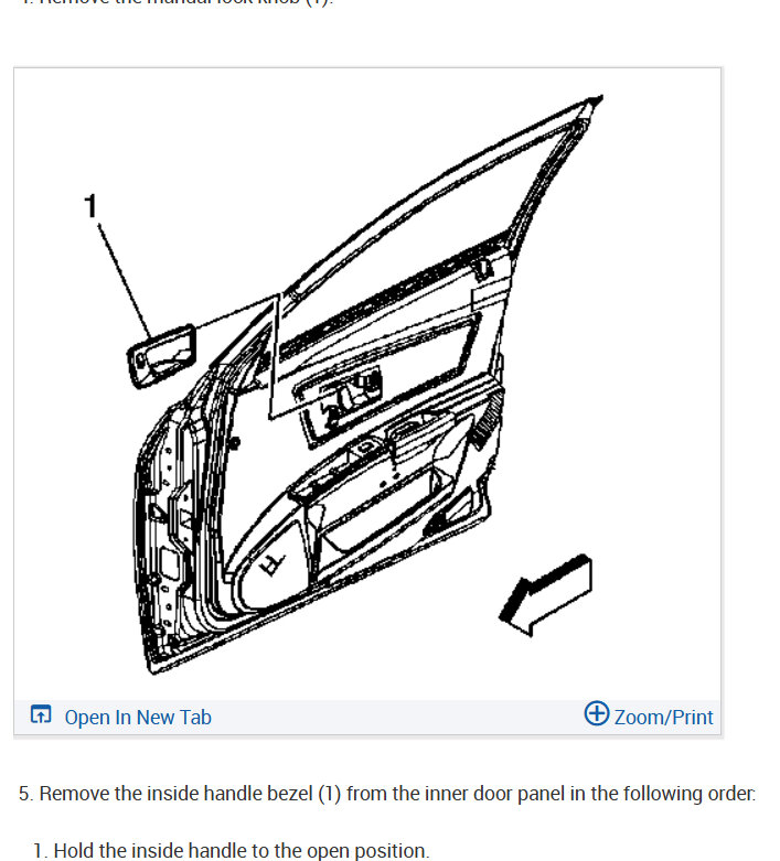

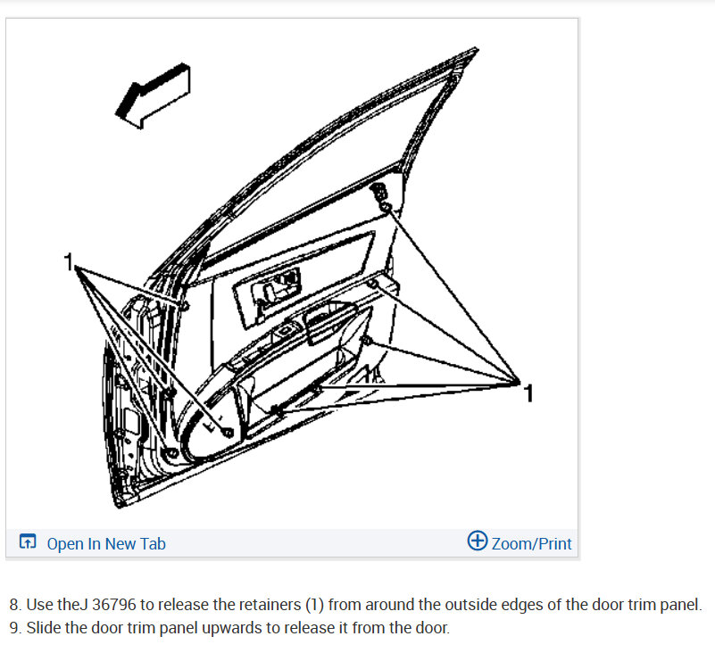

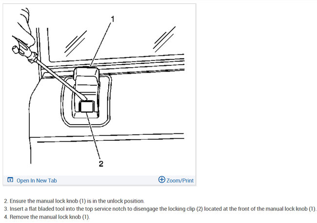

You need to remove the door panel to remove the master window switch. Here is how, check out the images (below). Let us know if you need anything else.
