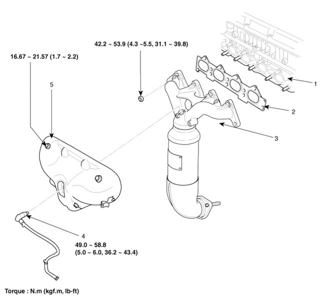

Does my car have two catalytic converters?

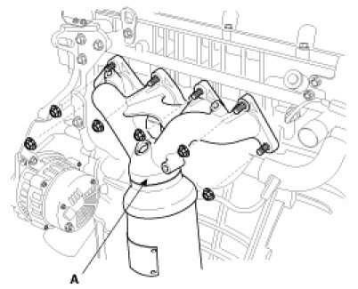

This vehicle has one. It is part of the exhaust manifold. Here are three links that discuss symptoms, how to test one, and how in general one is replaced:
https://www.2carpros.com/articles/catalytic-converter-replacement
_____________________________________
Here are the directions specific to your vehicle. I attached three pics to help you locate and identify the components.
Removal
1. Remove the engine cover.
2. Disconnect the front oxygen sensor connector.
3. Remove the front muffler.
Tightening torque
39.8 - 58.8Nm (4.0 - 6.0kgf.m, 28.9 - 43.4lb-ft)
4. Remove the heat protector.
5. Remove the exhaust manifold and catalytic converter assembly(A).
