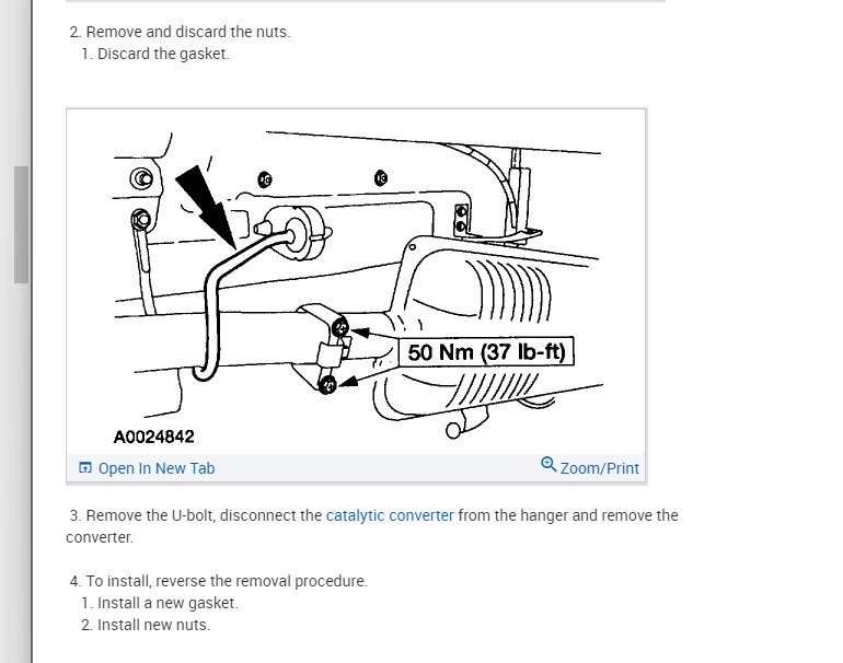

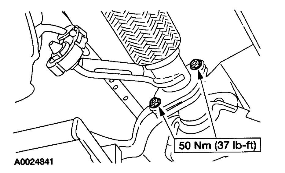

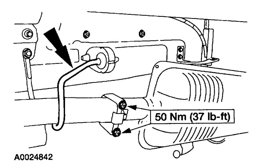

Where is my catalytic converter on my vehicle?
Oct 22, 2018 at 4:09 AM
Good afternoon.
It is right off the exhaust manifold. I attached two pictures for you to view. Check out the diagrams (Below). Please let us know what happens.

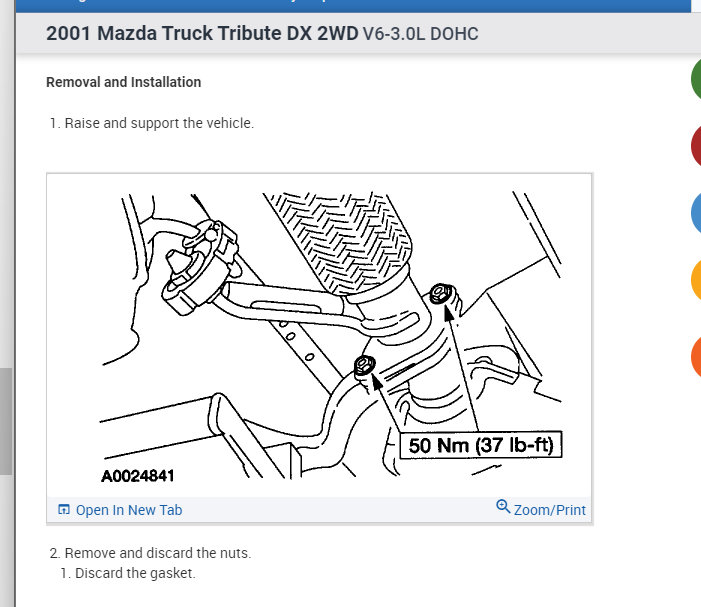

In addition to this info, I am attaching the process on how to replace it.
Also, here is a guide on how to test the converter:
https://youtu.be/kNXh1Lphzr4
Please see the info below and let me know what questions you have.
