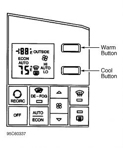

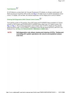

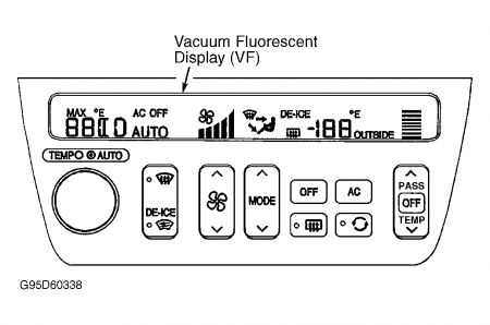

How do I access the on-board diagnostic codes. There is no "warmer" button on my climate control panel so I can't hold down the "OFF" and "WARMER" buttons.

Hello I have attached the information. I hope this is what you are looking for.
