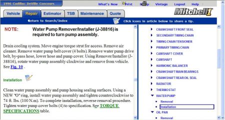

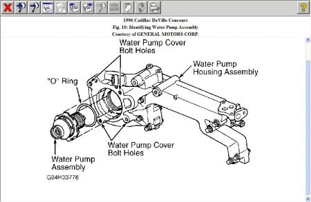

DESCOVERED IT WAS THE WATER PUMP BELT BROKEN. HOW DO I REPLACE IT? DO THE WATER PUMP OR PULLIES HAVE TO COME OFF?

See below
https://images.2carpros.com/forum/automotive_pictures/12900_water_pump_5.jpg
https://images.2carpros.com/forum/automotive_pictures/12900_water_pump_devile_1.jpg

the belt only requires a 13 mm wrench, put it on the pully bolt may have to take off the black protector bracket, but ck the water pump and see if it is seazed up
