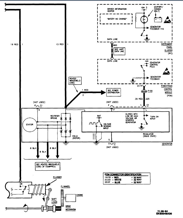

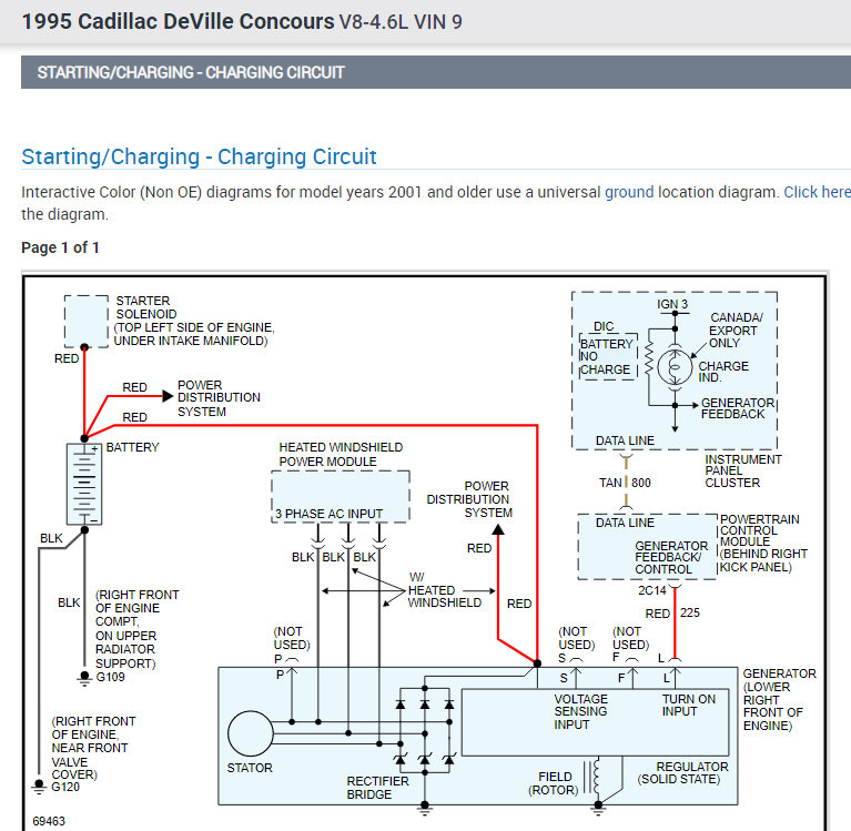

The "Battery No Charge" message sporadically shows on the information panel, and then goes away, what items should I check?
Thursday, June 10th, 2010 AT 9:19 AM
2 Replies
SQM
  • 6,383 POSTS
This could be due to a loose connection or carrion to the battery terminal or the alternator cable. It can also be due to a bad wiring (possibly a bad ground) for the battery warning light.
First check all the cables that connect from the battery to the alternator. Look for any loose connection or corrosion. It could be a good idea to clean the contacts.
I have included the wiring schematics for our reference.
