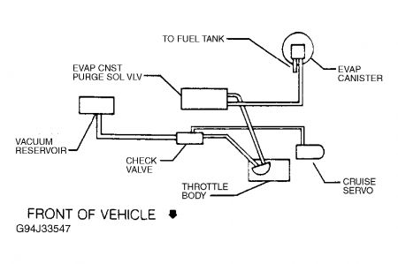

need diagram how to route vaccom hoes
Apr 18, 2010 at 6:12 PM
BLUELIGHTNIN6
  • 16,542 POSTS
4.6L engines
https://images.2carpros.com/forum/automotive_pictures/261618_46_1.jpg

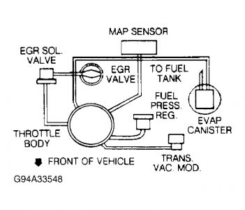

4.9L engines
https://images.2carpros.com/forum/automotive_pictures/261618_49_2.jpg
