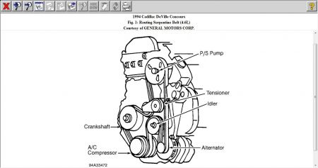

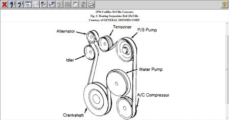

ive looked on your forums for a belt pattern on this car and the one that is posted isnt the right pattern for this car on my car the power steering is on top on the bottom rear is the crank next to it is the air conditioning then above that is the altenator beside alternator is the idler pulley and the tensioner i cant find a belt pattern for this car no where could you please help
Sep 20, 2009 at 11:06 PM
  • 75,992 POSTS
2 V8's Pick your choice and Good Luck 4.6L
https://images.2carpros.com/forum/automotive_pictures/12900_46_liter_1.jpg
4.9L
https://images.2carpros.com/forum/automotive_pictures/12900_49_deville_and_seville_1.jpg
