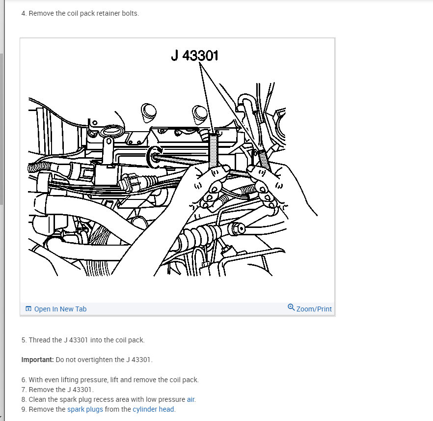

where are the spark plug wires located . i cant seem to find them
Nov 27, 2009 at 8:50 AM

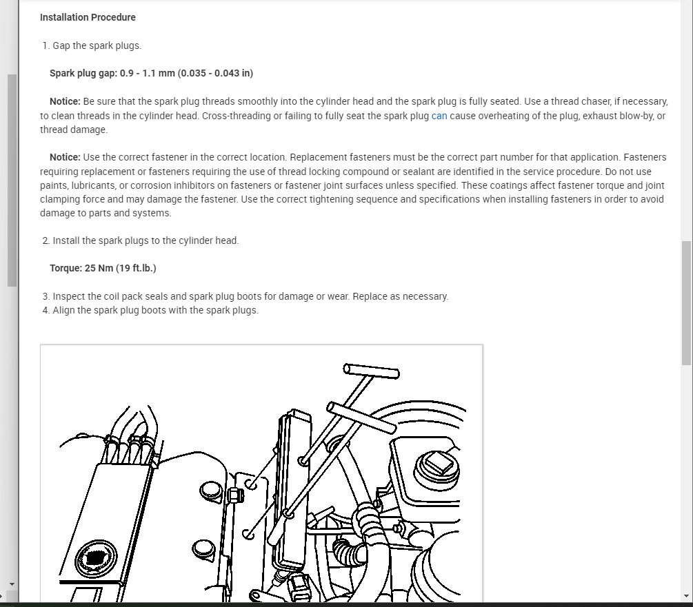

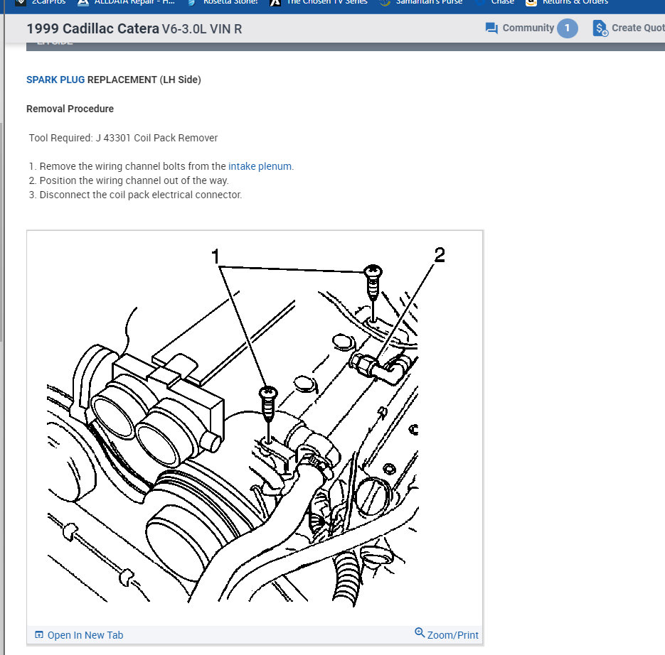

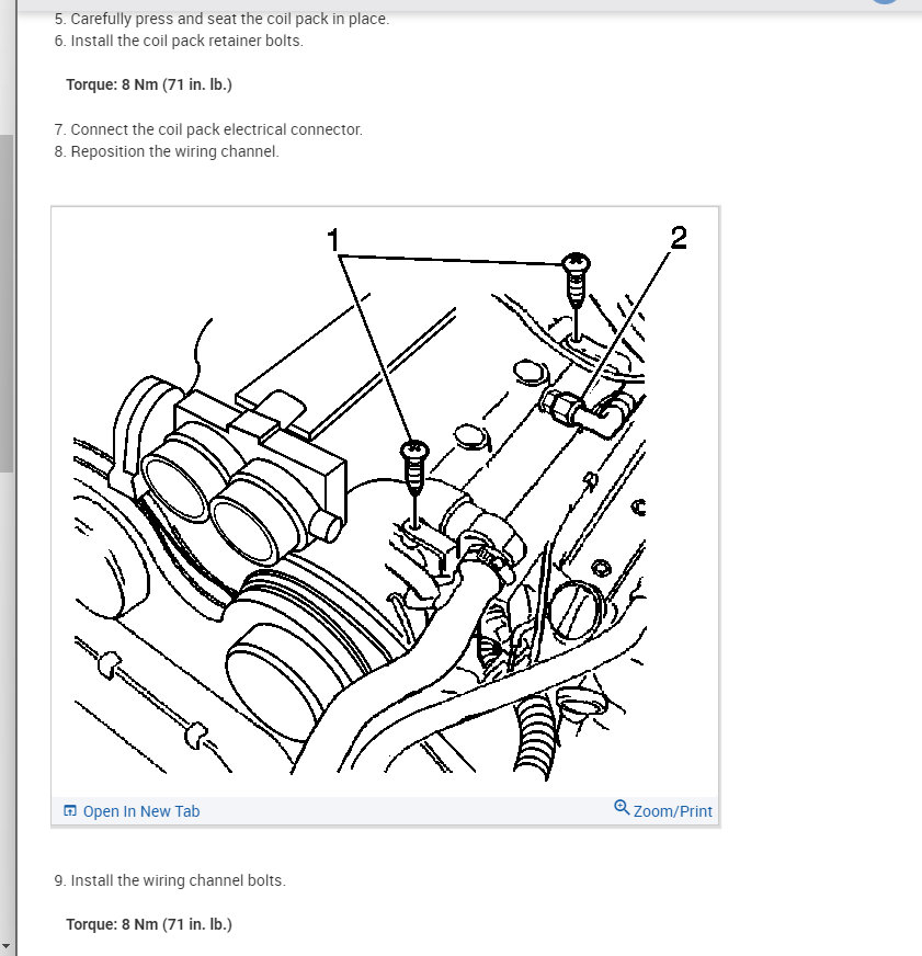

This engine does not have spark plug wires.
This engine has what is called a coil pack but not a traditional coil pack. This is a coil pack that is on top of the plugs. So, this is a combination between the coil pack and coil on plug.
https://www.2carpros.com/articles/how-to-tune-up-a-car-engine
So, I am attaching the info below which will help with this. Please run through this and let me know what questions you have.
