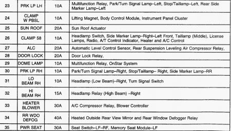

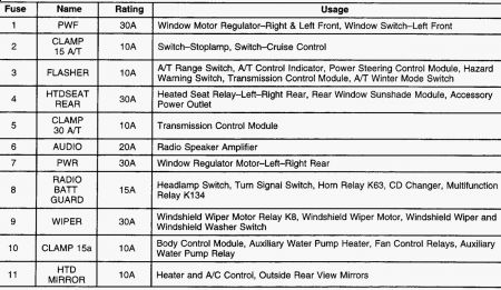

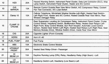

fuses got mixed up. i just need to know what amperage to put back in correct slot 1--32
