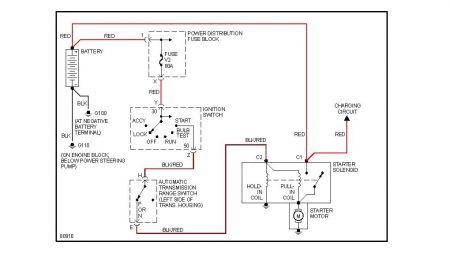

I have a 1997 cadillac catera and one night I went to go start the car and it would not even crank, it was silent. The battery was full charge.I can start the car with a screwdriver by touching the solenoid.
Sunday, July 13th, 2008 AT 6:22 PM
  • 75,992 POSTS
Could bethe ignition switch or the transmission range switch-see below starter EWD
https://www.2carpros.com/forum/automotive_pictures/12900_solenoid_1.jpg
