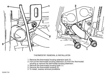

How do I replace the thermostat.Thank you,Ken Burris

Ken: Just follow the upper rad hose toward the engine and you'll come to the t-stat housing. Drain the radiator, remove the upper hose, remove the housing and you'll see the t-stat. Reverse the sequence to replace it. I up loaded a picture of the housing for you. I hope it helps.
https://images.2carpros.com/forum/automotive_pictures/249084_Graphic_3.jpg
If you have any other questions, let me know. Joe
