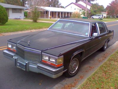

my lwft turning signals do not work they come on but they dont flash but my right turning signals they flash but they are really sluggish someone tell me whats going on if you need anymore information i can give it to you probably [img:00ede82dc6]http://www.2carpros.com/forum/automotive_pictures/267926_110708_1133_1.jpg[/img:00ede82dc6]

Either you have a bulb burned out or the flasher is bad. Do the emerg flashers work?

yeah man i got it fixed all it was was a bulb i thought all my lights were working then i looked in my rearview mirror and noticed the interior light not coming on telling me i had a brake light now still i do know i need to replace that flasher unit cause they are still real sluggish but so far so good got a small exhaust leak between my manifold and block i believe bad gasket i can do it just a matter of getting to it
