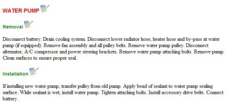

i want to know how to put a new water pump in

https://images.2carpros.com/forum/automotive_pictures/261618_Noname_1805.jpg
