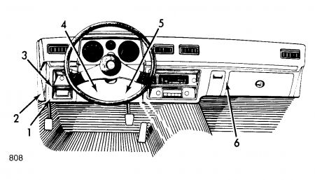

both signals and emergency flashers stopped working at same time. new switches were put in a week before. they operated fine for about a week. then the drivers side front lower ball joint gave way and broke. which made suspension in front left drop down. mechanic shop locally replaced ball joint. by the time I got car home 20 miles,those lights quit working. I'm wondering what might have happened and how to fix it. thanks much. Barry

Check both flasher FUSE BLOCK & FLASHER LOCATIONS (1) ApplicationLocation Brougham, Eldorado & Seville Fuse Block(2) Near Parking Brake Hazard Flasher On Fuse Block Turn Signal Flasher(5) Right of Steering Column
https://images.2carpros.com/forum/automotive_pictures/12900_flashers_1.jpg
