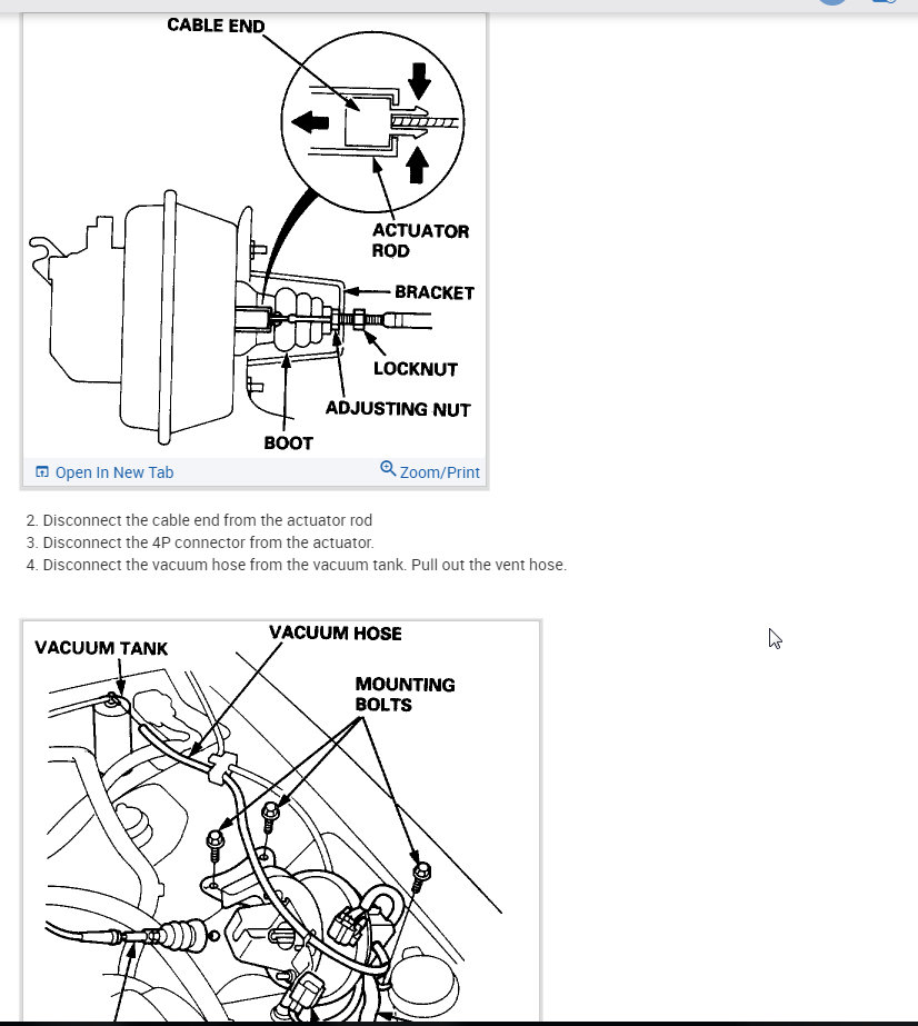

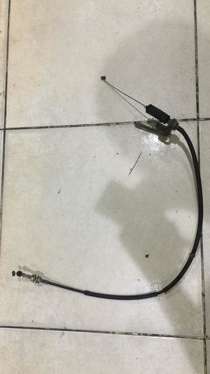

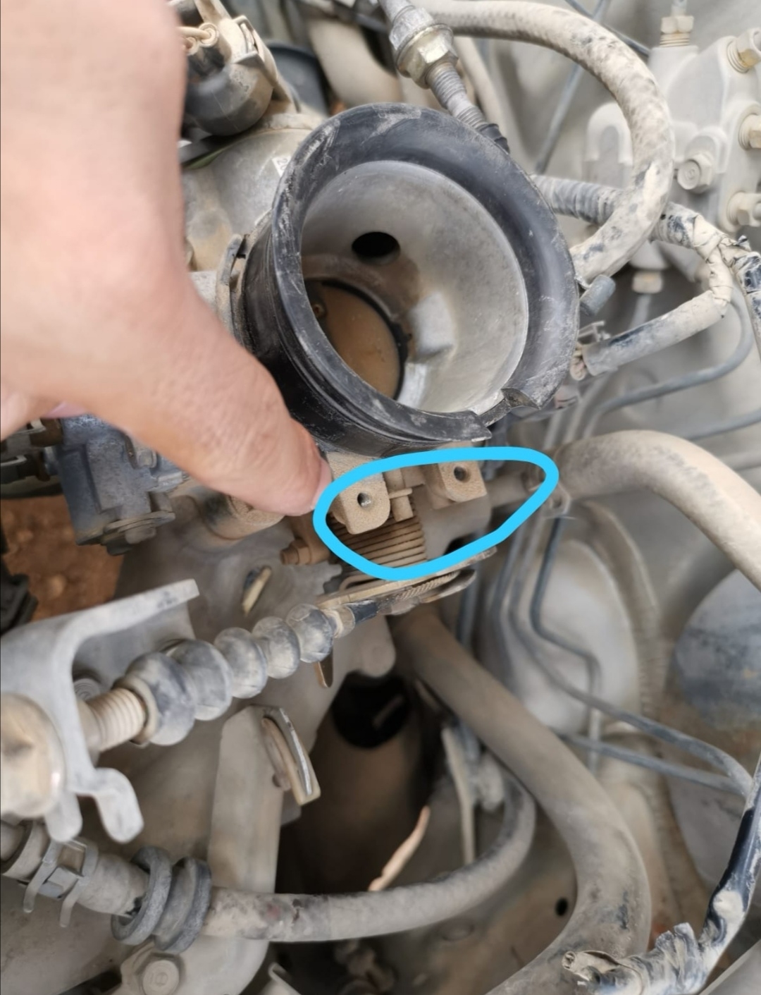

I replace the transmission, after that the person who replace it to me. Told me i have to find the missing cable to fix the shifting problem i will add the picture for the cable.
I want picture for how to attach the cable and what the parts name.

LORDSTATION
I want to know what the name for the parts and how can i fix this or ask the person to do it? If you have picture.

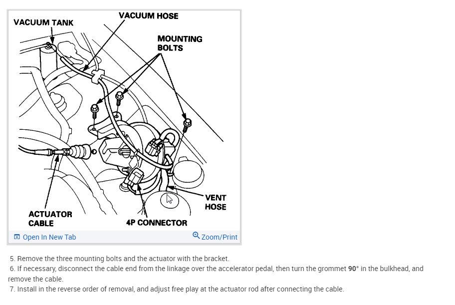

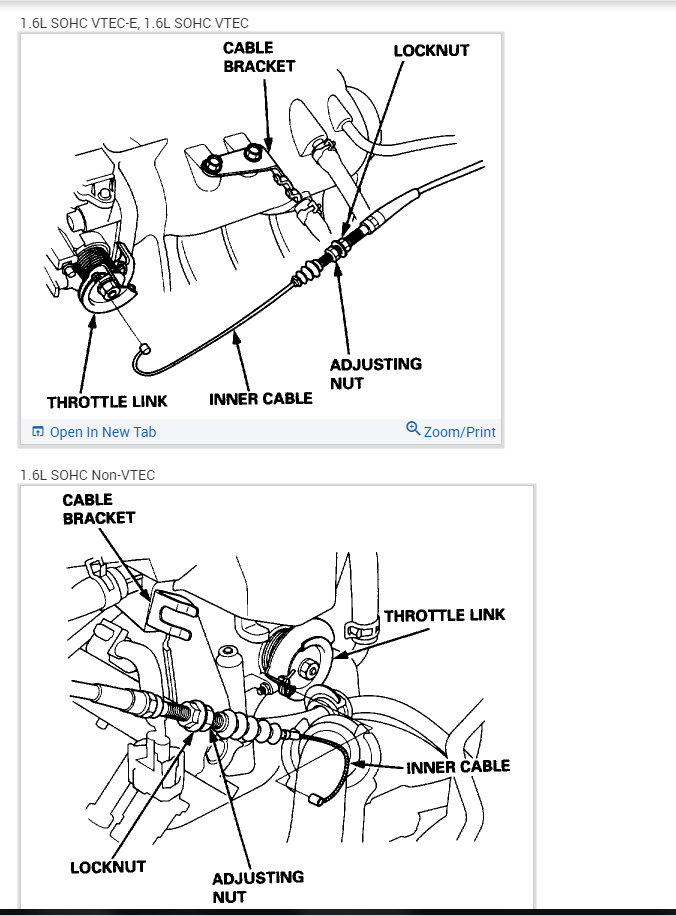

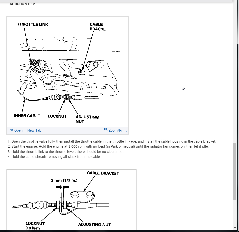

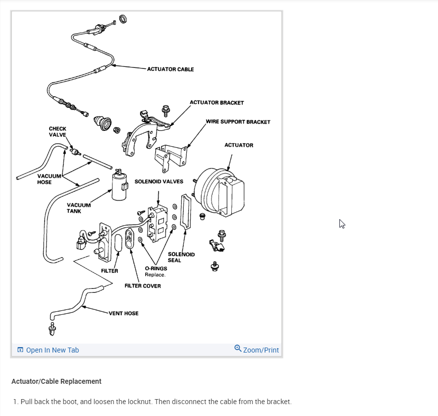

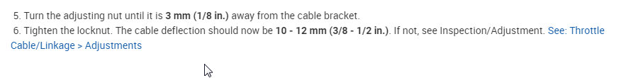

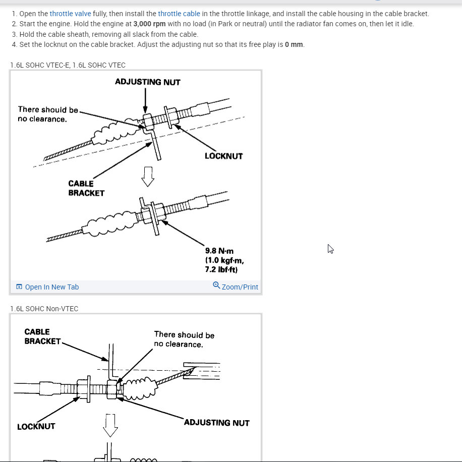

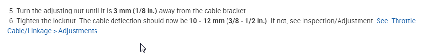

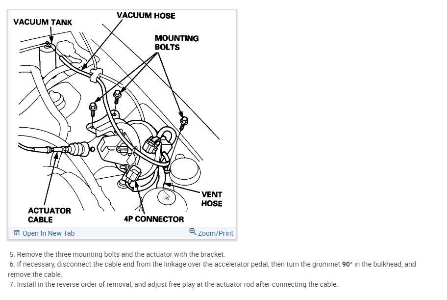

There are only two cables that run to the throttle and those are the throttle cable and the cruise control servo cable. I attached procedures for both. The picture you attached appears to be the length of the cruise control cable but clearly you will need to see which this is based on the length because they will not be the same.
