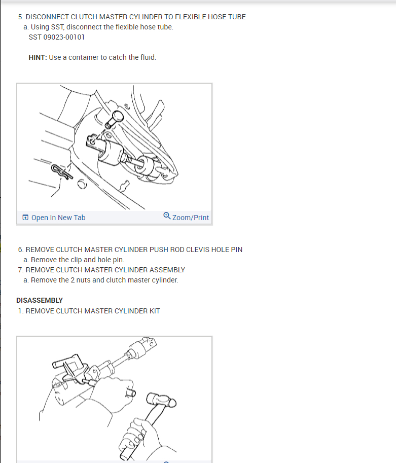

I replaced my clutch master and clutch slave and in the process of that I had to remove other parts to do so and now I can't remember where a certain cable goes. I need help with it
Jun 11, 2021 at 9:38 AM

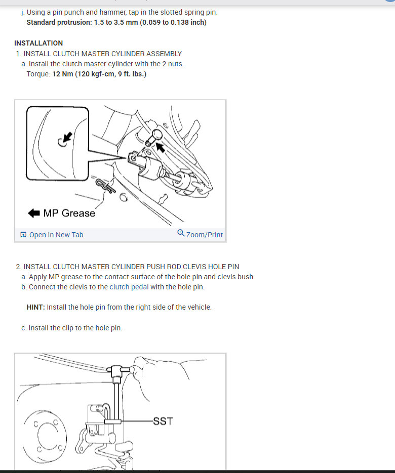

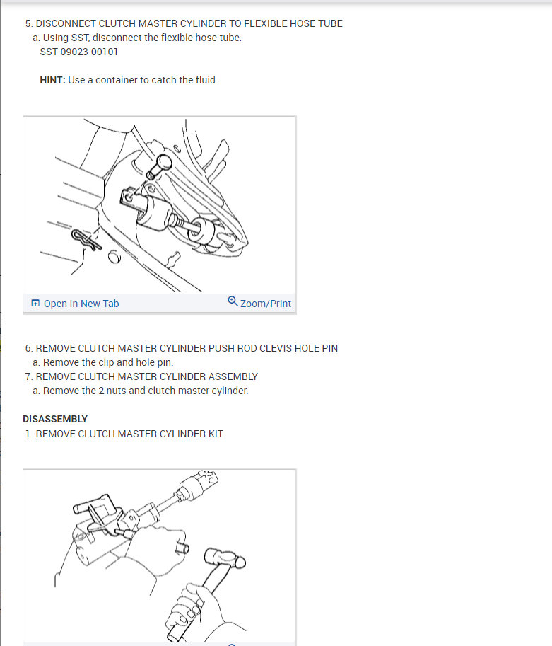

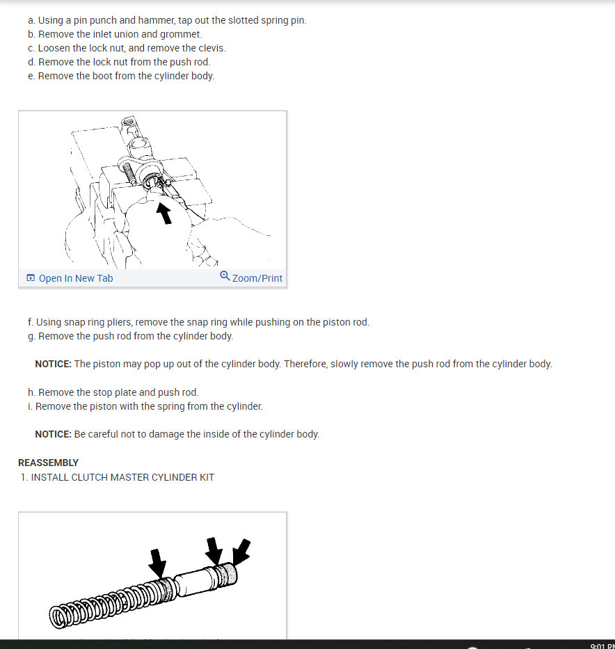

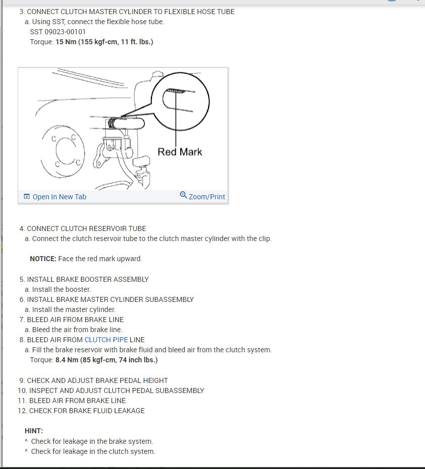

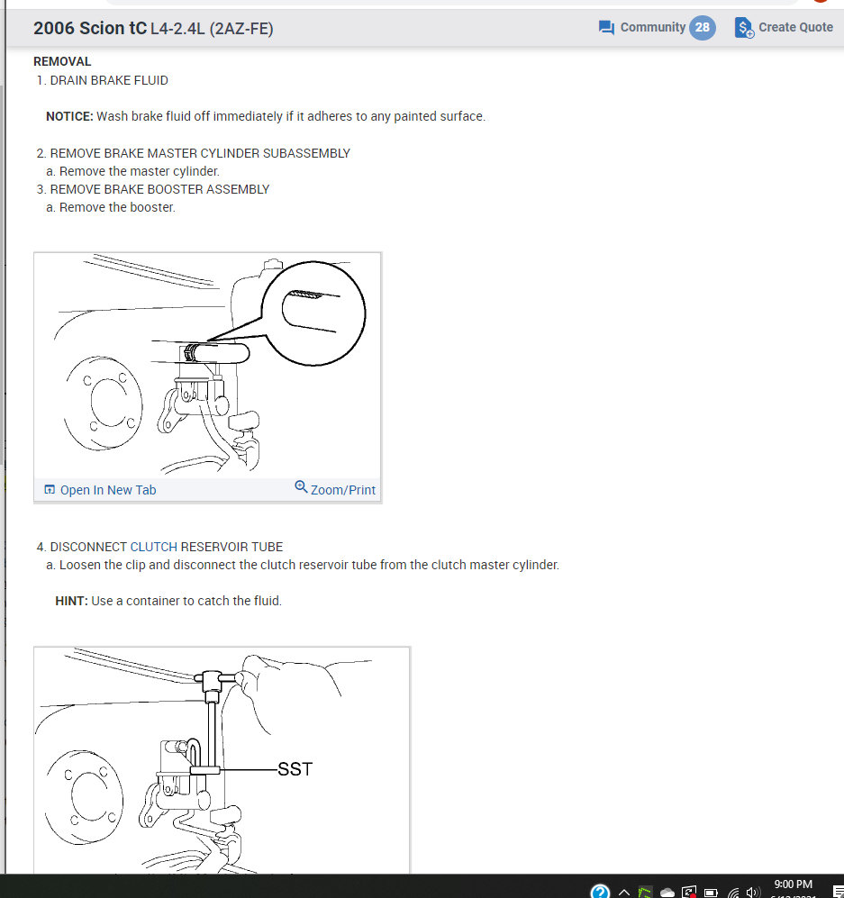

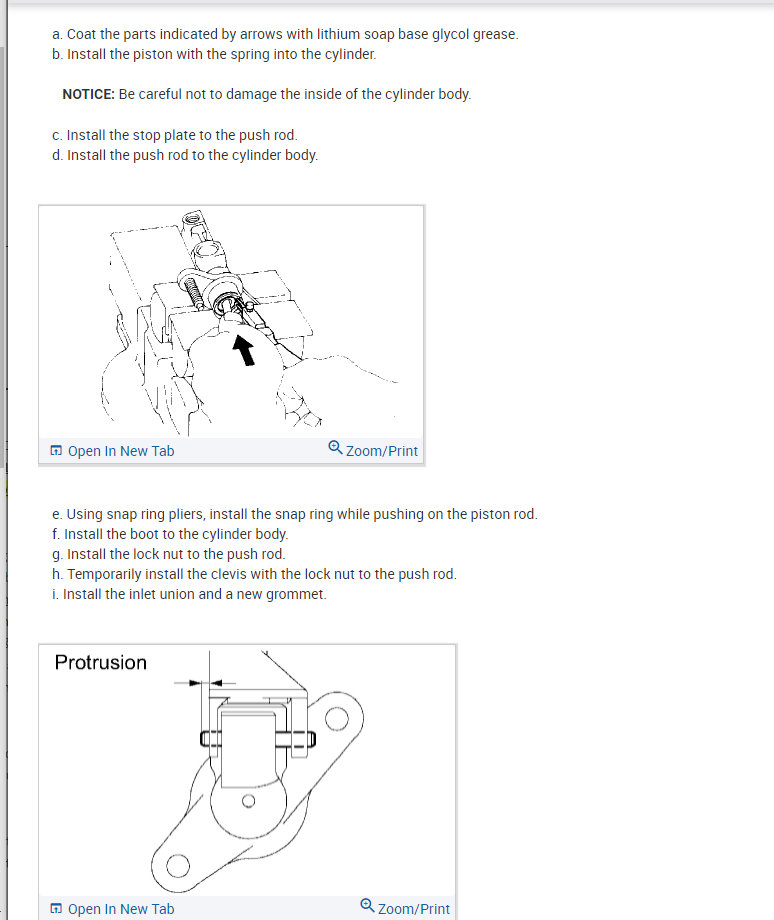

I am not sure which connectors this would be for so we need to start with getting some pictures of them and the general location of where they are located.

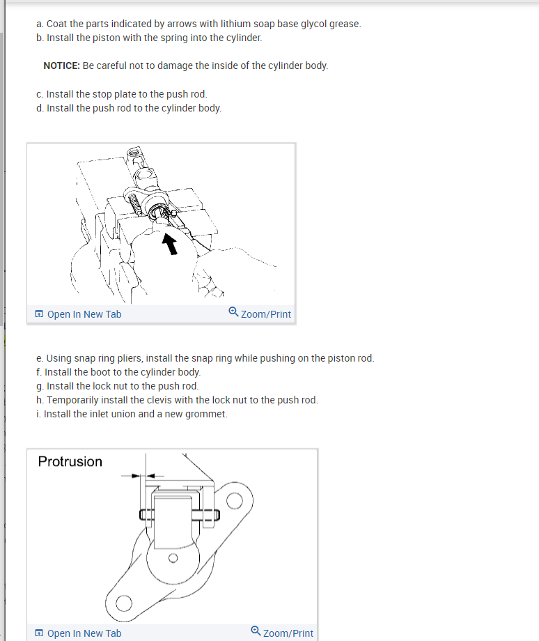

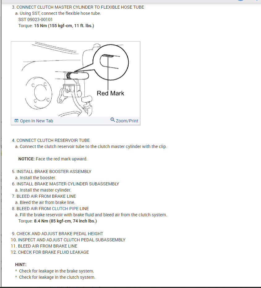

However, I attached the process below for the master so we need to run through that but I am not sure that will give you what you are looking for.
Plus here are some guides that will help with this if others visit this page and need this info:
https://www.2carpros.com/articles/throw-out-bearing-replacement
https://www.2carpros.com/articles/pilot-bearing-replacement
https://www.2carpros.com/articles/clutch-doesnt-work-sometimes-or-not-at-all
Please let us know if you can get some pictures on this and we can go from there. Thanks
