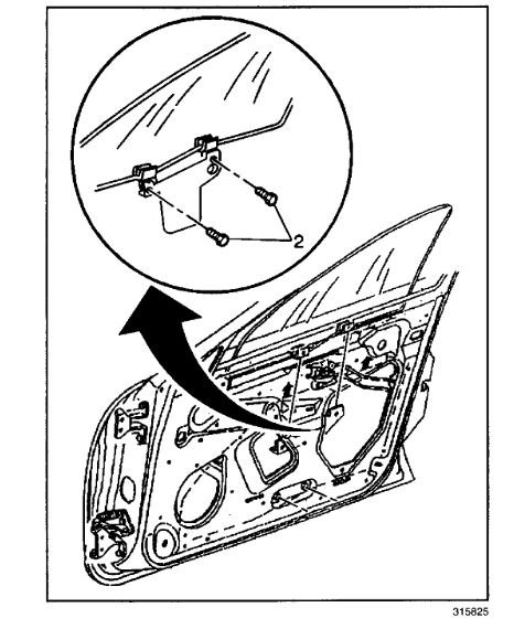

My battery had ran down and I tried to roll up my window and the cable came loose. need help reconnecting it.
Jan 12, 2020 at 4:01 PM
Good morning,
There is no putting it back.

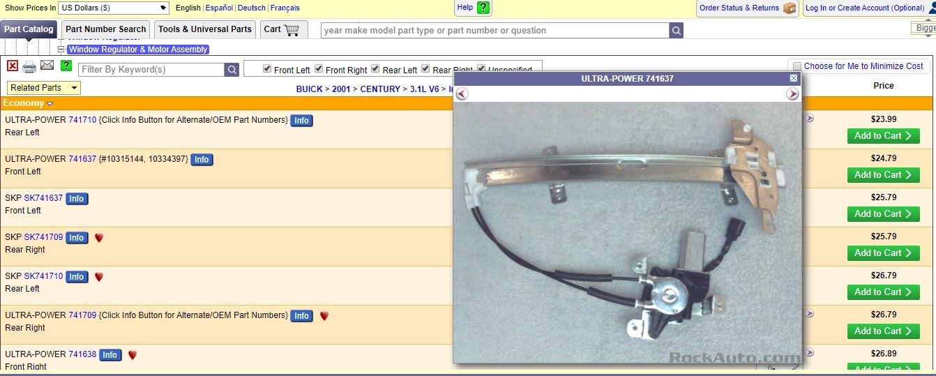

The regulator has to be replaced. There is no repair kit for the cable coming out.
REMOVAL PROCEDURE
1. Remove the trim panel.
2. Remove the water deflector.
3. Raise the window far enough in order to gain access through the door inner panel to the window to regulator bolts (2).
4. Remove the window to regulator bolts.
5. Raise the window to the full up position.
6. Tape the window in the full up position.

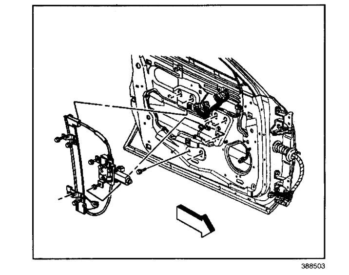

7. Disconnect the electrical connector.
8. Remove the four regulator mounting bolts.
9. Remove the three regulator motor bolts.
10. Remove the regulator from the door.
11. Remove the electrical connector.
12. Remove the regulator from the door.
