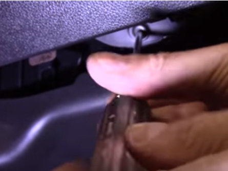

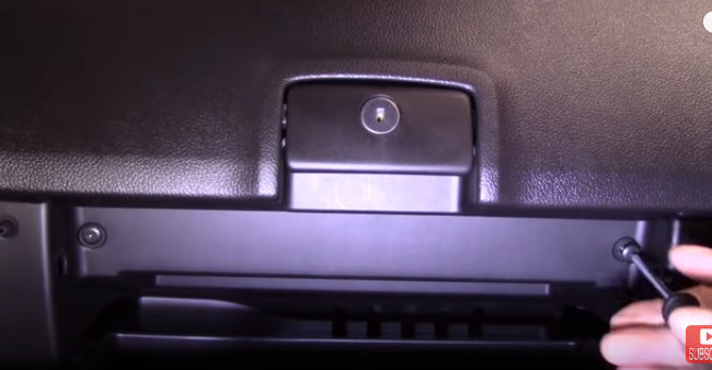

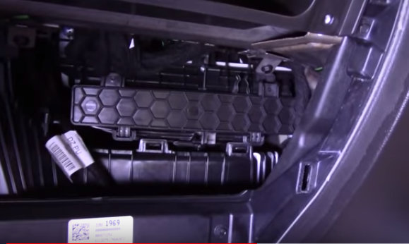

Cannot find cabin filter location. Do all 2013 Sierra have a cabin filter? VIN 1gt120cg3df130073. I have watched several YouTube videos about this and they don t correspond with what I find in my truck.

From what I've seen you will have to remove a total of 4 (T10) screws and the lower glove box door. 2 upper screws and 2 lower screws to access the cabin air filter port. I've attached pictures below.Hope this helps and thanks for using 2CarPros.
