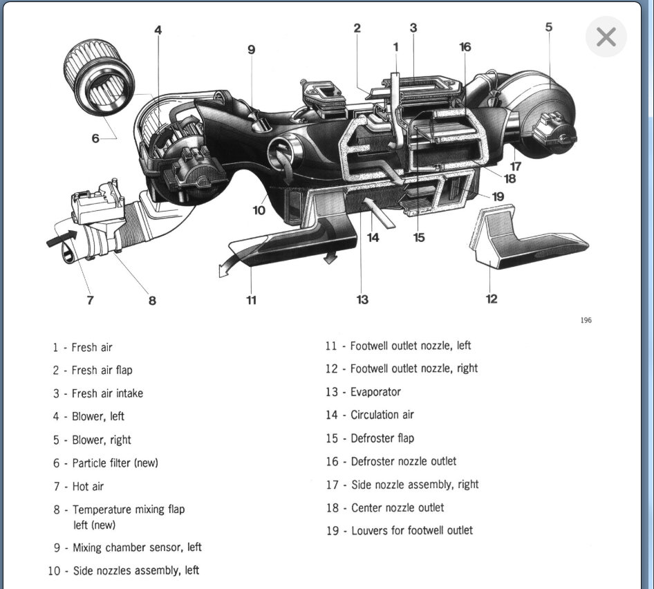

Does my car have a cabin filter
1998 PORSCHE 911
38,000 MILES • 6 CYL • 2WD • MANUAL
DEGLY
I had a mouse build a nest in the engine one year, I had that taken care of but I am still getting some residual smell.
Aug 15, 2020 at 12:41 PM

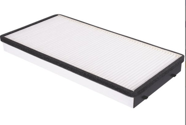

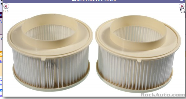

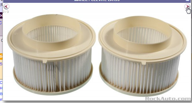

I attached the info on this. It appears there is a filter inside the blower motors. I would check where it shows the fresh air intake as well to see if there is a filter because I am showing a part for a secondary filter (the flat one shown below) but it is not in the manual. Meaning there is one you can buy but the manual doesn't show it so I am not sure it has one.
Let me know if you have questions. Thanks
