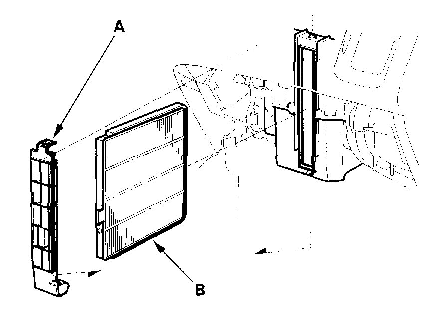

Does the cabin air filter, filter the air flow whether the vehicle's air flow is on recirc or bringing in air from outside of the vehicle
Tuesday, August 21st, 2018 AT 9:30 PM
  • 109,885 POSTS
Hi and thanks for using 2CarPros. Com.
Yes, it is designed to keep dust from entering the cabin regardless of fresh air mode door.
Here are the directions for replacing it in case you need them:

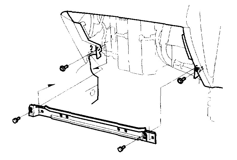

1. Remove the glove box.

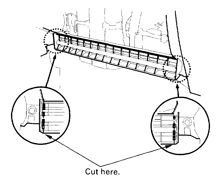

2. Cut the plastic cross brace in the glove box opening with diagonal cutters in the area shown, and discard it.
3. Remove the bolts, the screws and the glove box frame.
4. Remove the filter lid (A) from the evaporator, then pull out the dust and pollen filter (B).
5. Install the filter in the reverse order of removal. Make sure that there is no air leaking out of the evaporator.
