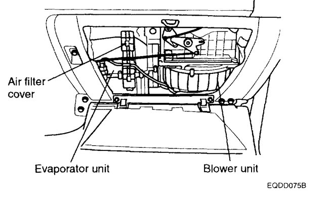

Does anyone know where the cabin air filter is located in the vehicle listed above and how to replace it? I see videos for other years, but not 2003. Any ideas? I think it is most likely behind the glove box, but I just want to be sure and know what to expect. Thanks.
Mar 18, 2020 at 6:52 PM
  • 110,194 POSTS

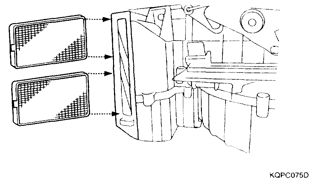

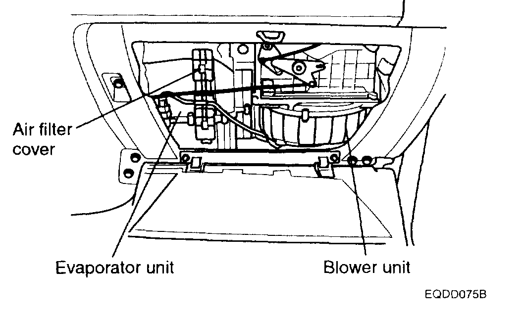

There are actually two that sit side by side. They are behind the glove box in the HVAC box. Here are the directions. The attached pics correlate with the directions.

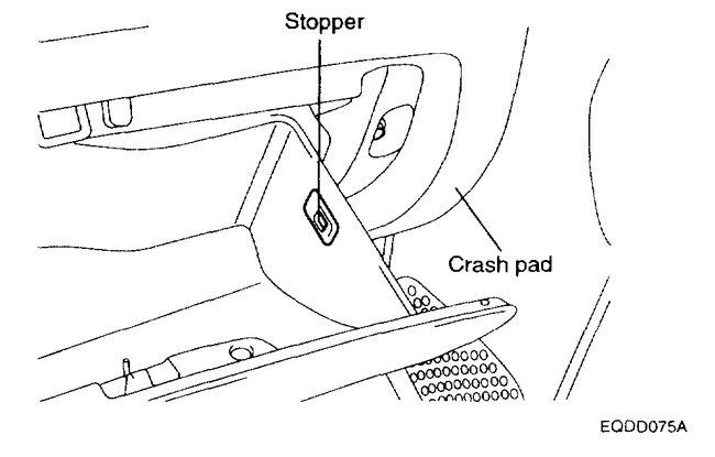

1. Open the glove box, remove the glove box stopper in the lower crash pad (assist seat side), and completely lower the glove box.

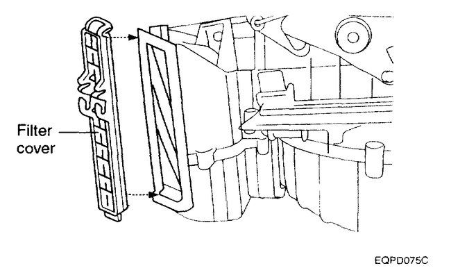

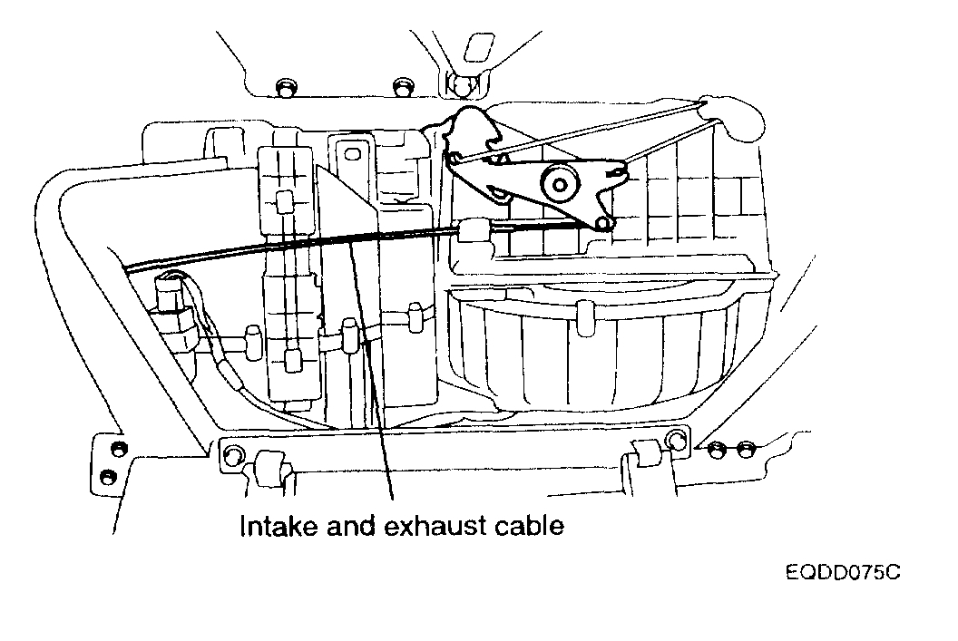

2. Disconnect the intake and exhaust cable from the blower unit.
pic 4

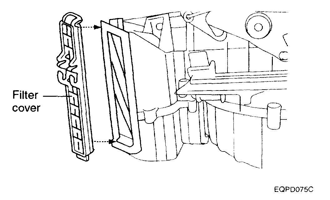

3. Press the hook on the air conditioner side air filter cover and remove the cover.

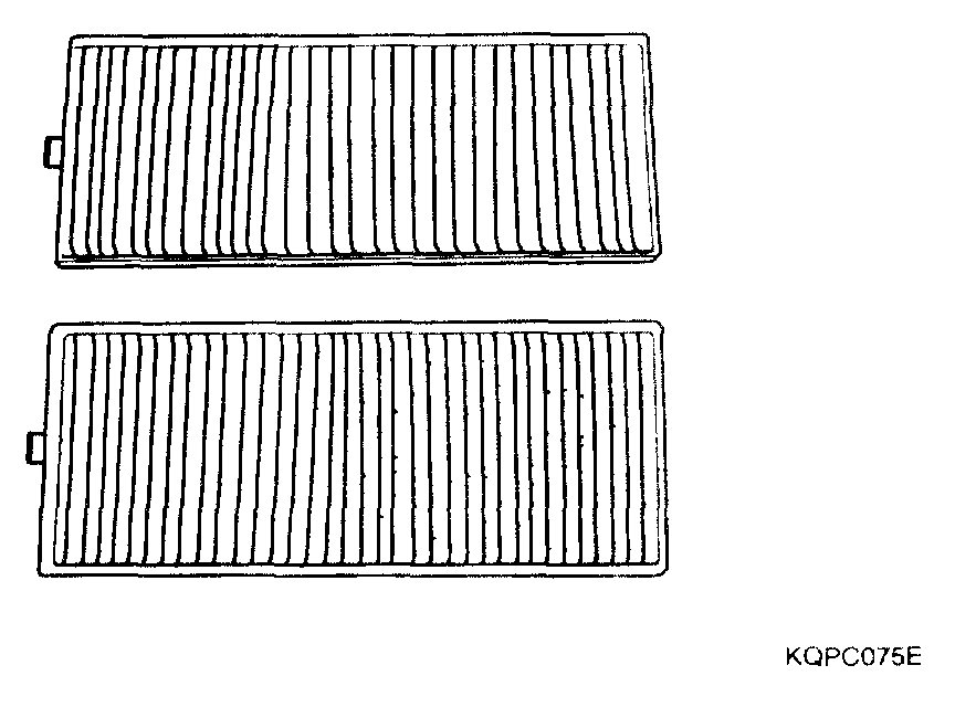

4. Replace the upper/lower air filters.
pic 6
NOTE: When removing and installing, don't forget there are 2 air filters in the air conditioner

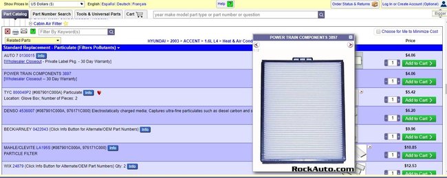

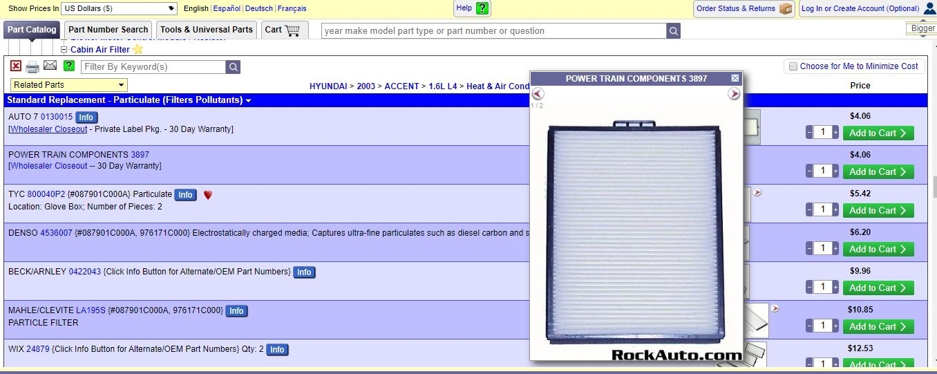

Thank you. Do you know if the cabin air filters are sold in sets of two? And, do you recommend a certain brand or model?
Mar 18, 2020 at 7:08 PM
  • 110,194 POSTS
Honestly, I suspect they will be sold individually. However, I could be wrong. As far as brand, nothing specific. Any of the brands sold at a parts store will work well.

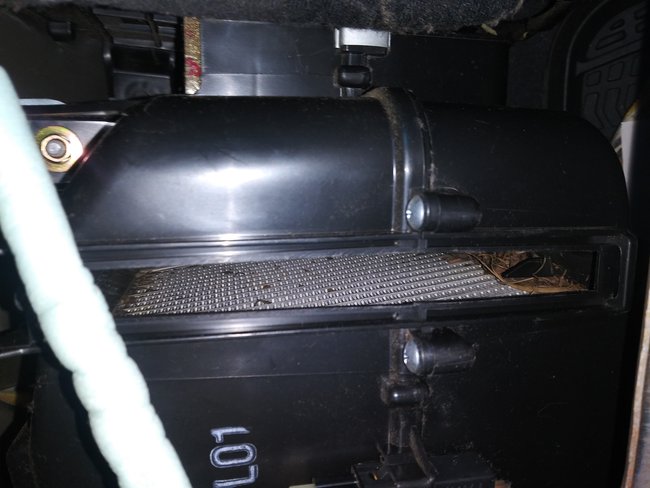

I took off the cover and it looks like no filters are in there.

Good afternoon,
If I am not mistaken, the filter is in the picture. The leaves are laying on it.

Are the filters side by side or one on top and one on the bottom?
Mar 21, 2020 at 3:20 PM
Just pull that unit out. The replacement will look the same as you see in the picture.
Mar 21, 2020 at 3:22 PM
MELISSA.BLUTH13
  • 13 POSTS
It does not appear to be a filter. It is metal and is part of the car.
Mar 21, 2020 at 3:54 PM
Hard to tell from the picture but I attached a picture of the filter.
It may be that someone removed it at some point and never replaced it.
