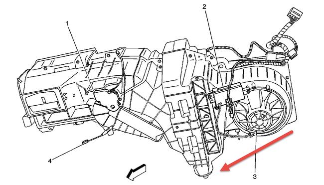

CJ MEDEVAC
  • 11,000 POSTS
This was an "option"........and maybe you ain't got one!
................but if you do, this is a diagram from "mitchell i"
It was for a 2002
I hope this is self explanatory and aids you
The medic

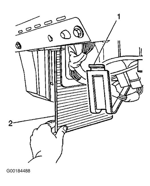

OBXAUTOMEDIC
  • 3,719 POSTS
Hello, It is located under right side of dash

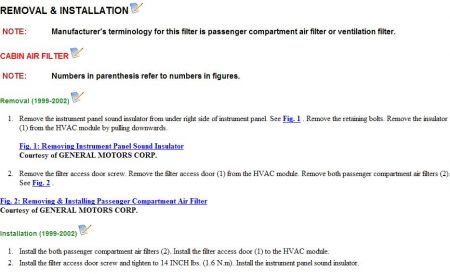

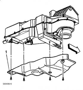

MHPAUTOS
  • 31,937 POSTS
Hi there, Cabin air filter service as per pics, as for your other question, I will pass on your other request to others with more experience in these cars. Mark (mhpautos)
