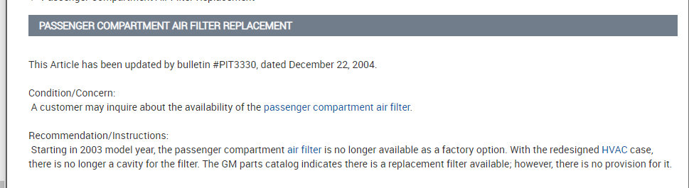

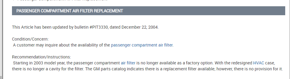

HMAC300
  • 48,601 POSTS
Here is what the factory is saying
PASSENGER COMPARTMENT AIR FILTER REPLACEMENT
This Article has been updated by bulletin #PIT3330, dated December 22, 2004.
Condition/Concern:
A customer may inquire about the availability of the passenger compartment air filter.
Recommendation/Instructions:
Starting in 2003 model year, the passenger compartment air filter is no longer available as a factory option. With the redesigned HVAC case, there is no longer a cavity for the filter. The GM parts catalog indicates there is a replacement filter available; however, there is no provision for it.
Apr 30, 2021 at 8:03 AM (Merged)

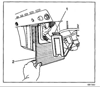

  • 75,992 POSTS

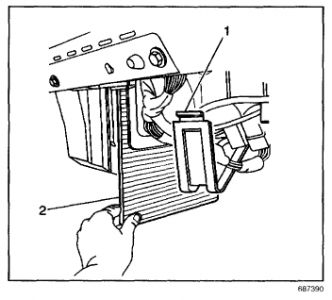

This guide will help and the diagrams below https://www.2carpros.com/articles/how-to-change-an-air-cabin-filter 2002 Chevy Truck K 1500 Truck 4WD V8-6.0L VIN U Cabin Air Filter Locations View
https://images.2carpros.com/forum/automotive_pictures/12900_caf1_1.jpg
REMOVAL PROCEDURE
https://images.2carpros.com/forum/automotive_pictures/12900_caf2_1.jpg
1.If equipped, remove the IP sound insulator. 2.Remove the filter access door screw. 3.Remove the filter access door (1) from the HVAC module. 4.Remove the passenger compartment air filter (2). INSTALLATION PROCEDURE
https://images.2carpros.com/forum/automotive_pictures/12900_caf3_1.jpg
1.Install the passenger compartment air filter (2). 2.Install the filter access door (1) to the HVAC module. NOTE: Refer to Fastener Notice in Service Precautions. 3.Install the filter access door screw. Tighten Tighten the screw to 1.6 Nm (14 lb in) . 4.If equipped, install the IP sound insulator.

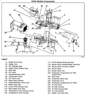

GARBDHIFI
I am trying to locate the cabin airfilter on my chevy silverado for replacement.
MHPAUTOS
  • 31,937 POSTS
Hi there, See pic & text for cabin filter info. Mark (mhpautos)
https://images.2carpros.com/forum/automotive_pictures/61395_1_72.jpg
https://images.2carpros.com/forum/automotive_pictures/61395_Graphic_107.jpg
https://images.2carpros.com/forum/automotive_pictures/61395_Graphic1_4.jpg

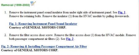

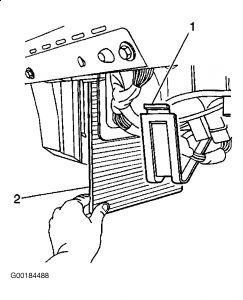

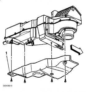

GUILLY81
can you tell me where the cabin air filter is located
Apr 30, 2021 at 8:04 AM (Merged)
BLUELIGHTNIN6
  • 16,542 POSTS
remove the instrument panel sound insulator from under the right side of the instrument panel. then remove teh insulator from the HVAC module and you should then see the filter access door.
https://images.2carpros.com/forum/automotive_pictures/261618_Graphic_213.jpg
