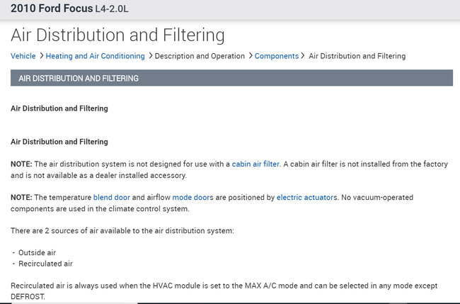

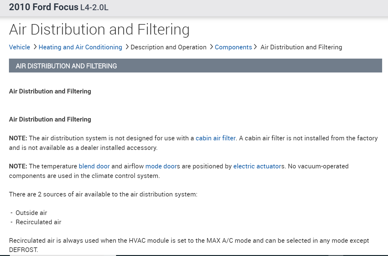

Can you confirm that this Ford Focus SE Sedan (four door) has a cabin air filter?
If so, can you send me instructions with a diagram if possible on how to remove it?
Thanks again- you guys are absolutely the best!
Jon
Jun 12, 2019 at 2:53 AM
SCGRANTURISMO
  • 4,897 POSTS

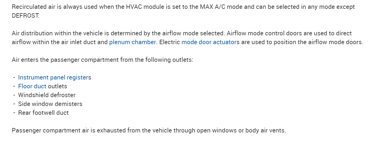

I have included the information that you requested in the diagrams down below. The short of it is that your vehicle is not equipped with a cabin air filter.Please let us know if you have any other vehicle related questions, we will be happy to answer them for you.
