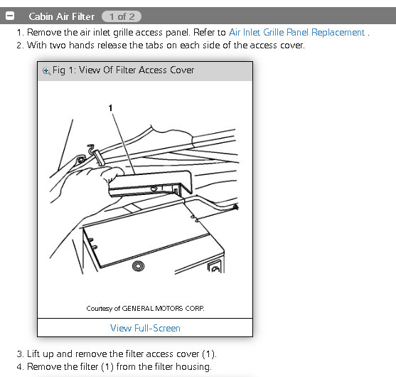

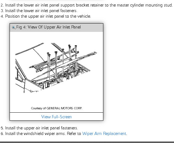

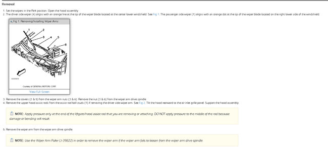

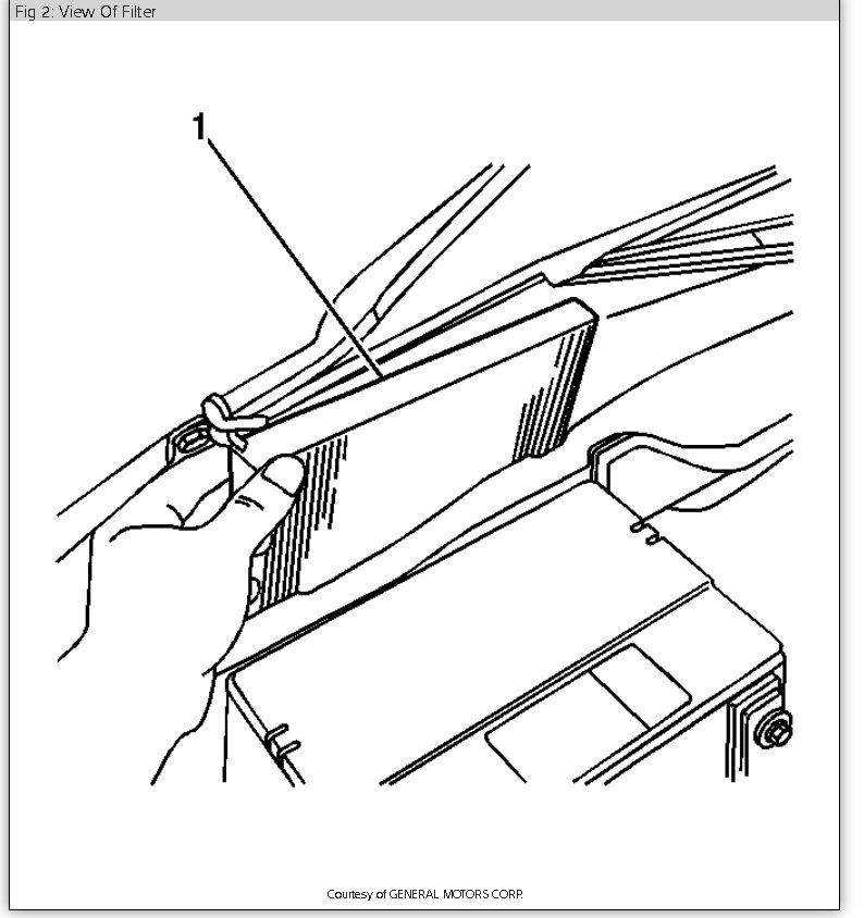

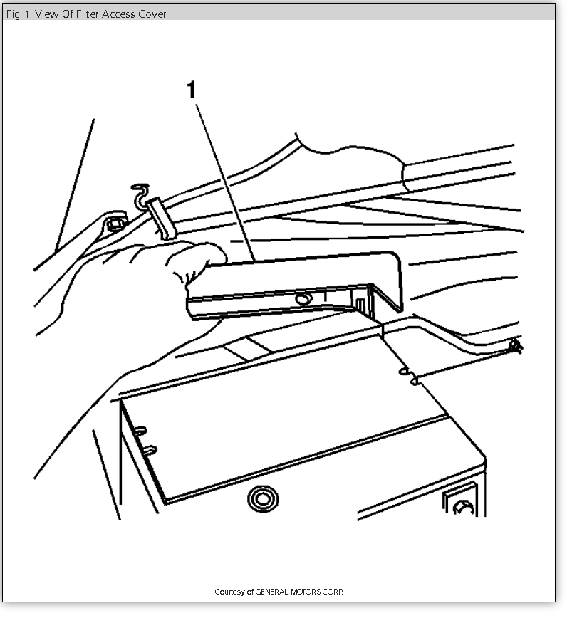

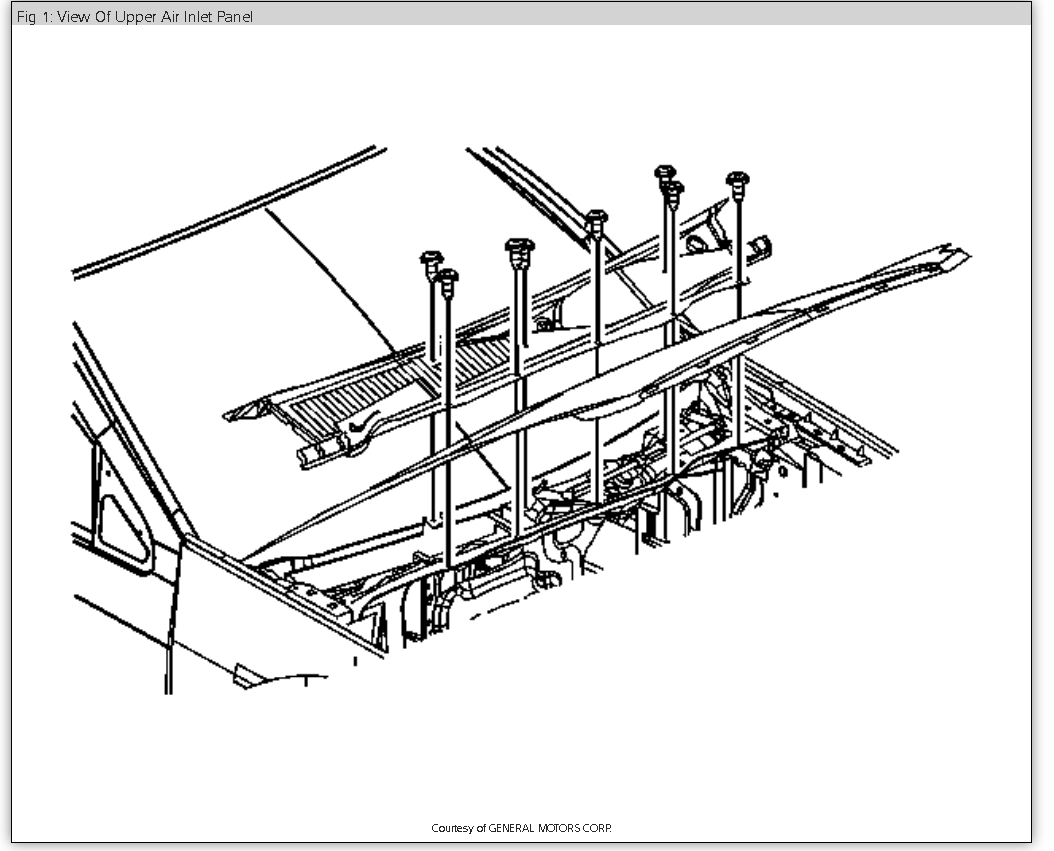

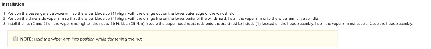

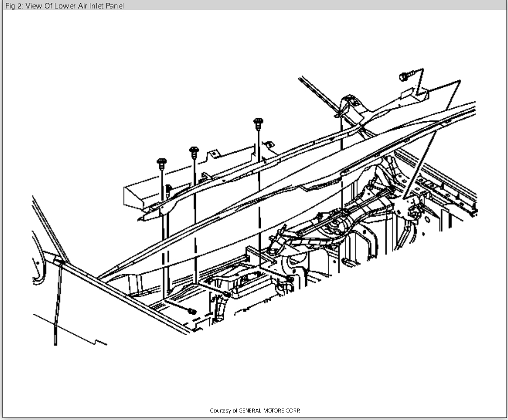

How do I change the subject filter?
Oct 23, 2018 at 11:24 AM
WILLIAM CRABTREE
  • 95 POSTS

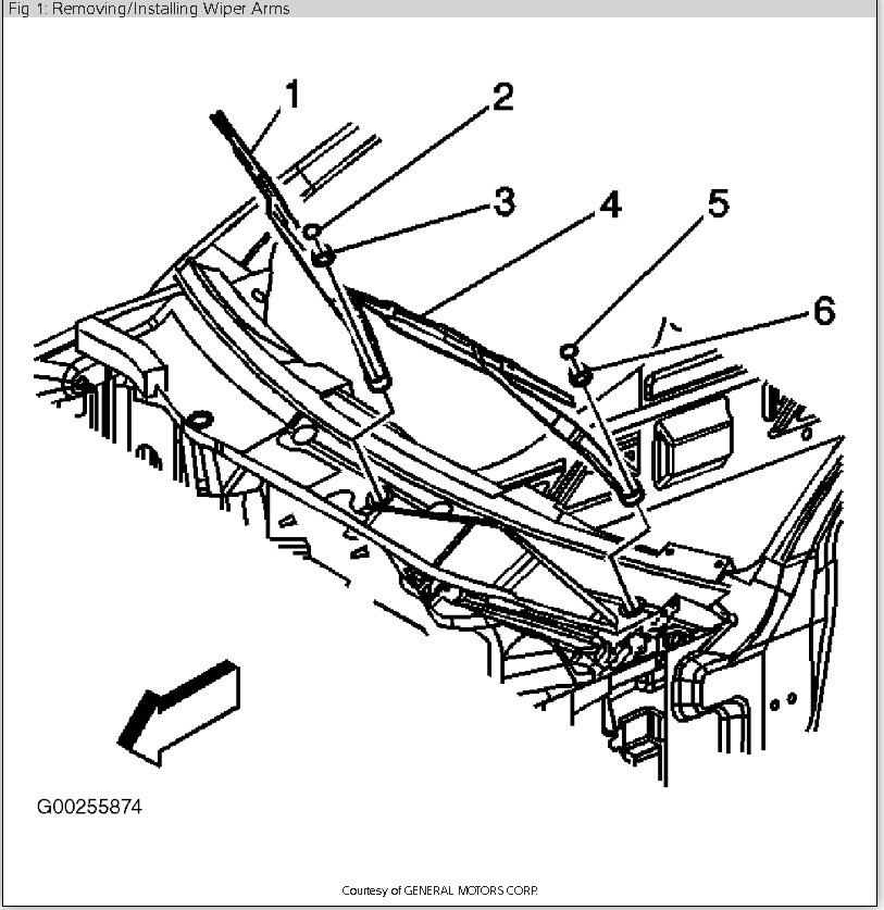

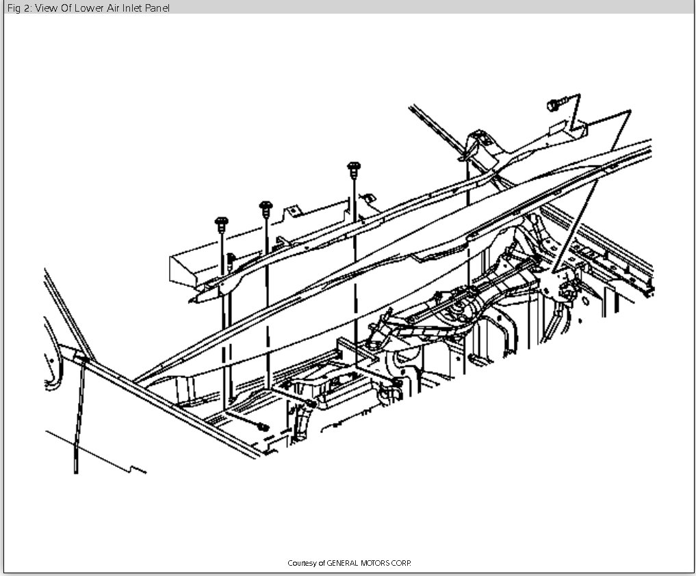

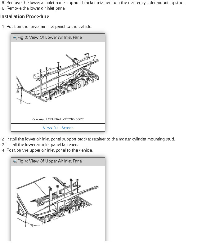

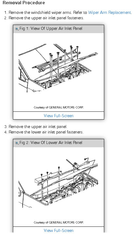

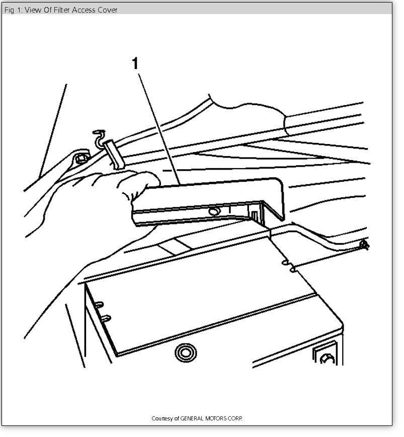

I have attached diagrams on how to remove and replace the filter.
The procedure does involve removing the windshield wipers as well as the air inlet grille (directly below the wiper arms). Therefore, I have attached diagrams on how to do all of it.
Let us know how it goes!
