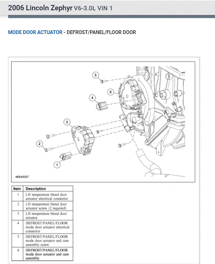

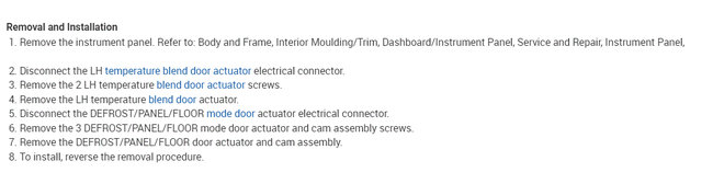

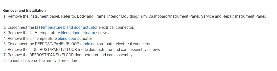

If you are getting no airflow from the vent, does it come out elsewhere? For example, does the defroster work or at your feet? If it does, then it is likely related to the mode door actuator. The mode door is what directs airflow. If that isn't the case, let me know. However, if it is the issue, I attached the directions below for replacing the mode door actuator below.

I wonder if the mode door is moving enough to prevent air from entering the vehicle. Something is closing or moving to prevent the airflow from entering the vehicle.

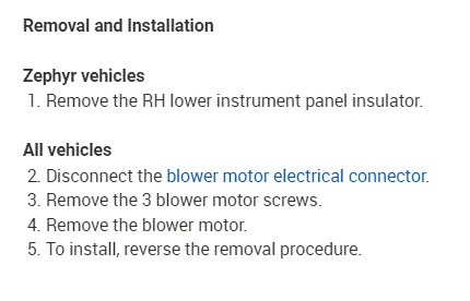

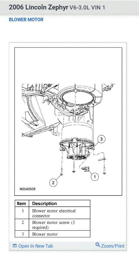

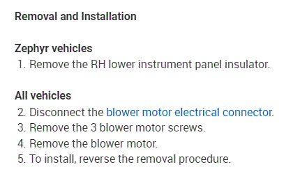

At this point, you may want to remove the blower motor and confirm there is nothing in there that could be causing the airflow.
The blower motor is under the dash on the passenger side. I attached the directions below for the removal and installation procedures.
Let me know if that is something you would feel comfortable doing.
