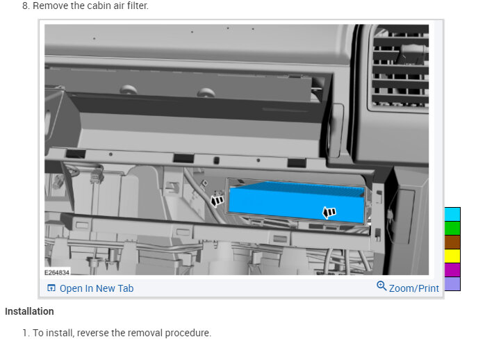

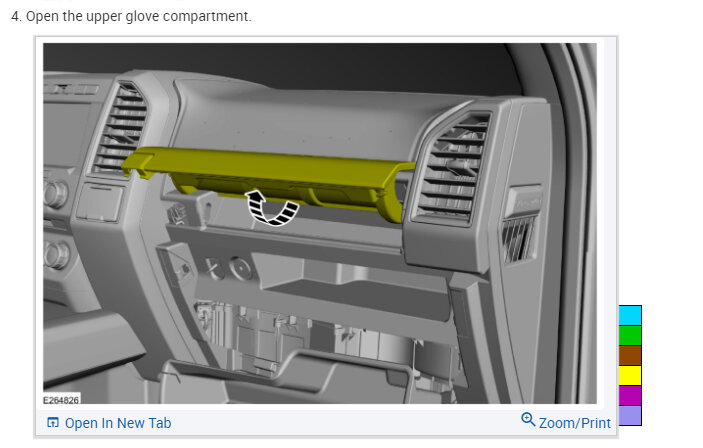

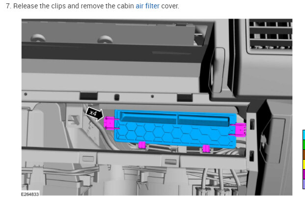

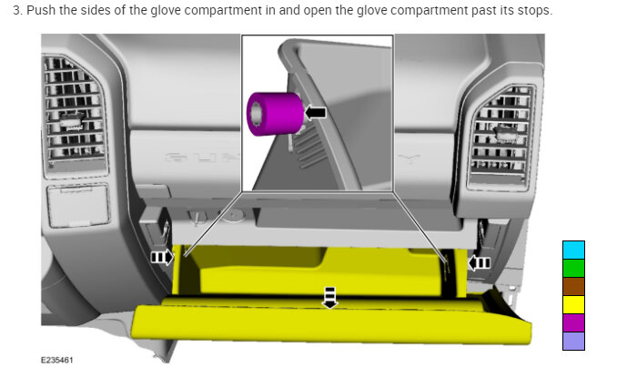

Cannot find where Cabin filter goes?
Jun 25, 2023 at 7:32 AM
  • 110,244 POSTS

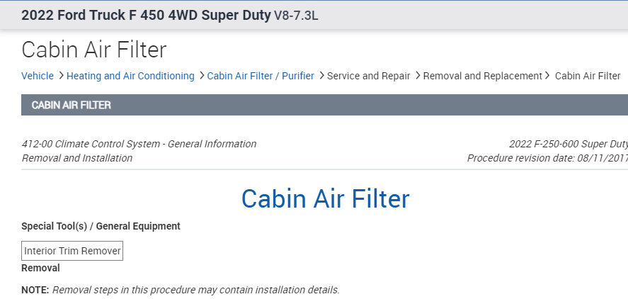

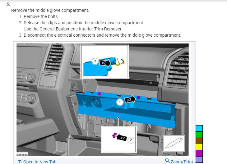

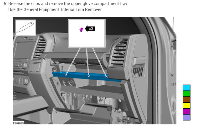

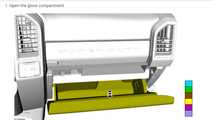

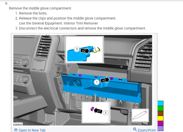

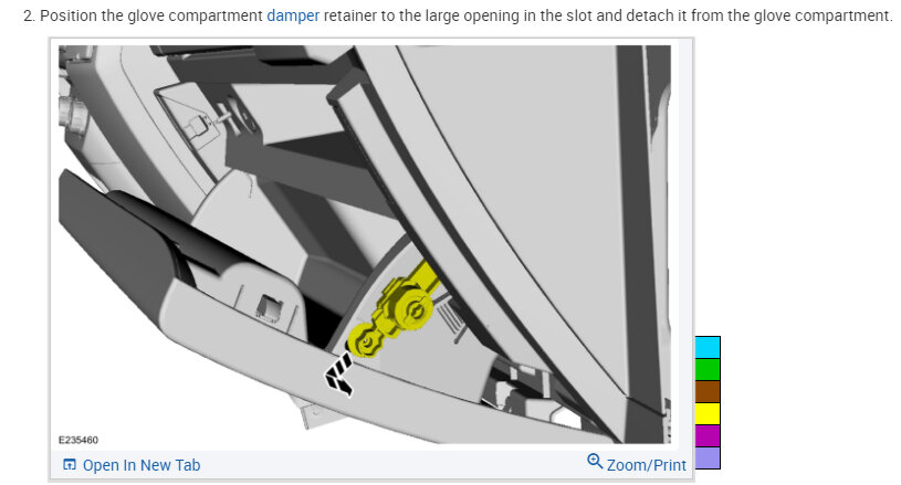

My manual goes up an F450, but they should be the same.
As far as the location, it is behind the glove box, but there is a little more involved to access it.
If you look below, I attached the directions for replacing it. Take a look through them and let me know if it helps.
