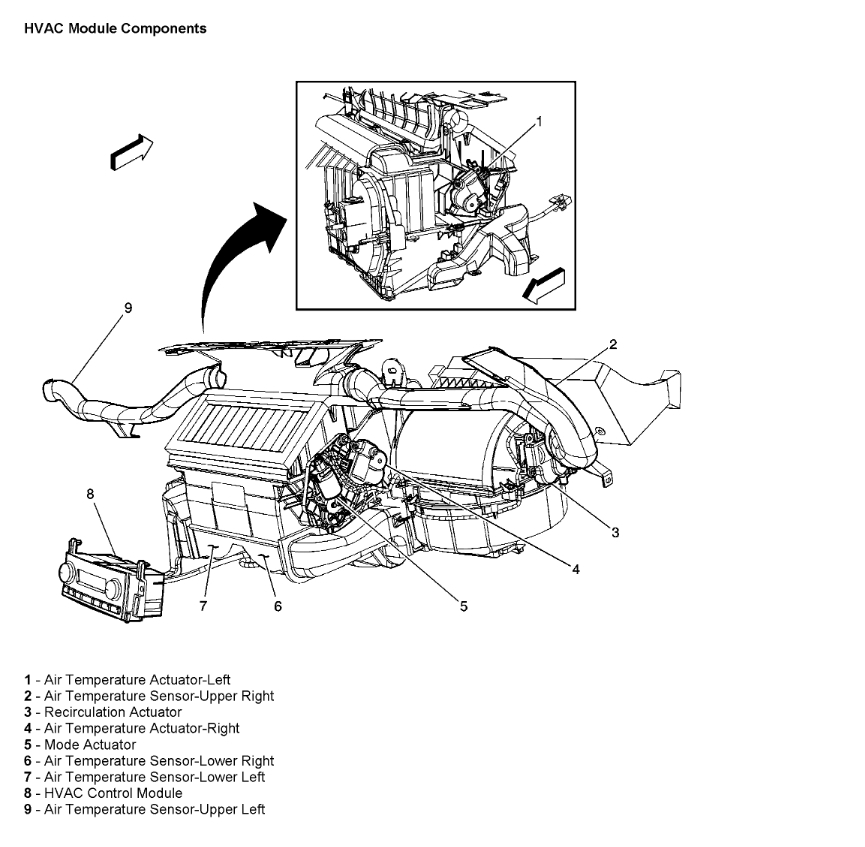

C6 heat and A/C blows only through small side vents, dual climate control, no active codes. Control head has been changed. tried pulling HVAC fuse to reset actuators, no change. Need help locating blend door actuators and any tips on replacement.pictures would help. Thanks 327 stingray

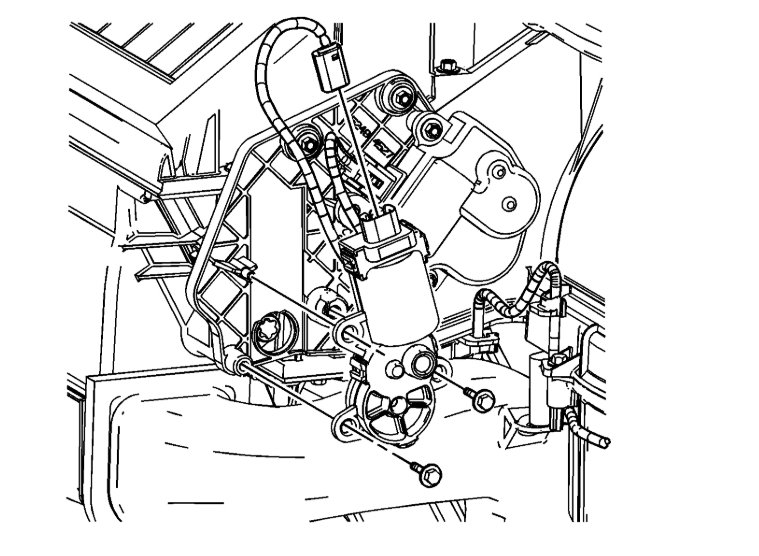

Sounds like the mode actuator is not working, here is the location of the mode actuator along with the other blend door actuators as well. Check out the images (Below). Please let us know what happens.

Where Is It Located Behind Control Head Or On Pass. Side Behind Glove Box ?
Jul 1, 2019 at 9:29 AM
It is on the left side blend air door motor
