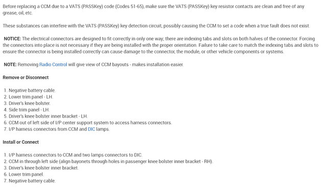

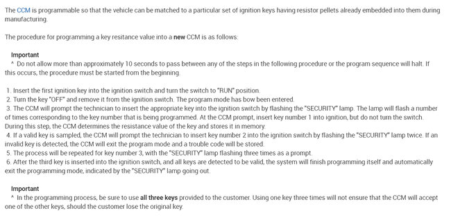

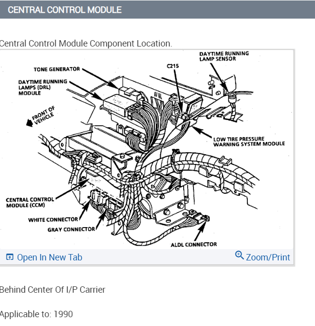

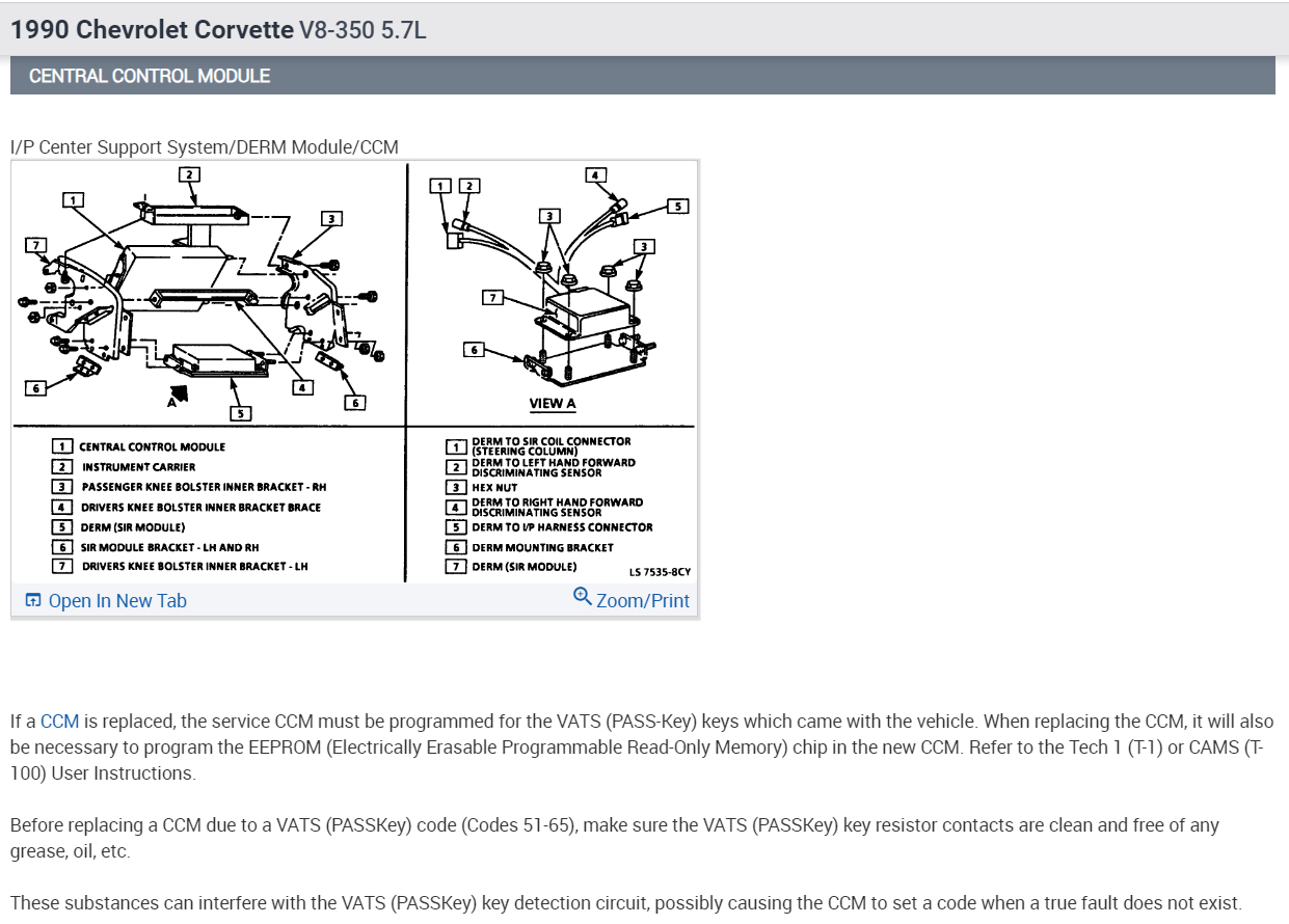

This vehicle uses a Central Control Module (CCM), not a Body Control Module (BCM). It will need to be programmed to the car, you can get a preprogrammed unit by searching Google or Ebay. here is the location of the CCM and how to replace it. Check out the images (below). Please let us know if you need anything else to get the problem fixed.
