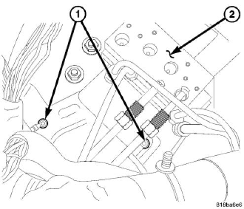

Regardless, if you find it is bad, here are the directions for replacement. The attached pics correlate with the directions.
__________________________
2007 Dodge or Ram Truck Nitro 2WD V6-3.7L
Installation
Vehicle Brakes and Traction Control Hydraulic System Hydraulic Control Assembly - Antilock Brakes Service and Repair Removal and Replacement HCU (Hydraulic Control Unit) Installation
INSTALLATION
INSTALLATION
pic 1
NOTE: If the ABM module is being replaced with a new ABM module it must be reprogrammed with the use of a scan tool.
1. Install ABM (2) on the mounting bracket rubber pockets (1).

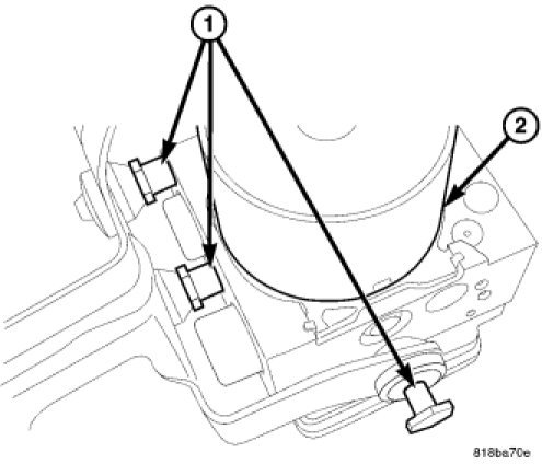

pic 2
2. Install brake lines to the ABM (2) and tighten to 20 Nm (180 in. lbs.).
3. Install wiring harness connector to the ABM and push down on the release to secure the connector.
4. Install negative battery cable to the battery.
5. Bleed ABS brake system.
