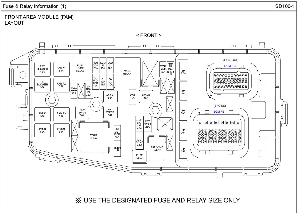

The vehicle listed above is an LX. The TPMS light is off and on for about 2 weeks (intermittent) and then the check engine light comes up. AutoZone scanned and came up with code C1611. From your previous post, this code could indicate Steering issue (but it is fine), ABS (brake is fine and no ESC light) and could be TPMS? The TPMS can be on when driving in the early morning (cold) and disappears after 5 minutes of driving. Discount Tires twice checked all TPMS sensors of each tire and confirmed they are good. I suspect the code C1611 is the communication issue caused from TPMS but I do not know where to start. Please help. Thanks

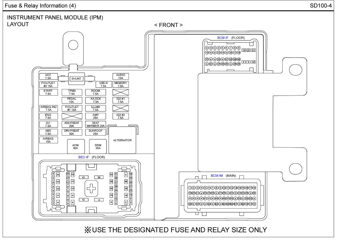

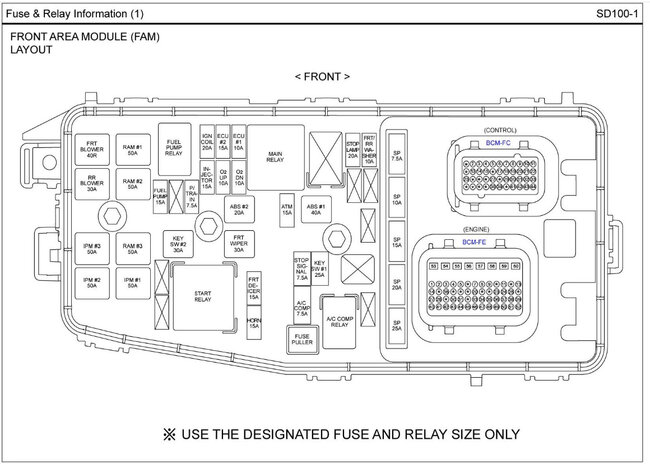

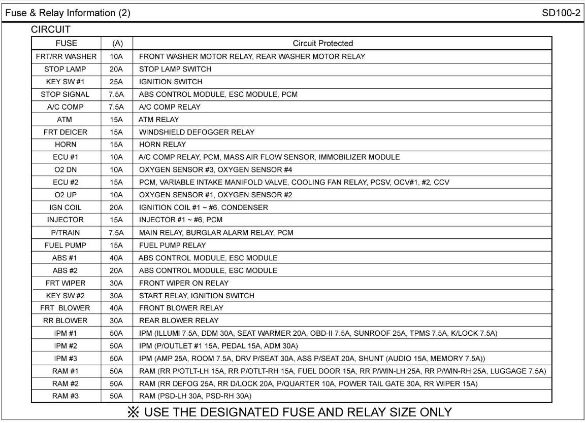

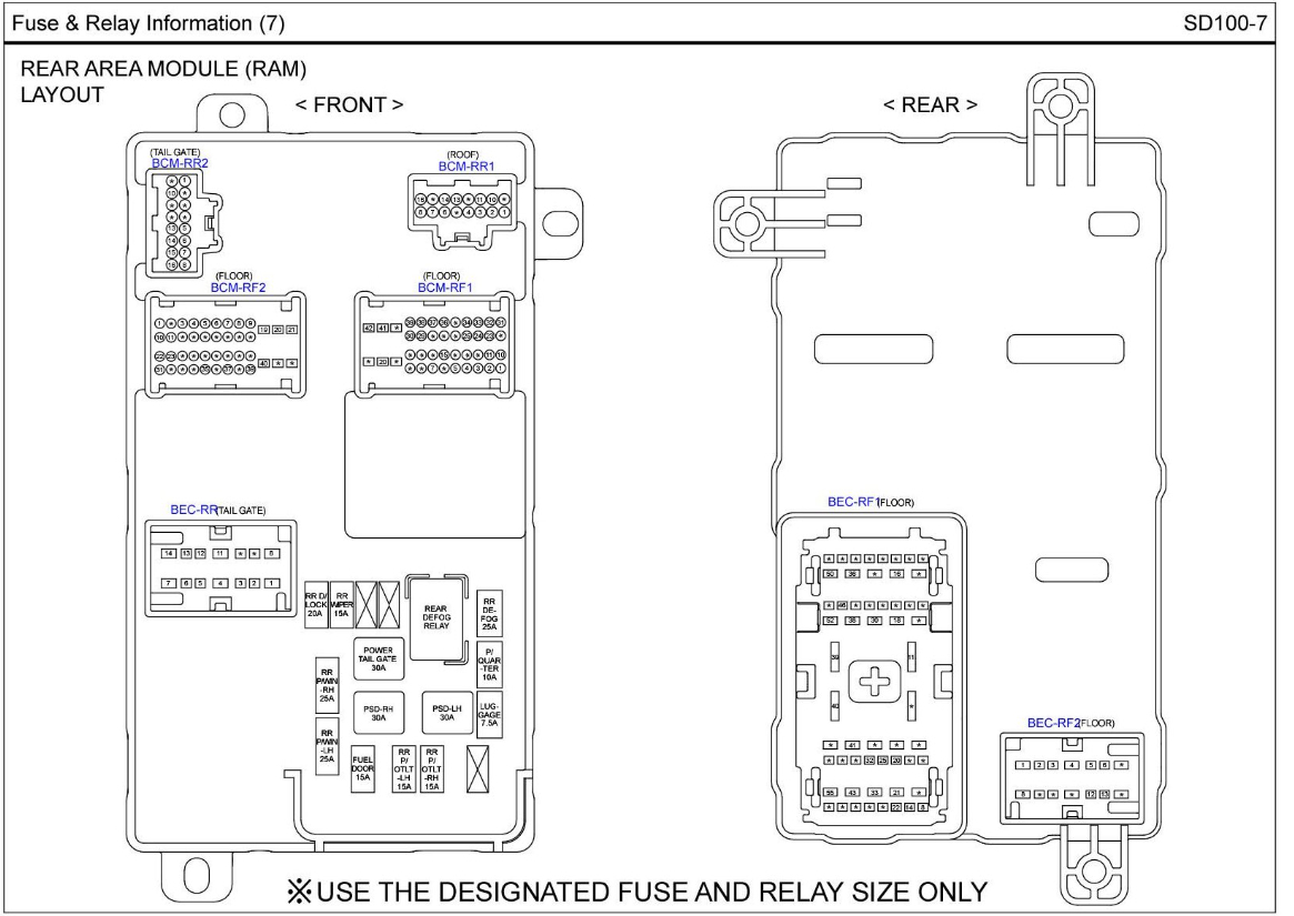

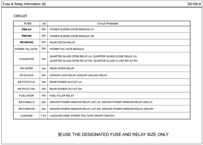

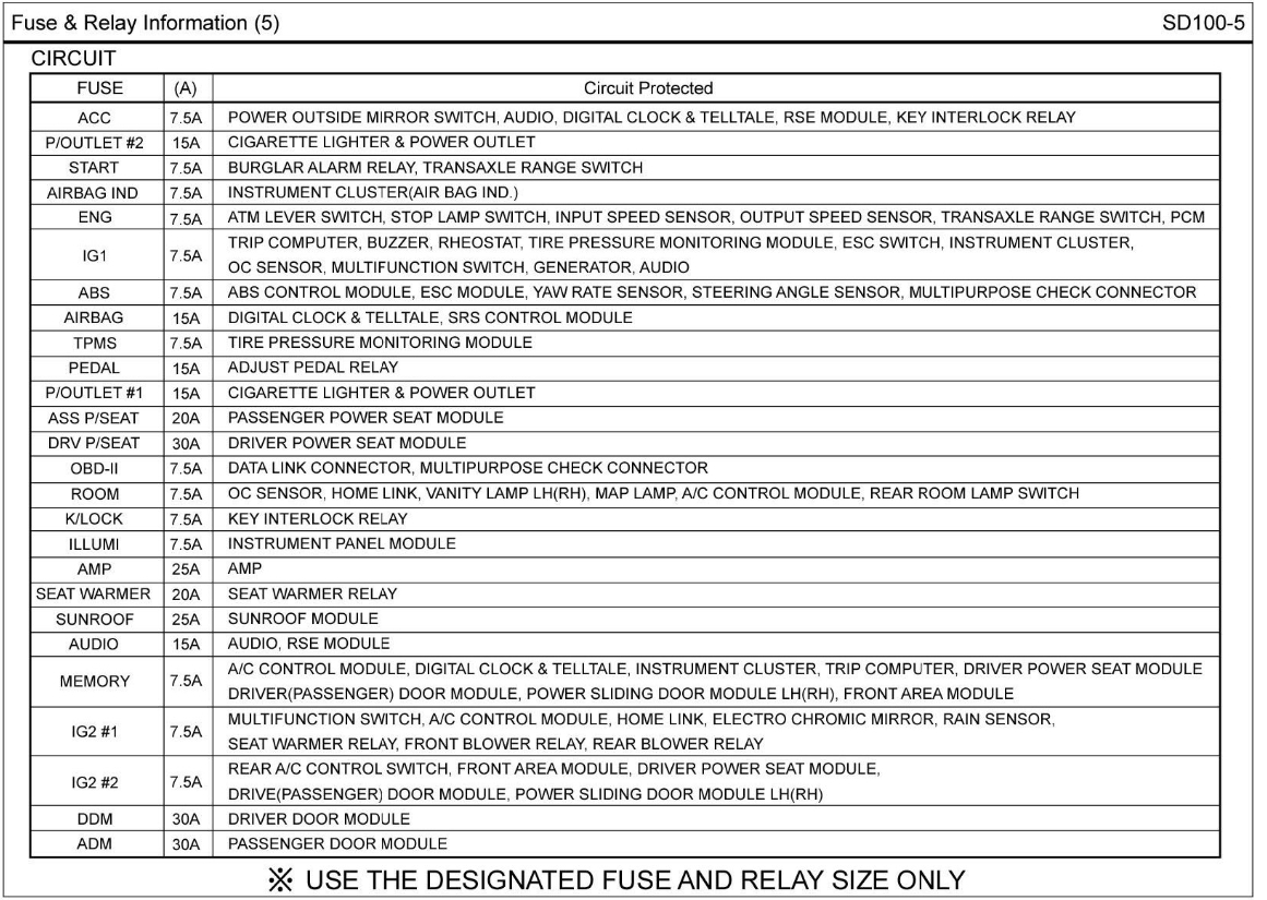

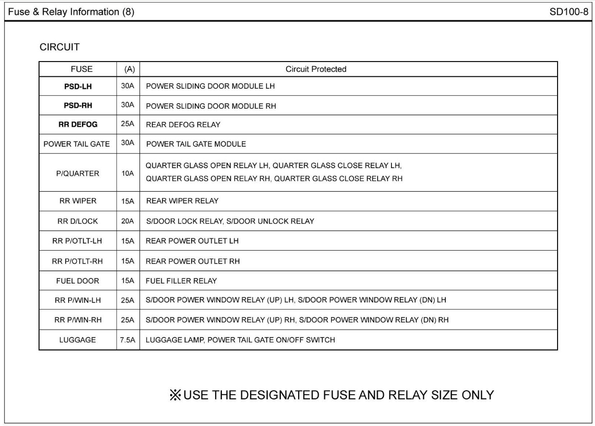

So this means there is a module that is not working inside the CAN BUS system. With all the systems on I would check all fuses.
This guide can help you and I have included the fuse locations in the images below:
C1611: CAN Time-out EMS (Engine Management System)

Sorry to respond late since I was out of town. Thanks for your suggestion; I indeed checked all the fuses (3 fuse boxes) and disconnected the negative side to clear the code. After that, when driving in the morning (only happens in the morning???), the TPMS (letter, not the low air icon) will appear for about 5 minutes of driving and disappears and then the check engine light comes up and stays on. The good strange thing is the van is running good, no issue with steering nor with braking (ABS). It is also low mileage due to being used on the short drive mostly (72K). Any more ideas are welcomed. Thanks

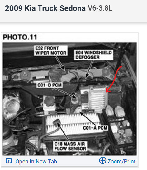

  • 54,832 POSTS
I would replace the ECM with a preprogrammed unit by searching google or ebay. Here is how the job is done. Check out the images (below). Please let us know what happens.
Dec 17, 2024 at 10:26 AM
