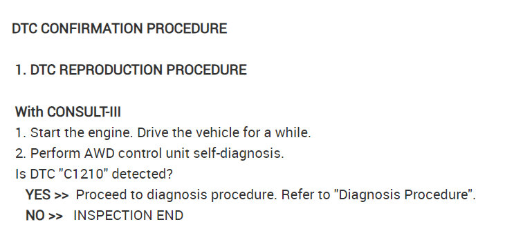

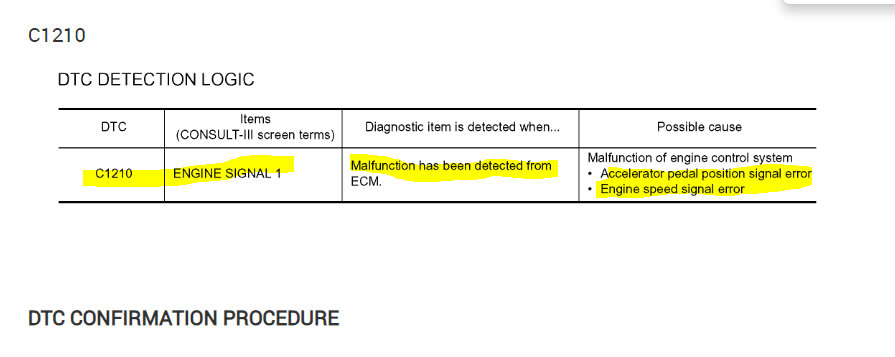

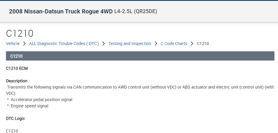

Code C1210, where is the AWD module located?
2008 NISSAN ROGUE
200,000 MILES • 2.5L • 4 CYL • 4WD • AUTOMATIC
EARL91
MEMBER
88 POSTS

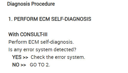

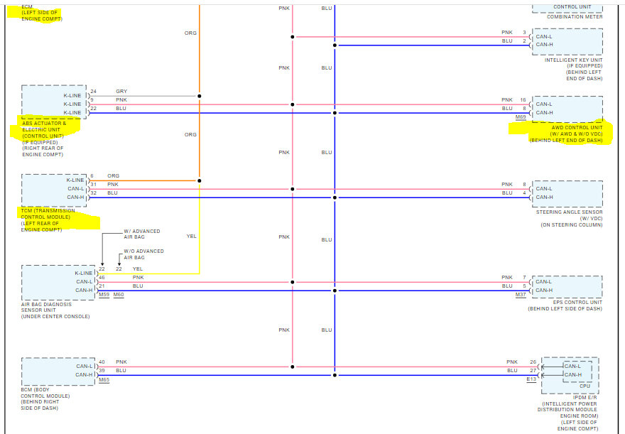

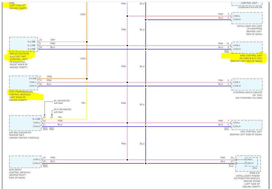

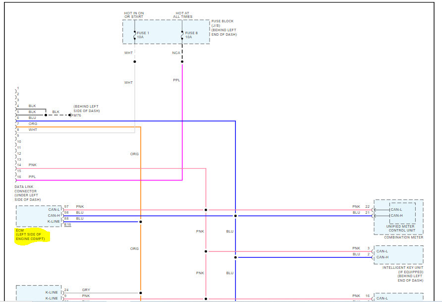

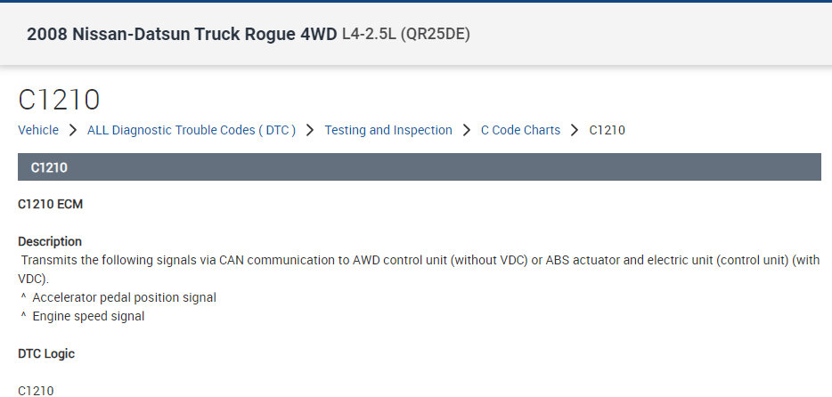

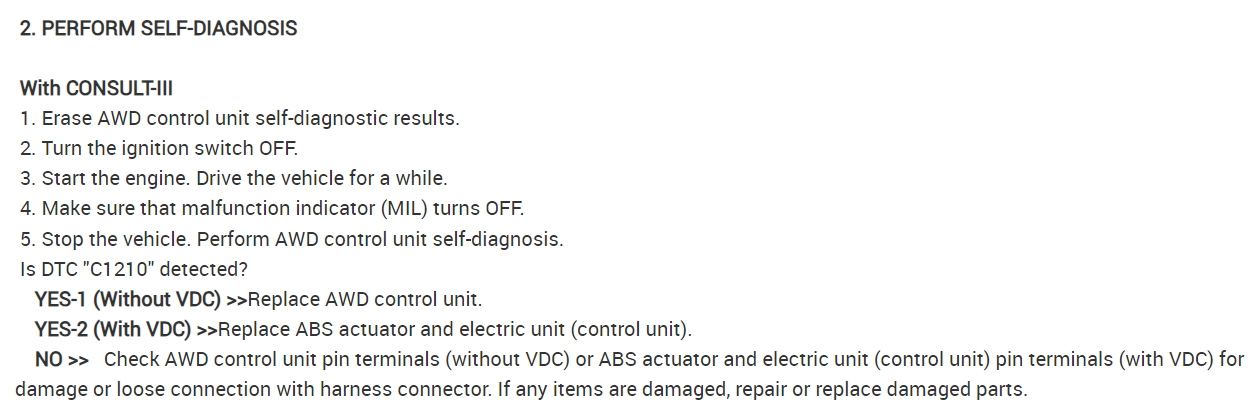

Need a location of the AWD module and a CAN-bus wiring diagram for this code please.
May 22, 2024 at 4:13 AM
Experienced Mechanic
110,248 POSTS
The code could be related to a few different things including the ABS module, AWD module, ECM, and so on.
If you look below, I attached the diagnostics for the code and the last two pics are the can-bus circuits.
Take a look and let me know if this helps.
