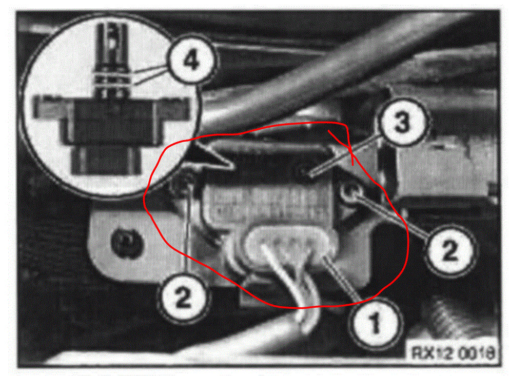

my vehicle lost power and would only go 30 MPH. i hooked up my code reader and it showed these codes ssf20381, 1237 pressure sensor intake manifold before compressor input low...
0130 oxygen sensor bank 1 before cat, malfunction.
c110+ code reader.

This could be related to the manifold absolute pressure sensor (MAP). Let's start by checking it. First, check the connector and wiring at the sensor. I attached a pic below to help you locate it. The code indicates a low voltage issue. That could be the result of corrosion in the plug.
See pic below.
