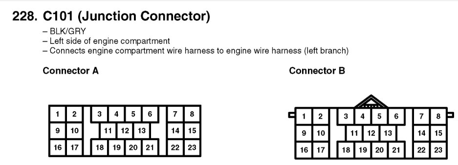

I'm looking for the c101 plug pinout diagram for the car listed above.

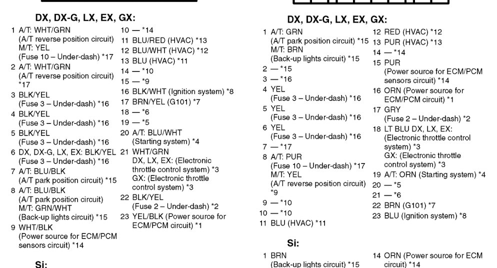

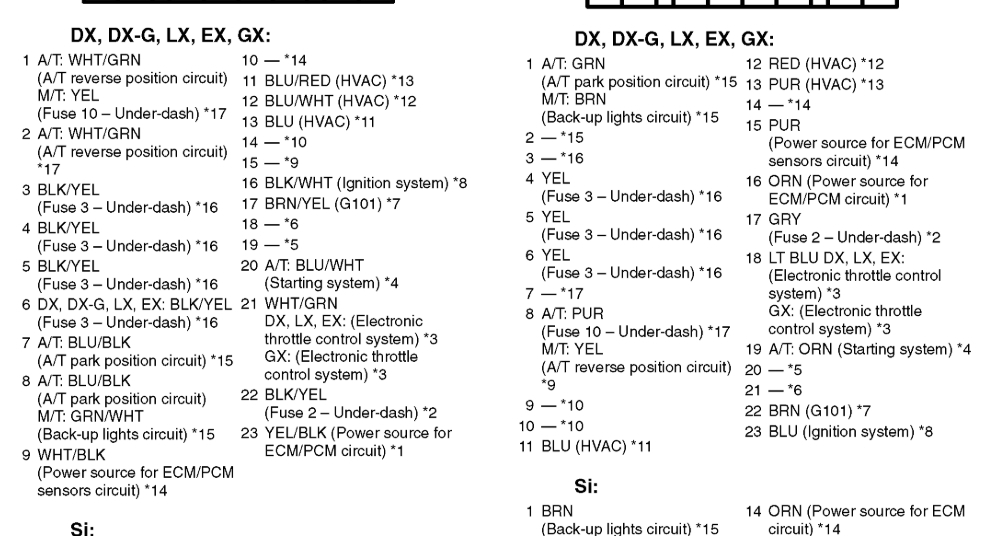

So there are some variances depending on trim level, here are the pin outs for the C101 electrical connector. Check out the images (below). Let us know if you need anything else.

The one I'm looking for is the fd2 with k20a3 engine and automatic transmission. I think it's similar to the Acura CSX touring or premium models.

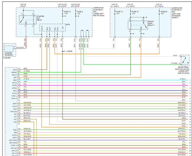

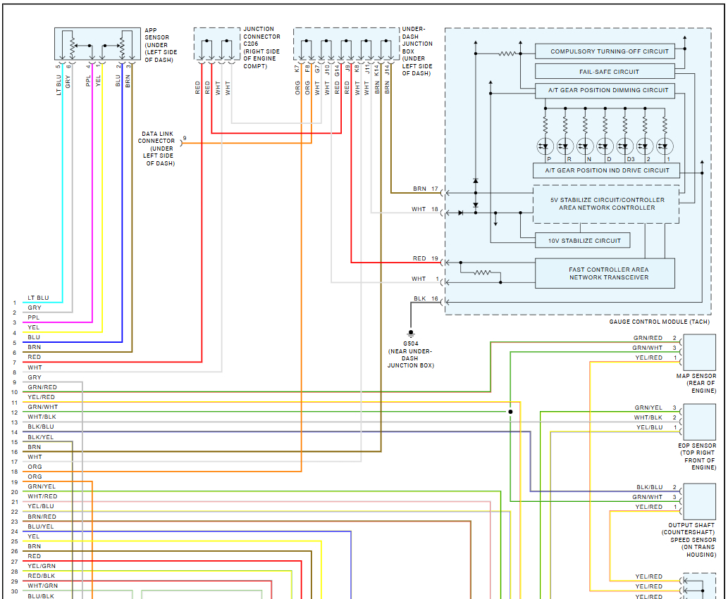

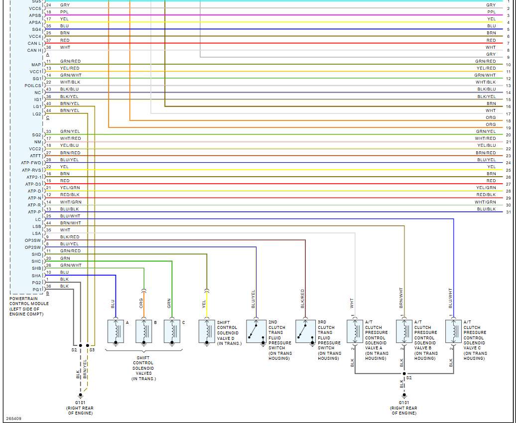

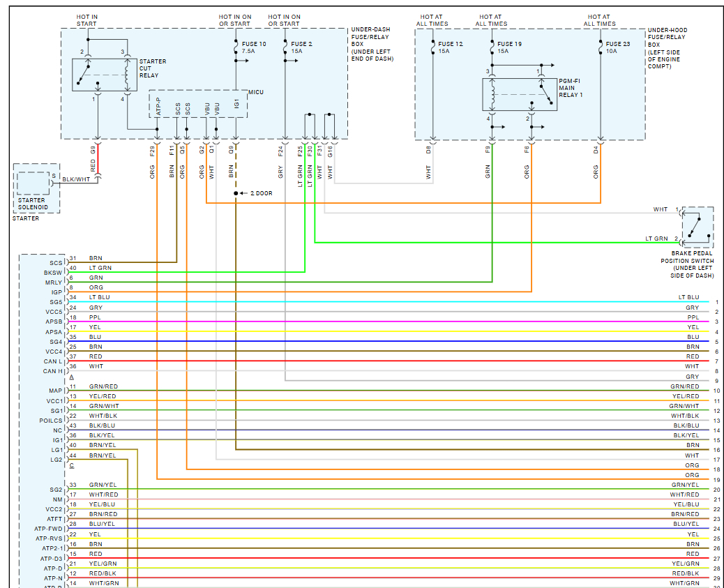

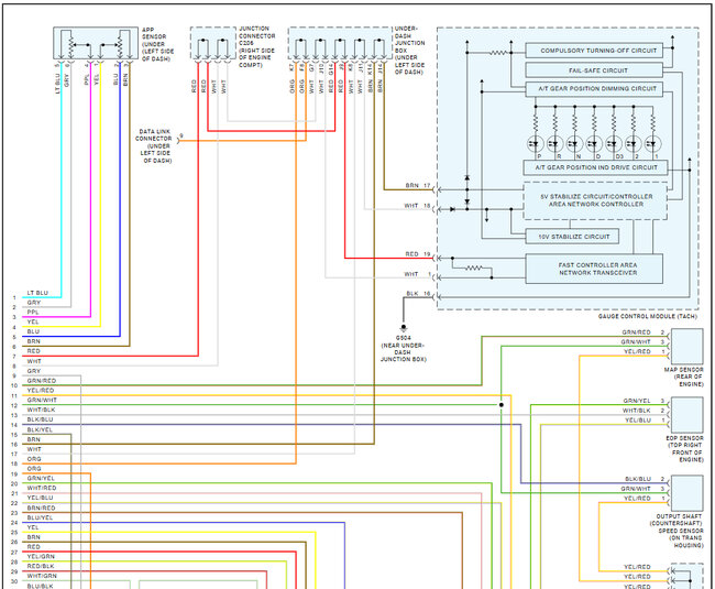

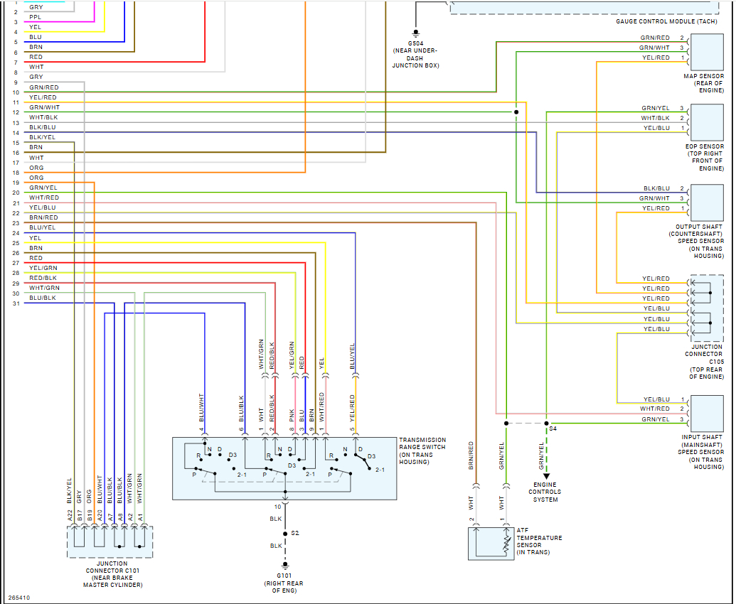

The "Acura CSX" is a Honda civic? This is what they show for the car listed above. Here are the wiring diagrams for the transmission so you can see how the system works.

No the Acura CSX premium/touring isn't a Civic however it is similar to the one I'm talking about the Civic I'm talking about is the 2007 Honda Civic fd2(Auto trans) not the type r what I'm looking for is c101 plug diagram so I can make an adapter for my kswap because I'm using the engine harness and ECU from that Civic.

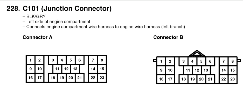

This is all we got. Sorry,
