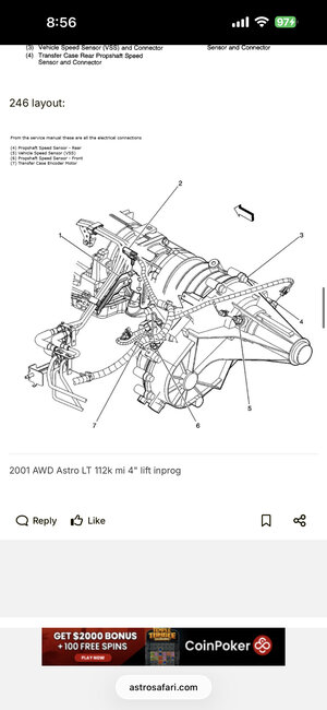

Sorry for the delay,so i used a scope inside that rear prop shaft hole,reluctor ring looks clean and fine no damage. Today i did live data on the transfer case and noticed an issue and this issue is the same whether its in 2WD,auto 4WD or 4HI,the rear prop shaft speed is reading but the ATC slip speed is reading the same exact rpm as the rear prop shaft and its showing red in color which obviously isn’t good and thinks it’s slipping. The front prop shaft speed is showing 0 rpm no matter what gear the transfer case is in and what speed im going so im assuming i either have a bad front prop shaft sensor or wiring issue to that sensor? And that could be why im having this speed issue with the rear abs n vss reading lower than the front abs?

Im attaching a picture and in the diagram,the one labeled #6 is the sensor im talking about. Its called (propshaft speed sensor-front) its reading 0 rpm at all times.I didnt swap out the abs module yet because im trying to rule out everything else first

Here is the picture

Gotcha, yes the front sensor does not control the speedometer, it is an input to the PCM. The sensor in the transfer case is the one that works for the speedo.

With that front sensor reading 0 rpm ,do you think that is playing a factor in the issue im having with the rear sensor only reading half of what the front abs sensors are reading or do you think its irrelevant? So if im going 45mph…the front abs sensors are reading 45mph but the rear sensor is reading 22mph and the vehicle speed sensor is reading the same 22mph because its using the same reluctor ring inside the case. The speedometer reads the 22mph on the dash. Obviously i feel like im going 45mph while driving so the front abs is definitely correct but the vehicle speed sensor and rear abs sensor are wrong. The drastic difference in what the front n rear abs readings are is setting that c0245 code. Im just not sure if the front prop sensor reading 0 rpm is relevant to this issue or if its just a module problem

I don't think the front sensor does much, but if the ABS module is bad it will give the bad readings you are getting for the front and rear differences. You can try to replace the front sensor again and also check for a reluctor wheel as well to be sure.
