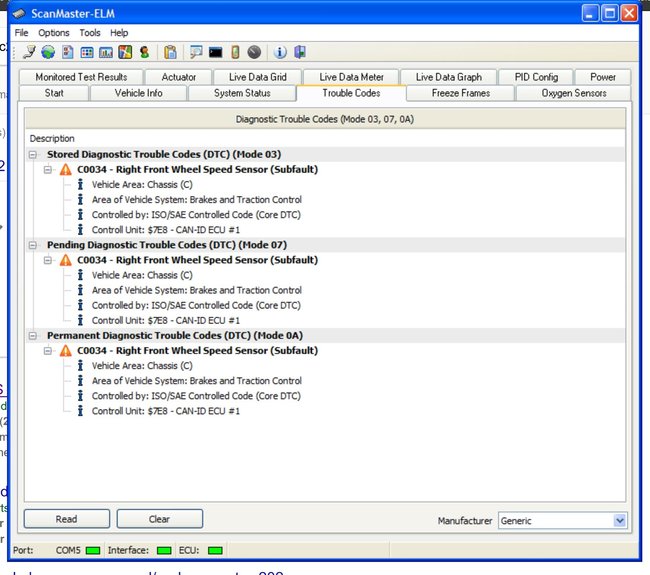

sorry for delay in responding. I actually have TOAD Scan software that I got up and running to see if it could give me more info. see attached. again I cant clear the codes even with the toad software vs scan tool. I have not checked to see if the replacement part is good. I was trying to find info on how to test the part but cannot. can you provide any info on part testing? thank you

For testing of wheel sensors, with a scan tool it should be easy. Go into live data display and monitor the various sensor speed while driving the vehicle around. If you have a hoist, with vehicle lifted or jacked up, manually turning the wheel would allow you to check if it is functioning. However this does not mean the sensor is bad if it is not reading. It just tells you the circuit has a fault and it could be the control unit, wiring or even the sensor pickup ring.
I don't have aceess to our database for the time being so I am not able to tell you the specifications for the sensor for testing. Hopefully I can get this resolved soon

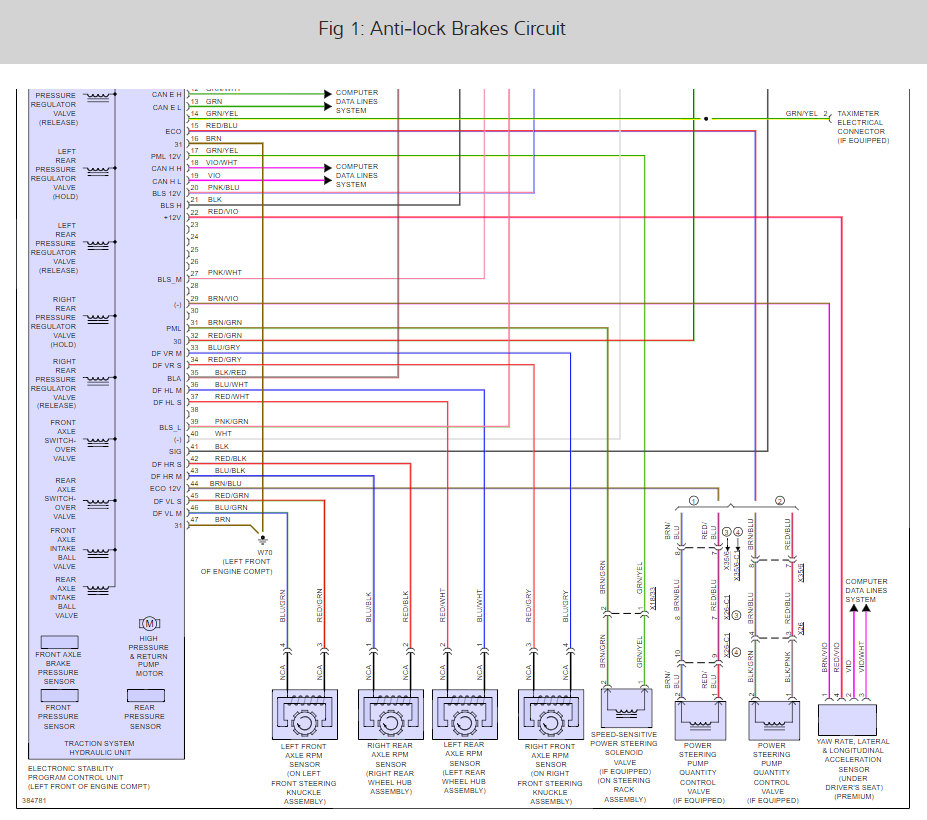

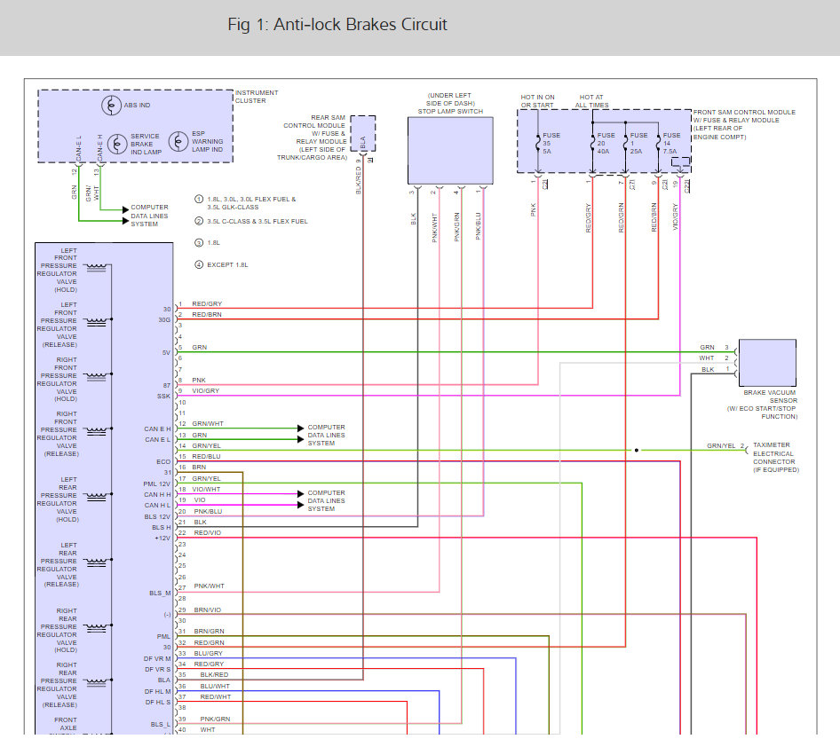

It does sounds like the wiring or ABS module is out. Here is an ABS wiring diagram and a guide to help you see what is going on.

thank you for the info and drawings. I watched the video and located the scanner you suggest, however, it appears that this scanner will not work with Mercedes. is that true? is there another one I should consider?

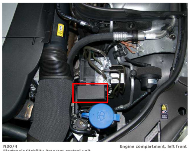

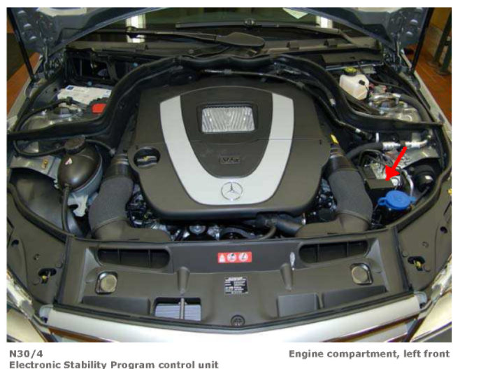

  • 55,758 POSTS
Did we ever check the wiring between the left front sensor and the control module? Here is a guide to help you just use the wiring diagrams above
Nov 29, 2017 at 3:15 AM
BILL PARRISH
  • 8 POSTS
I will try that now, if I can figure how to get the cover off that thing ;-)
also I access to Mercedes WIS/ARSA if that is helpful. trying to slug my way through it.
Nov 29, 2017 at 5:07 AM
  • 55,758 POSTS
