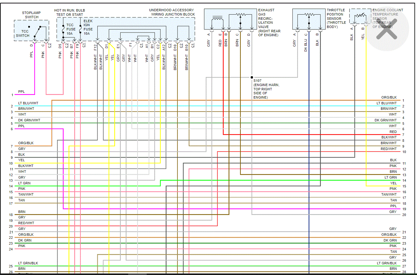

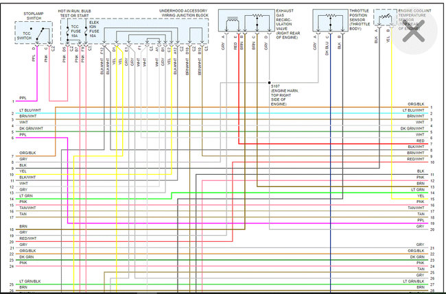

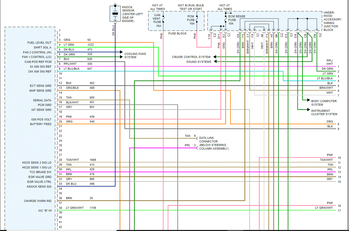

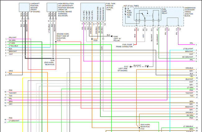

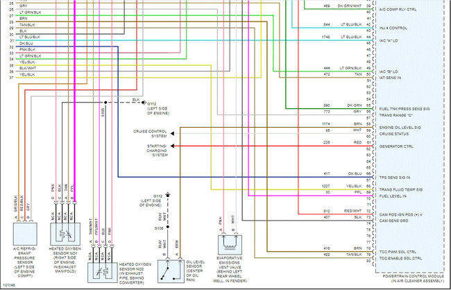

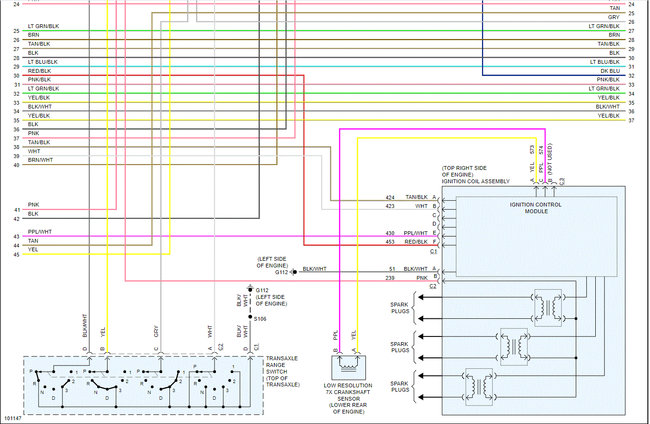

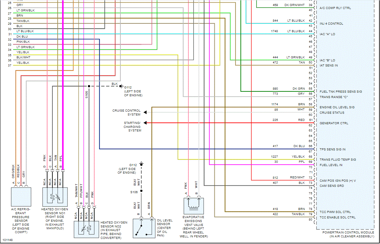

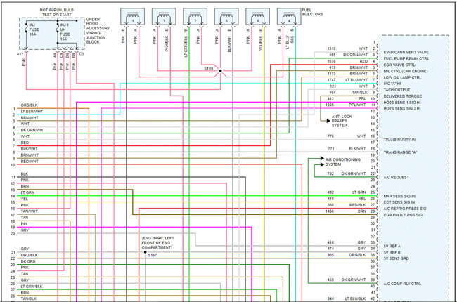

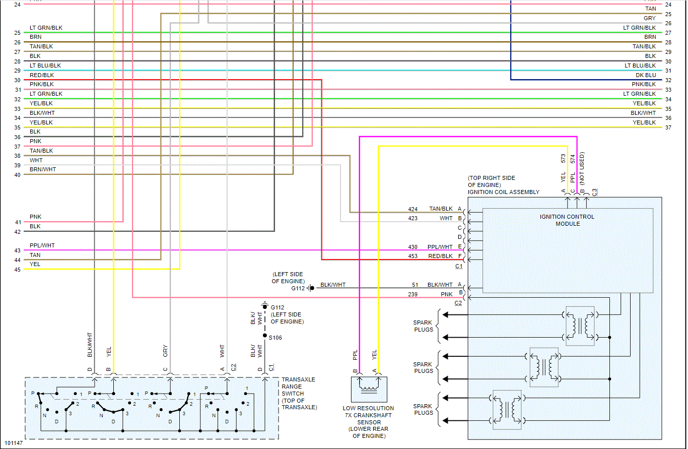

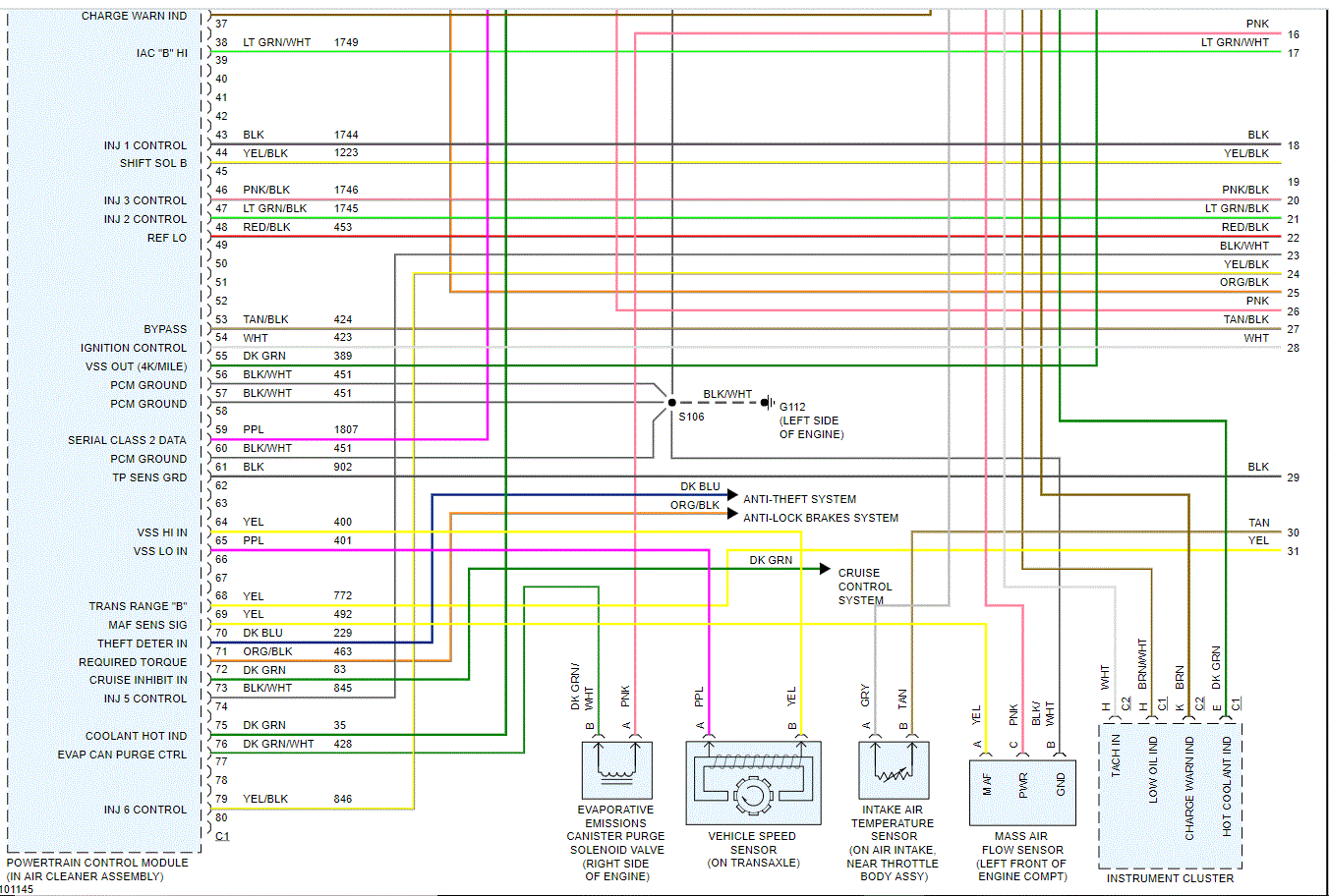

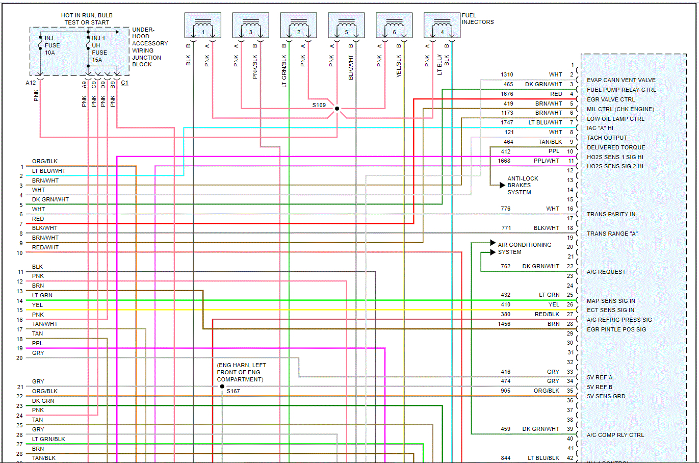

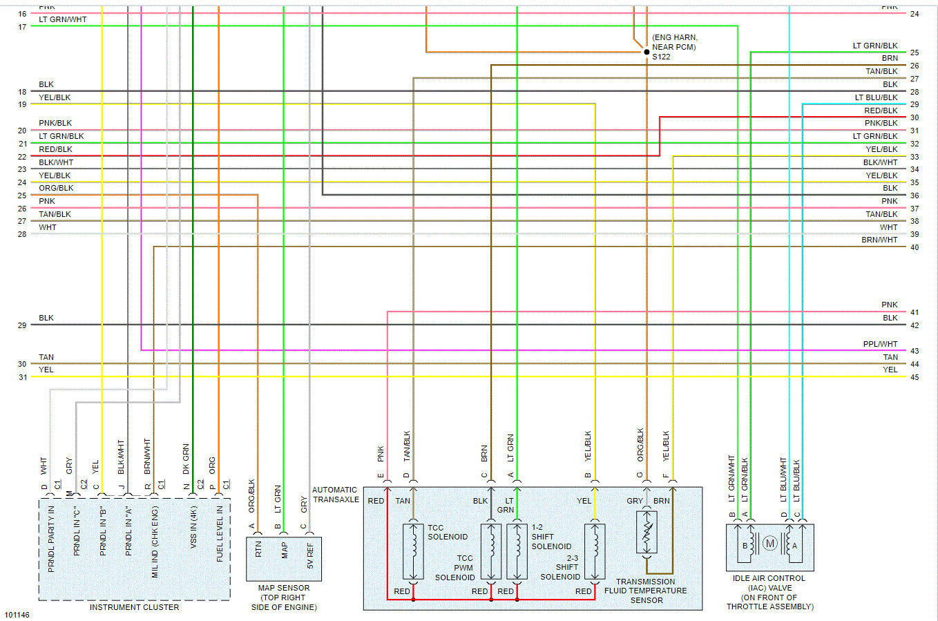

Hi again,
I wanted to add the wiring schematics for the powertrain management. Hopefully, they will help.
I had to cut the pics in half to make them readable. However, I did overlap them so you can follow from one to the next.
I hope they help. Also, here is a link you may find helpful:
Take care and let me know if you have other questions.
