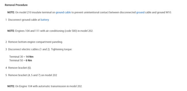

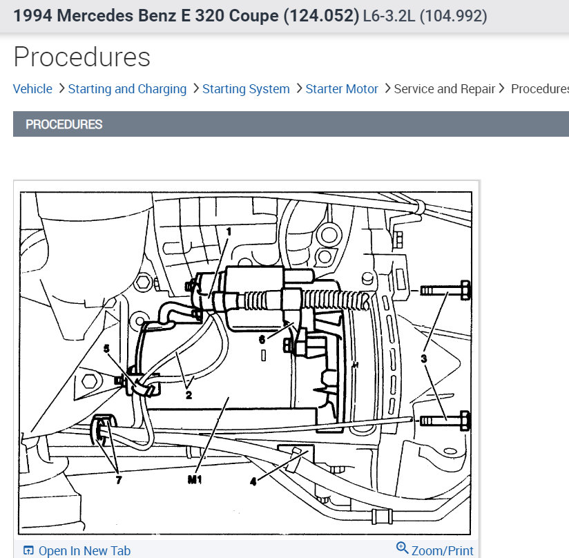

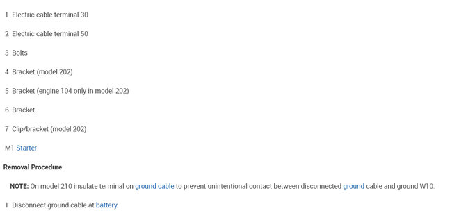

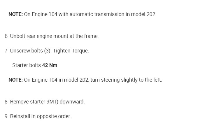

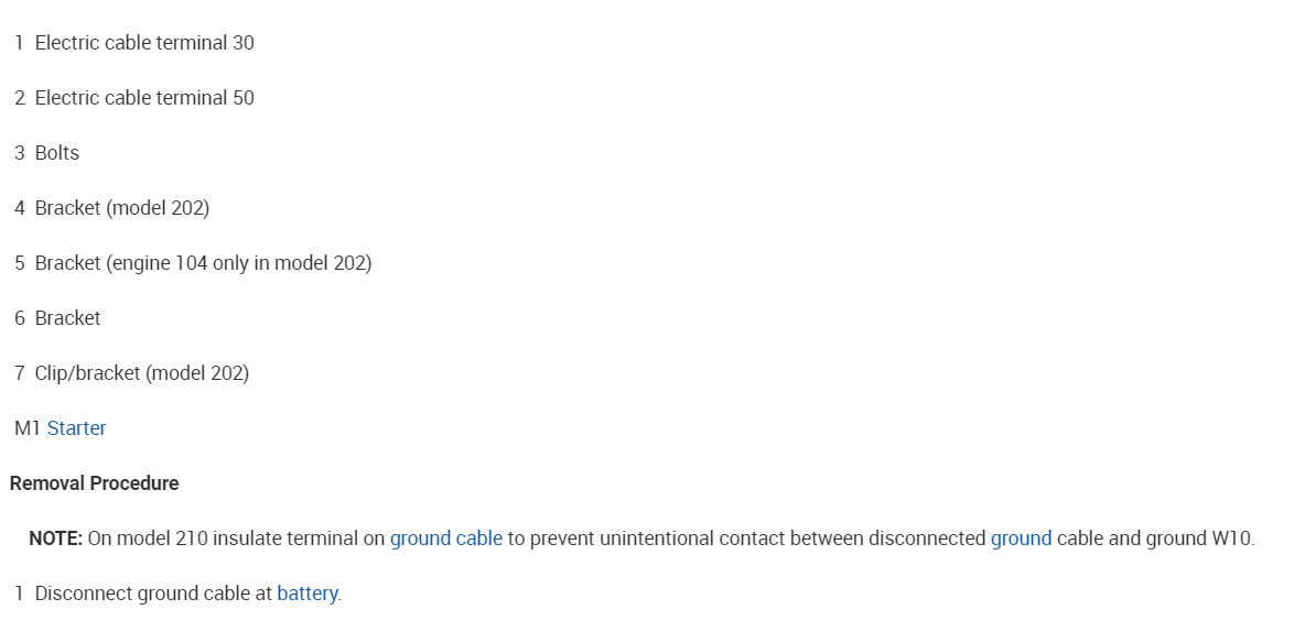

Is the security light flashing when you try to crank it over? If not, it sounds like the starter has gone out. T,o be sure we can use a test light on the starter trigger wire this guide will help you and I have left starter replacement instructions in the diagrams below.
