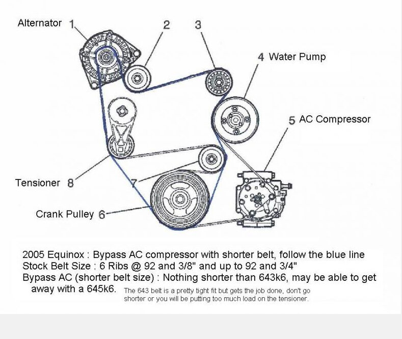

What size belt would I need to bypass the A/C compressor with a smaller belt and without a bypass pulley?
Thursday, October 20th, 2022 AT 5:11 AM
2 Replies
BORIS K
MECHANIC
795 POSTS
To bypass the A/C compressor, you should be able to use a 643K6 or 645K6 belt.
See image below from a 2005 Chevrolet Equinox, same engine. Follow the blue line.

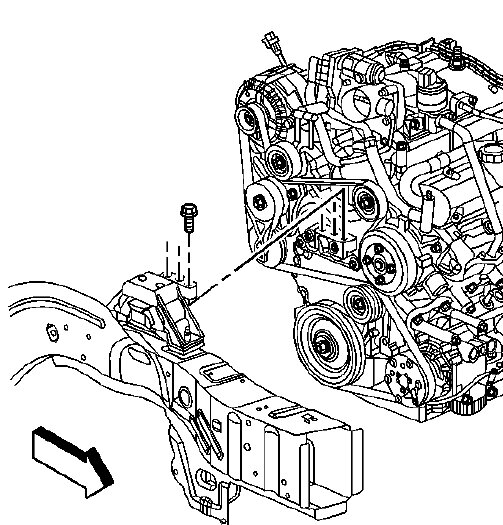

To access the belt, you will need to remove the engine mounting, see image 2.
