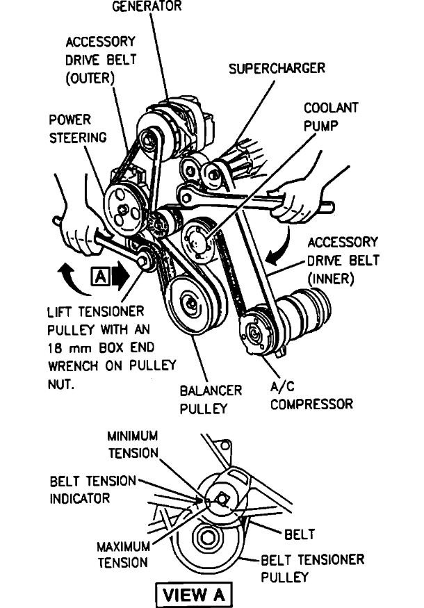

My supercharger does not work. I got a shorter serpentine belt but am not sure how to bypass the supercharger. Do u have a diagram or a video?
Apr 19, 2016 at 2:10 PM
HMAC300
  • 48,601 POSTS
The car will run with the S/C bypassed (Not running) but the vehicles performance will suffer greatly since the blades in the S/C will impede intake air flow
Belt diagram is attached below

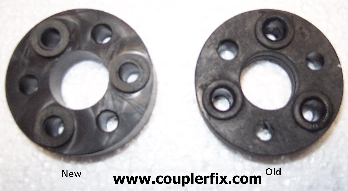

at slow idle supercharger rattles. also where do you check the oil on this supercharger?
Thanks
Ed
Feb 20, 2019 at 5:04 PM (Merged)
GMRAD
Ed, This rattling noise is usually caused by the supercharger coupler plate and is, in most cases, not a critical issue. Fixing this is not difficult.
Buick is GM and used the same engine as Pontiac, so your car most likely has an Eaton blower. Check to be sure!
You can fix this yourself for less than $50 USD and a couple of hours. I found the part (both OEM type and Heavy Duty replacement) at zzperformance.com
Best of luck to you.

I had the same problem and found out this was my problem. Coupler in the nose of supercharger was either broken or loose. To check if this is problem take off only the supercharger belt, start car and listen for noise. If no noise this should be fix.
https://images.2carpros.com/forum/automotive_pictures/232622_couplerfix_1.jpg
