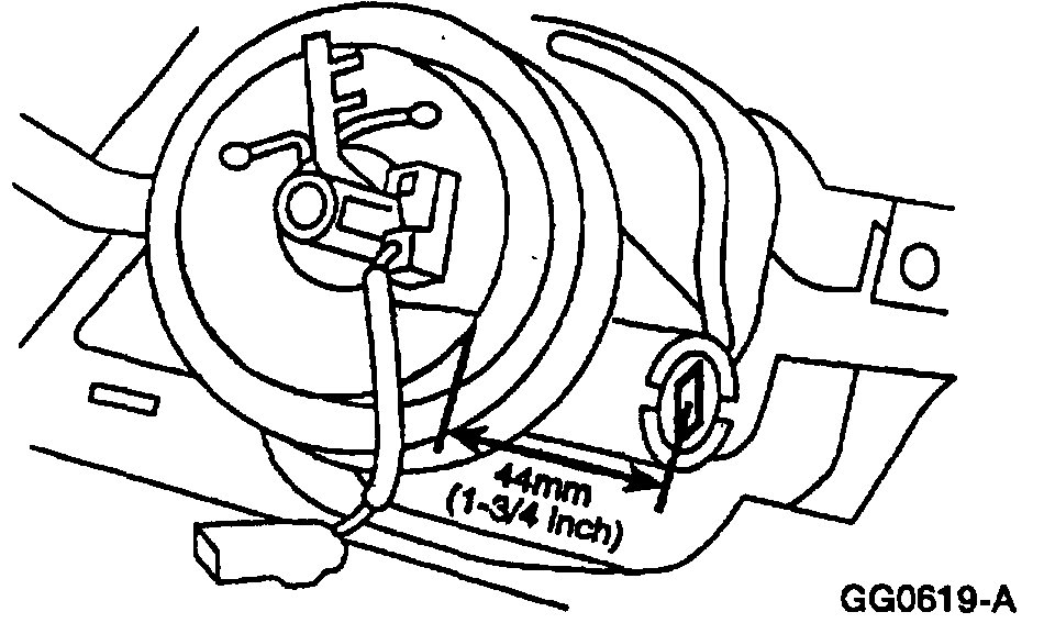

Lost keys so I changed ignition and now won't even turn over.
May 11, 2019 at 1:29 PM
  • 110,240 POSTS
Welcome to 2CarPros.
I want to confirm that it is the key lock cylinder that was replaced. Is that correct? It is commonly referred to as an ignition switch, but in reality, the switch is a separate component. If I am correct and it is the cylinder (since you lost the key), something wasn't put together

1. Disconnect the battery ground cable and wait at least one minute
2. Remove the steering wheel.
picture 1

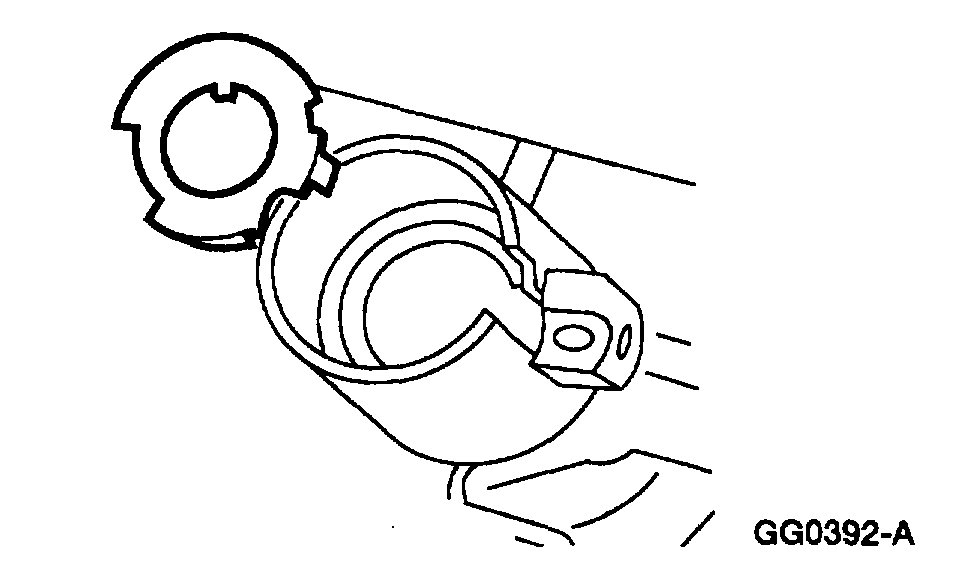

3. Twist off the cap from the ignition switch lock cylinder.
picture 2

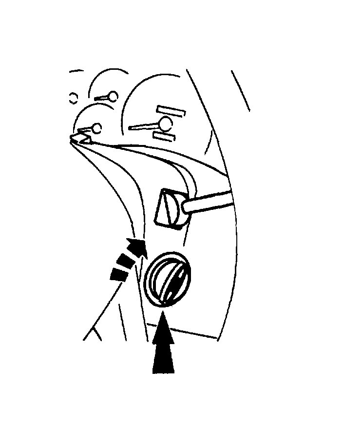

4. Remove the ignition switch lock cylinder.
- Use a 1/8-inch diameter drill bit to drill out the lock cylinder retaining pin.
- Use a 3/8-inch diameter drill to drill down the middle of the ignition lock key slot until the ignition switch lock cylinder breaks loose.
- Remove and discard the ignition switch lock cylinder and drill shavings from the steering column.
picture 3

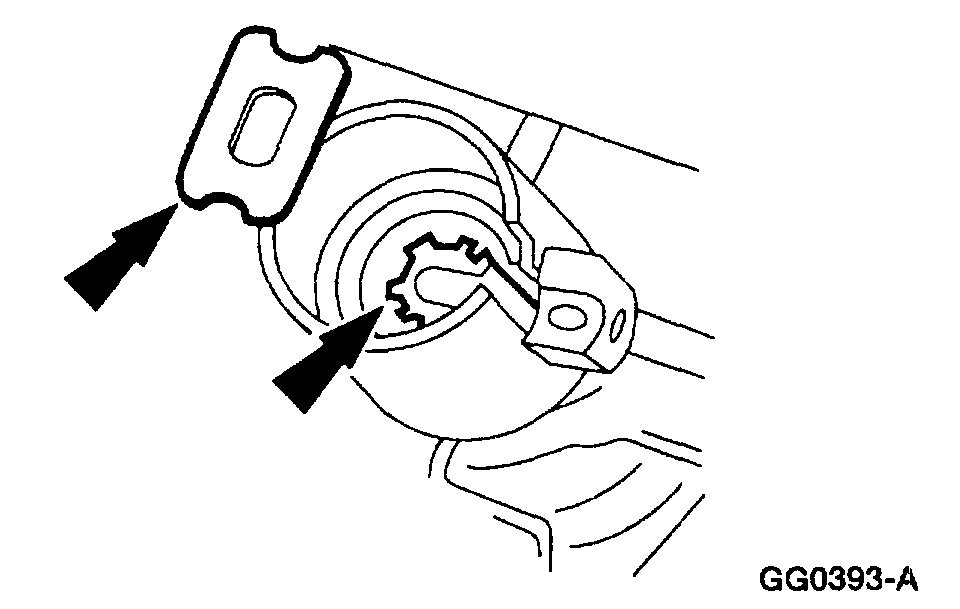

5. Remove the bearing retainer.
picture 4
6. Remove the bearing and the gear.
- Thoroughly clean all drill shavings from the steering column and inspect it for damage.

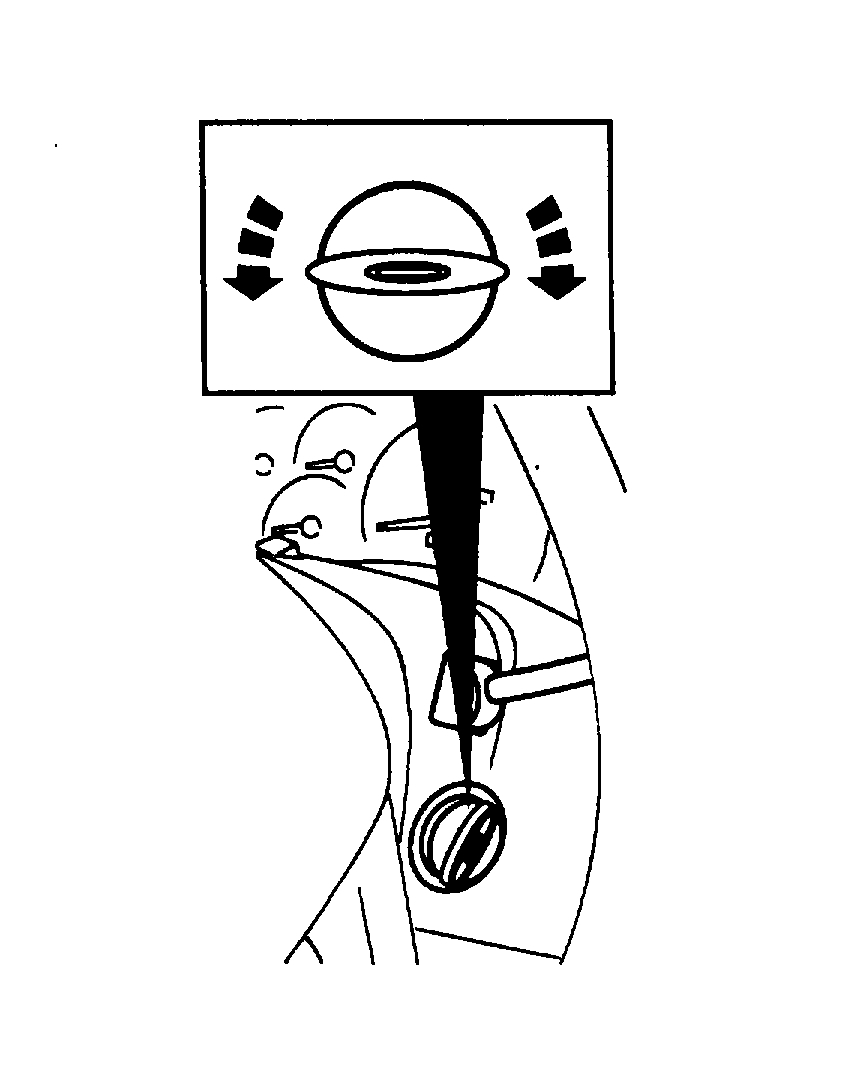

picture 5
1. Note: Use a new ignition switch lock cylinder.
Follow the removal procedure in reverse order.
- Verify ignition switch lock cylinder operation.
My guess is the connection between the cylinder and the switch isn't attached or was incorrectly installed. Let me know if this helps or if you have other questions.
