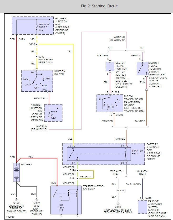

I was recording data with a Actron code reader and while it was recording I replaced a coil wire. When I tried to erase a 305 code the code reader quit picking up a signal. When I tried to start the truck I did not have any power to the truck except for the theft light on the dash flashing. I do get a clicking around the middle of the dash when the key is in the cylinder and open the door. Clicking goes off when I tun the Key. Any ideas?

Try locking and unlocking the truck from outside and check all your fuses with a test light. It sounds like you tripped a theft deterrent.

Thanks, I am going to try a different pcm relay.

Truck was turning over but not firing or getting fuel. Assumed it was anti theft. Tried a reset trick, now it will not crank. Also, anti theft light is blinking fast. Let me add. The anti theft light was flashing fast before trying anything. I do not have a second key. The "trick" was door open, ignition on, disconnect and reconnect the battery. Something I saw online. So, that is the only option? Is it possible that certain shops may have the scan tool? Or dealer only?

I would try a hard system reboot this is done by removing the negative battery cable from the battery and holding it to the positive battery terminal for 1 minute this will discharge the system capacitors.

I would look at all if the fuses and test the starter relay, here are a couple guides and a diagram to hep you do some testing and get the problem fixed.

The system hard reboot worked for me btw.
