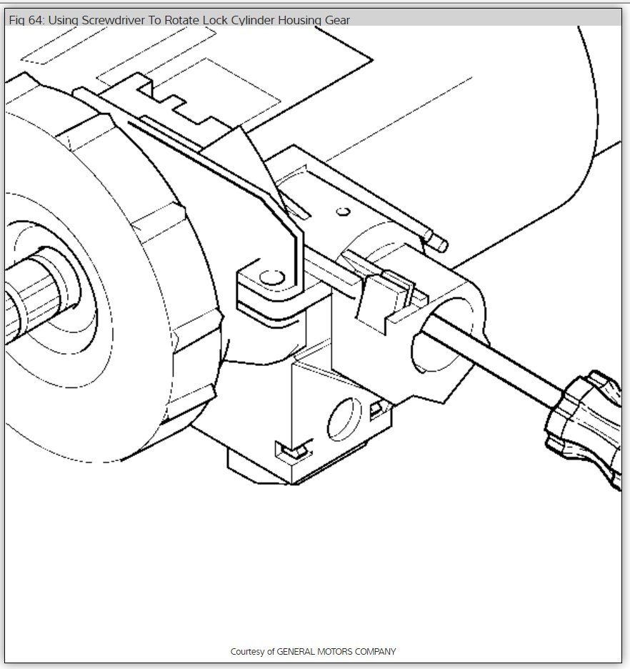

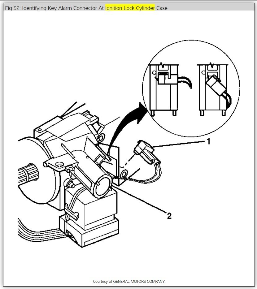

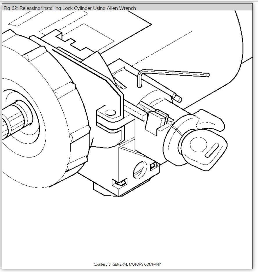

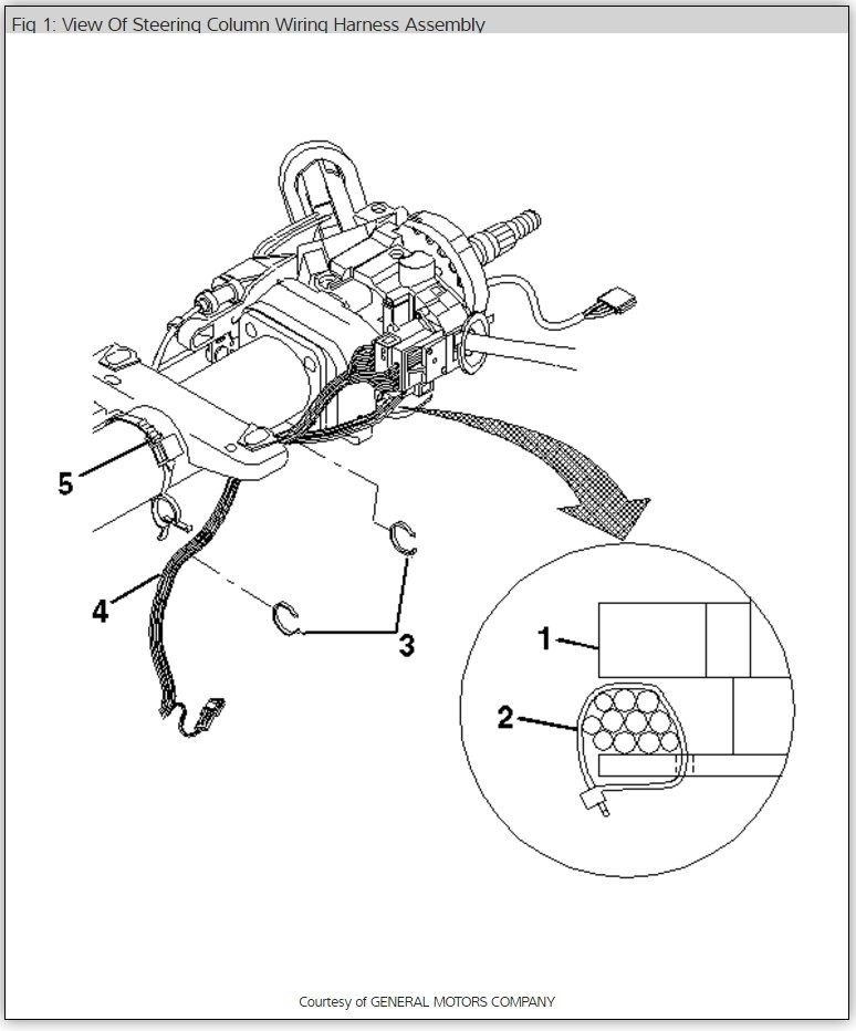

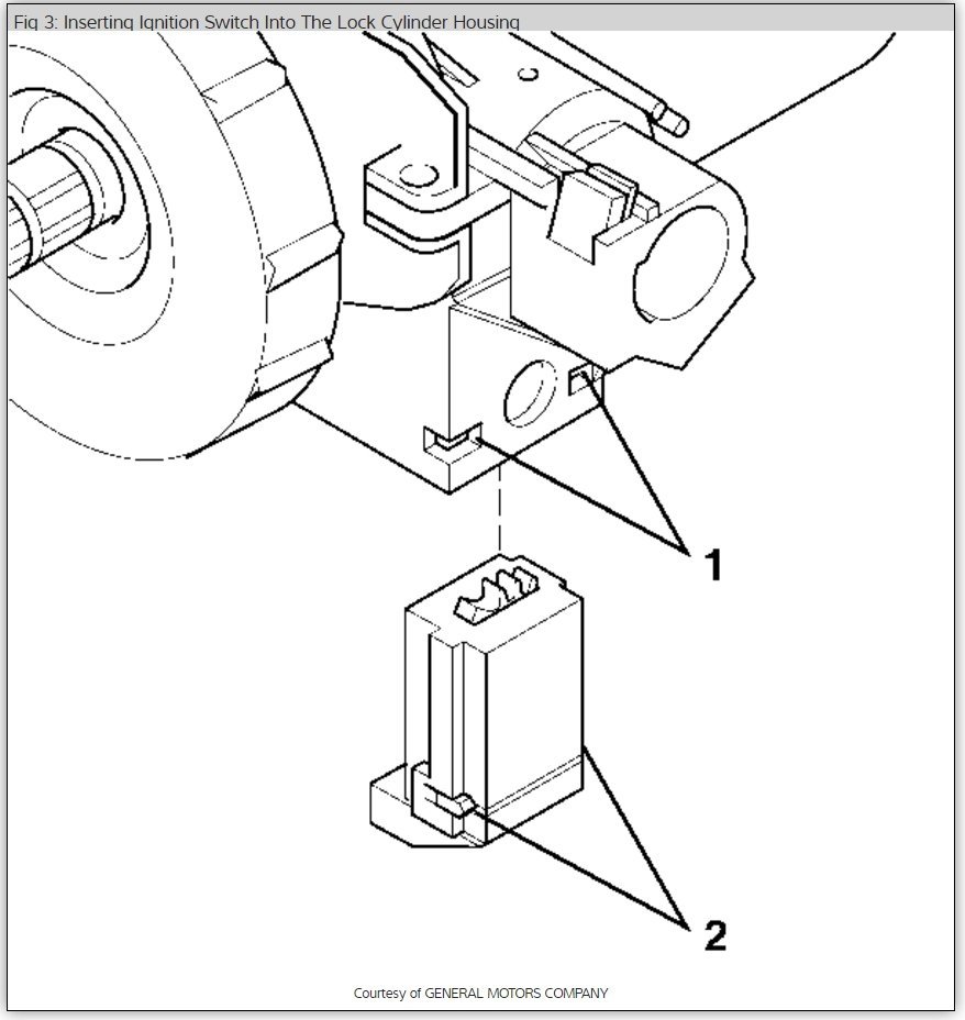

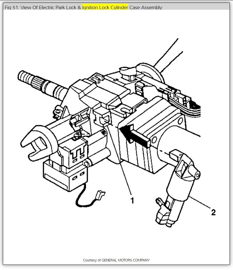

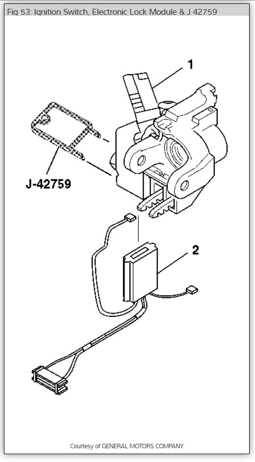

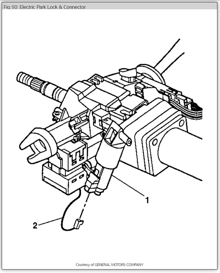

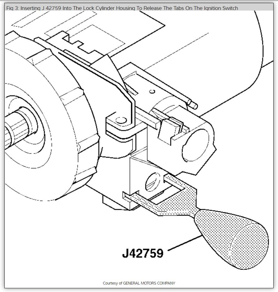

Yes, a new key and tumbler should fix it as long as the key is programmed to the truck, here are the instructions on how to change the key and tumbler out in the images below. Check out the diagrams (below). Let us know what happens and please upload pictures or videos of the problem.
