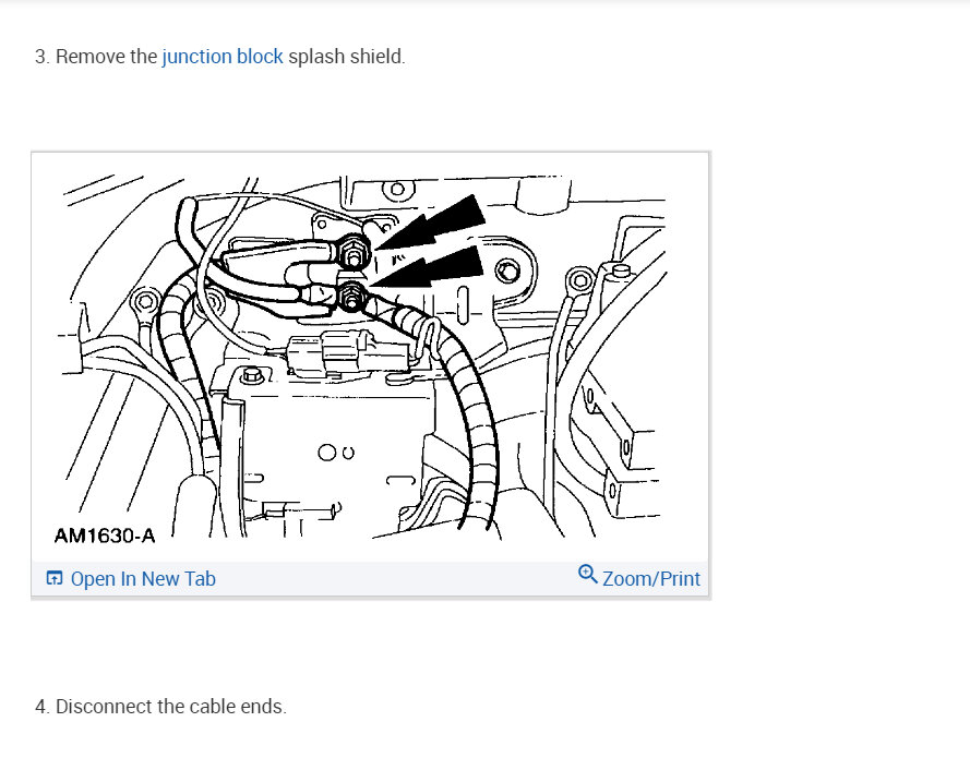

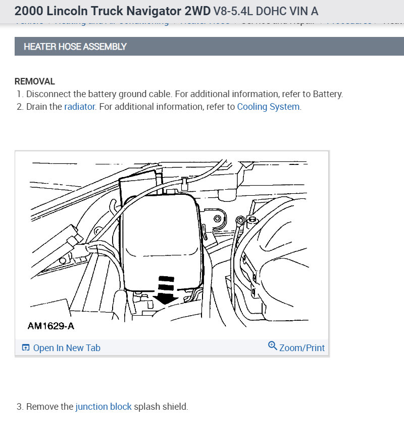

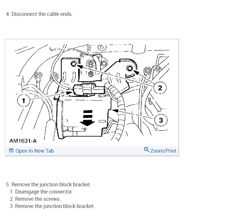

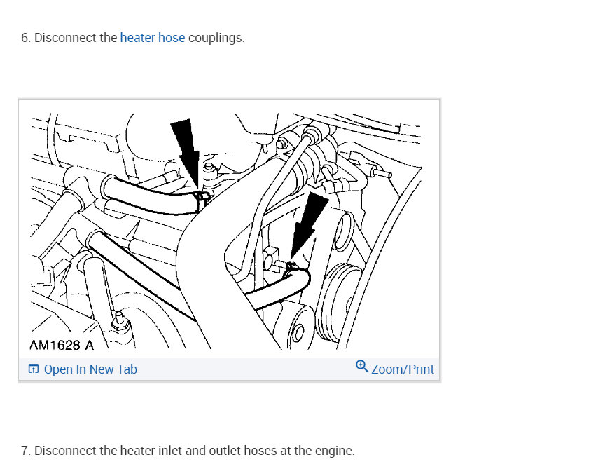

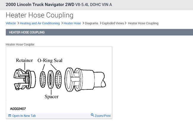

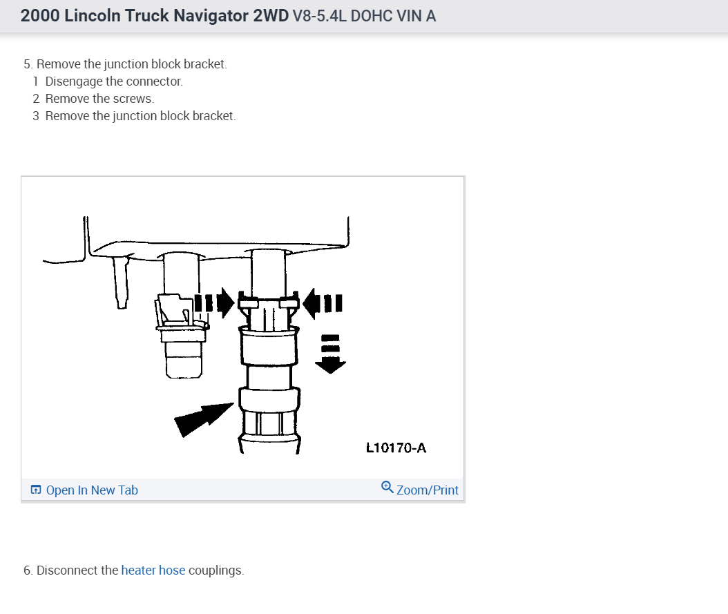

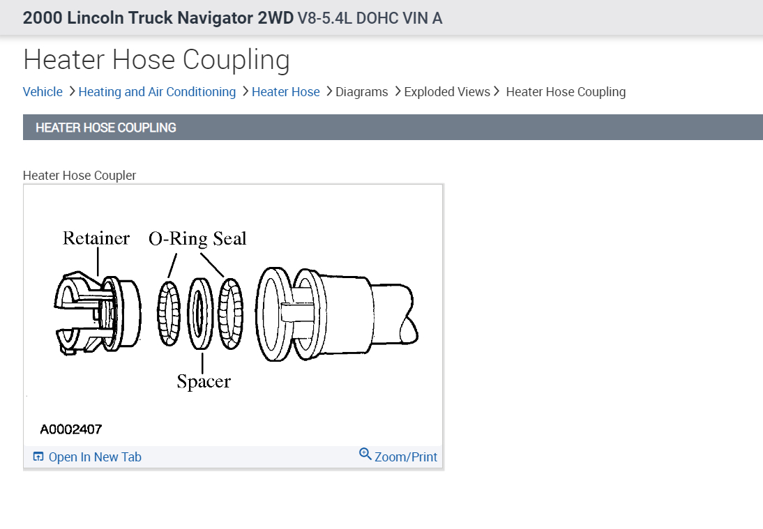

I would just like to know what to do to bypass the front heater core.
May 28, 2023 at 1:27 AM
  • 55,432 POSTS
The best way to bypass the heater core is to remove the heater hoses and cut the ends off and then use a connector with 2 hose clamps and put them together and refill the system.
This guide can help as well:
https://www.2carpros.com/articles/step-by-step-guide-how-to-bypass-an-automotive-heater-core
Please check out the images below for additional help. Check out the images (below). Please let us know if you need anything else to get the problem fixed.
