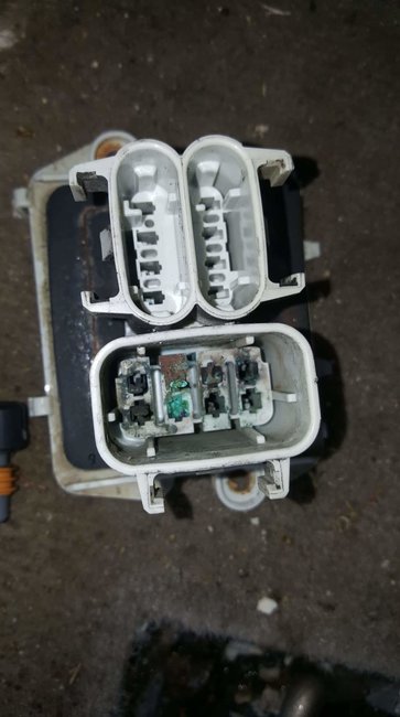

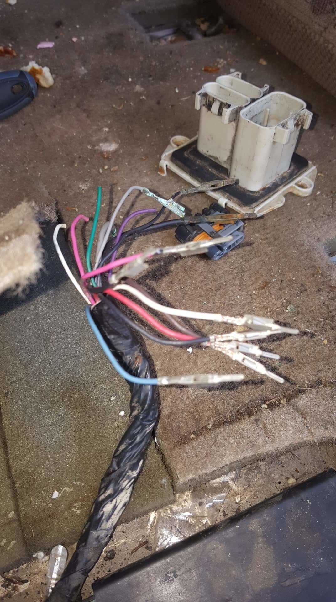

I had a lot of water leakage into the c305 connector pins were corroded Nd snapped off. van had been having a few issues and some told me to check the c305 connector. so I did. I was told I could bypass the connector but do not know which wires connect to which from inside van that was in the c305 connector and ones coming from the 3 wiring harnesses that connected to the c305.

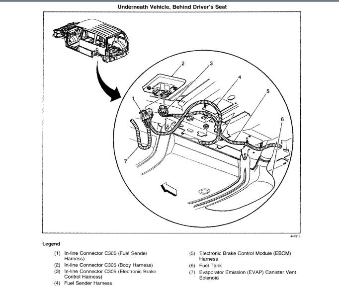

That connector was a very bad design. I have done many of them.
You can buy the connector for a little money but you have to pin it.

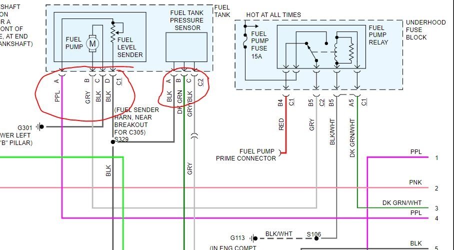

I attached the diagram. I circled the wires that go through that connector. It is for the fuel pump, sender and the fuel pressure sensor.

What are the pink wires? all wires were pulled out of c305 connector there are two pink wires and only one connector coming from under van has a pink wire. there's also a light blue wire.

Can you post some pictures of the wires? The diagram does not show pink wires.

That's the wires on inside.
Feb 11, 2020 at 10:14 PM
What about the other side of the connector? Can you show me that as well?
Feb 12, 2020 at 12:31 AM
KIPP_1992
  • 18 POSTS
Other side of which connector?
Feb 12, 2020 at 12:37 AM
KIPP_1992
  • 18 POSTS
This?
Feb 12, 2020 at 12:39 AM
I need to see the wires you are connecting too.
Feb 12, 2020 at 12:43 AM
KIPP_1992
  • 18 POSTS
And the other plug has 4 wires coming out and 1 blue wire that was in a plug of its own.

You can start by matching up the colors of the wires in that connector to the loose wires.
Start matching up the wires and see if they all are accounted for.

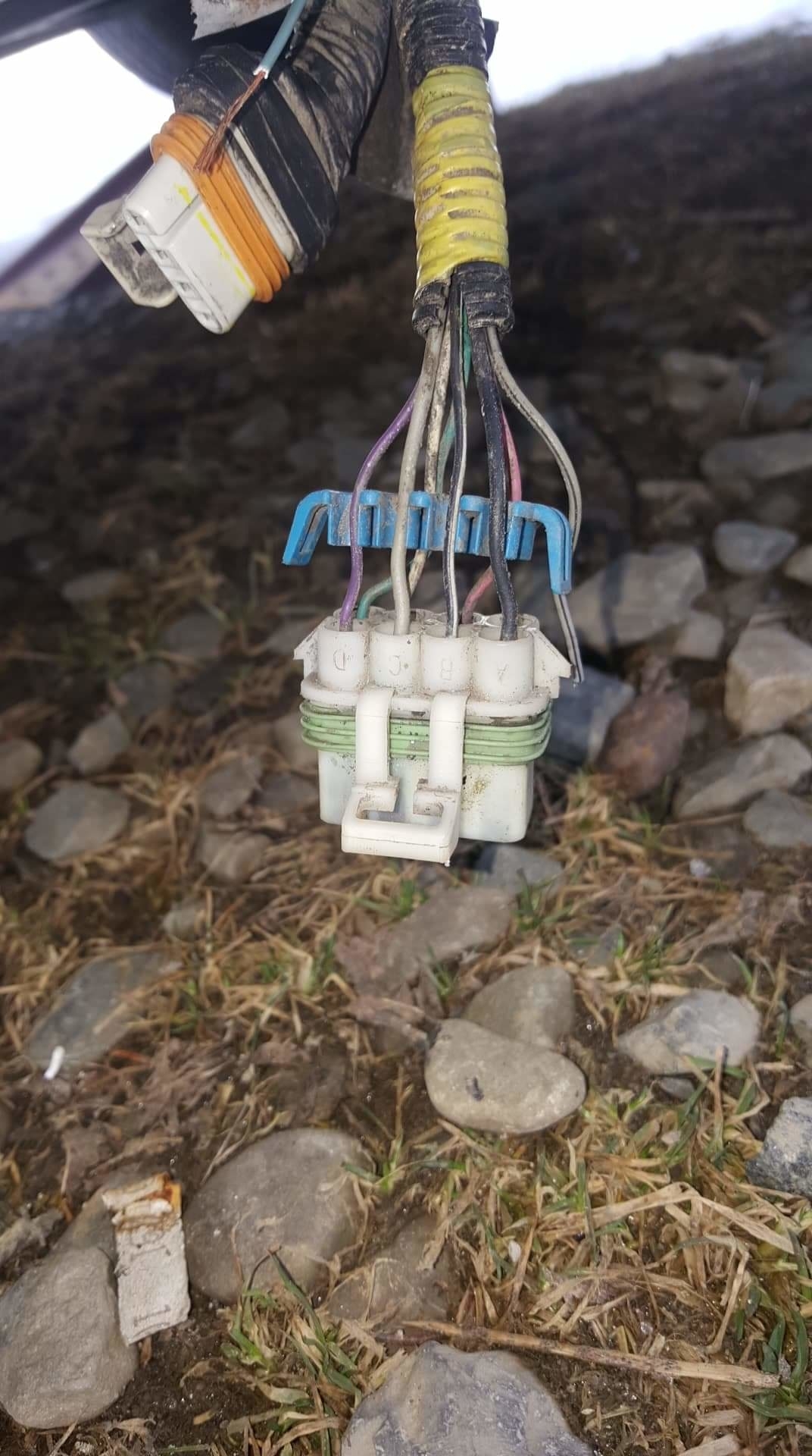

All except on the inside of van there is two wires that don't match up with any on connectors. so I don't know where they connect an extra pink and I think white.
Feb 12, 2020 at 1:09 AM

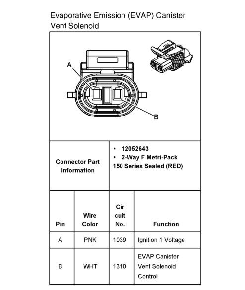

Those wires are for the vent solenoid on the fuel tank.

There was one plug with 4 wires black red white and brown then one with 8 wires and the third little plug only had a light blue wire in it. I'm confused here.

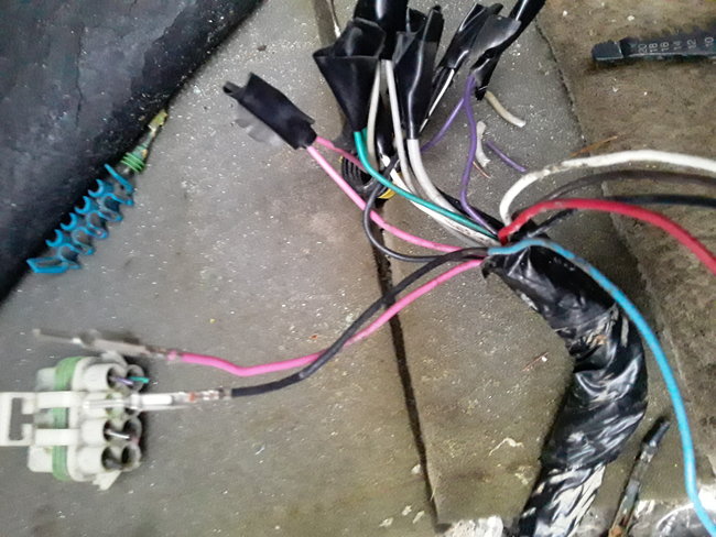

There's two extra in the van than what's coming from the connectors one pink one goes to the big connector under the van, but the other pink one doesn't match up with another wire coming from either connector and I think there is a white on two that doesn't match up to another wire.
Feb 12, 2020 at 1:33 AM
KIPP_1992
  • 18 POSTS
If you look at my first photo I posted there is two pink wires.
Feb 12, 2020 at 1:34 AM
Okay, let us back up.
Match up the ones that match. Take a picture of the remaining ones and let me know. I need to see both the harness inside and outside as well. Tape the wires together, for now, to see what does not match.
Feb 12, 2020 at 1:37 AM

The pink and black ones have no wire to connect to on other connectors,
Feb 12, 2020 at 6:17 AM
KIPP_1992
  • 18 POSTS
All other wires match up with another except those two.
Feb 12, 2020 at 6:21 AM
Good.
Those 2 are for the solenoid I told you about. They go to the vent solenoid.
There should be a 2 wire connector to attach those wires.

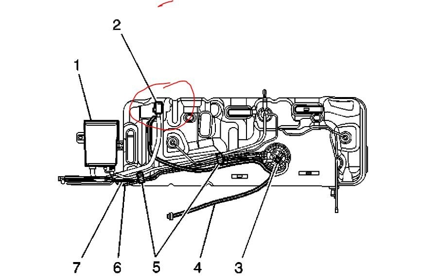

Okay, go to the solenoid. I posted the picture back a few posts. Those wires need to be run to that solenoid.
Feb 12, 2020 at 6:36 AM
KIPP_1992
  • 18 POSTS
There's no wires going from solenoid to where that connector is located and no that I took the connectors off. I have TCS light on and ABS light.

If you have an ohmmeter, ohm the wires from the solenoid to the loose wires and see if you have continuity.
