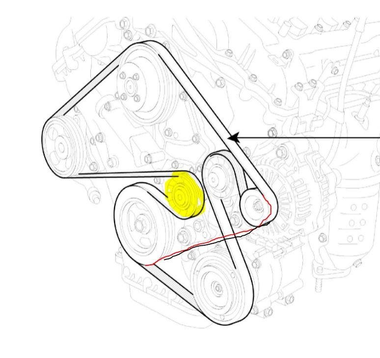

I need to know what size belt would i need to bypass A/C compressor and is there a diagram that you could show me how to do it?

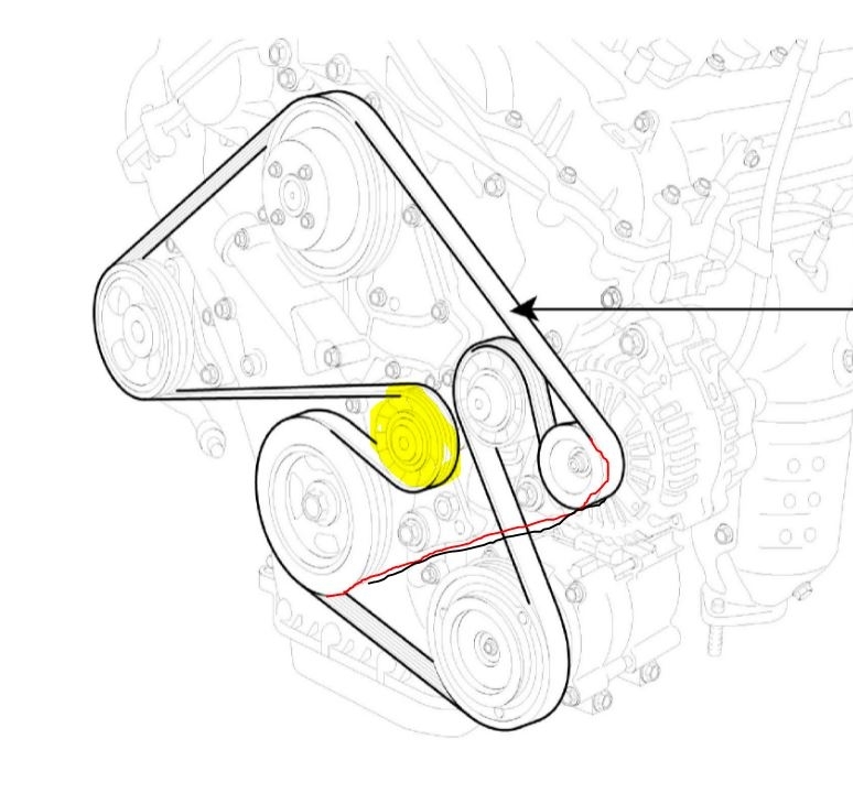

There is no bypass belt listed for them but if you took the old belt and used it to measure the path of the belt where the red line runs and over the rest of the belts path it should be close. What is the issue with the A/C compressor?
